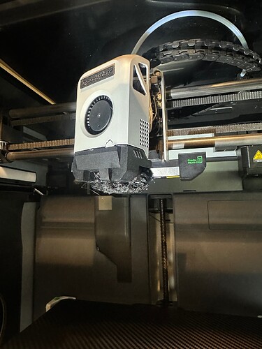

Well, Spaghetti detection failed tremendously on my X1c, causing significant damage to my printhead (unsure what else right now) I’ve opened a ticket and now wait … I was using all my normal custom settings for PETG HF (print Slooooow) and for the first time, it just did not stick to my freshly washed smooth pei plate @ 80 degrees
I use the X1c for my small business, have over 1800 hours printing custom parts on it and never had a significant failure like this. Can I ever trust this to run while I’m sleeping again?
I mean, I cannot even get this apart including the cover, so therefore cannot use my backup hotend I have or print at all. I’m Hard Down ! It is like one large mass of molten lava now.

But judging by the images provided, you gonna have to get a new cover: Front Housing Assembly - X1 Series | Bambu Lab USA Store
And make sure the spare hotend you have includes the fan, header and thermistor. Might be good to get a new spare one too.
Can you provide a picture of the toolhead connector board/toolhead?

I wanted to see the toolhead inside to help you identify any other potential issue that might need another spare part. Something like a ripped of connector.

Here is the inside of my x1c print head , currently:

Good thing is that the toolhead looks good. Last thing to check is that the down facing camera is clean and has no filament sticking to it.
A new front housing assembly and a new hotend assembly should do the trick.

Have you tried a heat gun or hair dryer to soften that filament up? I have had this happen to me, and I was able to soften it up and peel it all off. No permanent damage to print head.
Would say the same, but you can see the front housing has cracked.

You can save the print head but you need a heat gun to soften up the plastic and gently pull it away. There’s small wires in there that might get damaged (if not already) but you can heat-remove-heat-remove, etc.
Also, I run PETG HF for outdoor stuff too and it does like to get sticky when it picks up moisture. If a curl reconnects with the extruder it can do a lava tube of sorts and pump molten plastic back up around and into the extruder.
I also run the smooth PEI plate but use glue stick. That only helps with plate adhesion though. If you’re getting stringing, lifting at corners, and curly extrusions, you may need to dry your filament more thoroughly.
It will be tedious to decase the extruder but you should be able to clean it all up with a bit of work.
