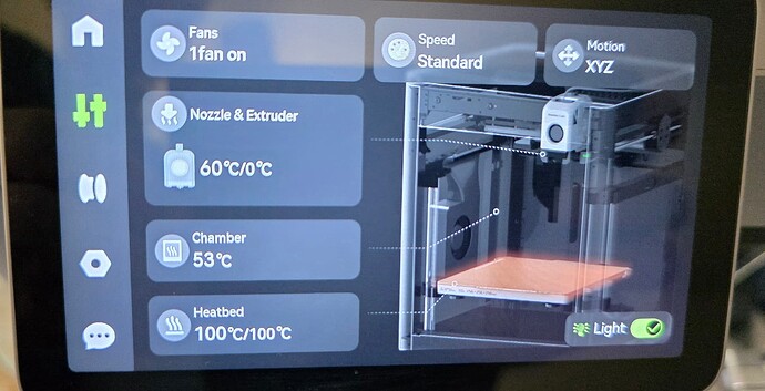

I guess I’ve never paid attention before. Its off by 7c @ 60c. The Nozzle temp is accurate though. This is with the bed down. Anybody know where its located? It also did a weird thing where it jumped from 50c to 53c
The X series chamber temp sensor is located on the top button pcb so I would expect it to read a little low.
Thanks Jon. I’ve never looked. I wonder if I can move it.
Thanks again.
Moving it might help. It’s not like anyone actually uses those buttons lol.
small jump in a temp reading could be related to a change in air flow around the sensor ?
bigger jump would rather be a problem in reference voltage of the sensor (power supply, connector…)
