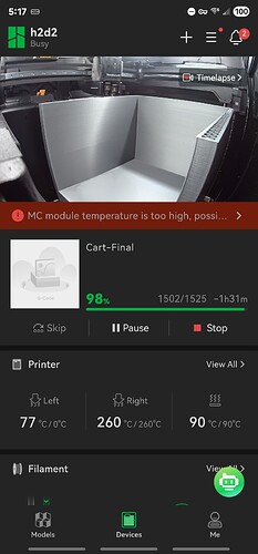

Been searching around I’m not seeing this error mentioned. I’ve seen this pop up randomly and now it’s happened three times so far two hours into a 4 hour print.
Print is single color Bambu ABS. At random times I see the H2D has the error chamber temperature malfunction {0300-8018-192827] and my chamber temp is set to 0. I set the chamber back to 65 and restart the print and it goes for a while and then the error pops up again for no reason that I can tell.
Anyone seen this one before?

Mine is throwing the mc error again. Looks like it happens consistently with large parts approaching max height
It says MC module temperature is too high,
HMS_0300-A200-0001-0001: MC module temperature is too high, possibly because of high chamber temperature of the printer. You can try lowering the environmental temperature before use. | Bambu Lab Wiki.
Guess your environment temperature is quite high? Or maybe a cooling defficiency.
Its in an air conditioned garage thats 83f.
It’s consistently happening on big abs prints hitting max height. I’ll try to find in the future if the parts are effecting chamber air circulation.

After examining the machine i have a theory.
Once the heatbed creeps below the internal heater, if a part is directly infront of it; hot air can be blown in the cavity that the rear lead screws exist in, this in turn gets the area where the MC sits slightly hotter then the rest of the interior and throws the error.

Here’s a screenshot of when this just happened again today. As can be seen, the chamber temp is suddenly sent to 0
Edit: Actually, after resuming I was watching the print and it malfunctioned again. The temp is set to 0 after the malfunction, not as part of it or a cause of it. I guess I’ll see what Bambu says.

Yeah, they wanted me to do some testing that made no sense really. After some questions back and forth they sent me a whole new heater assembly. Took a bit of work to replace but not it’s been working fine and holding temps.
