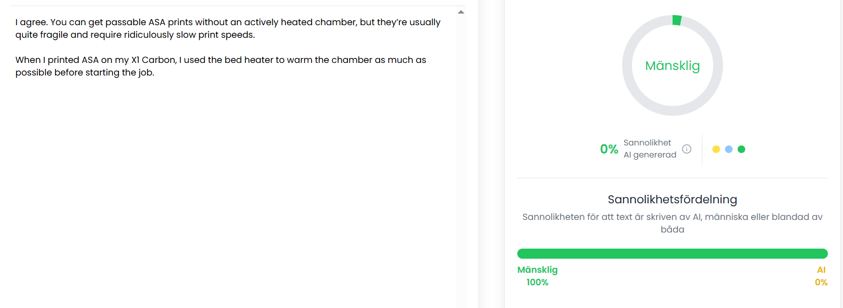

I agree. You can get passable ASA prints without an actively heated chamber, but they’re usually fragile and demand ridiculously slow print speeds.
When I printed ASA on my X1 Carbon, I used the bed heater to pre-warm the chamber as much as possible before starting the job.
And for anyone tempted to claim this is AI-generated: I’ve attached the image. Clear, precise writing can come from humans, too. :wink:
