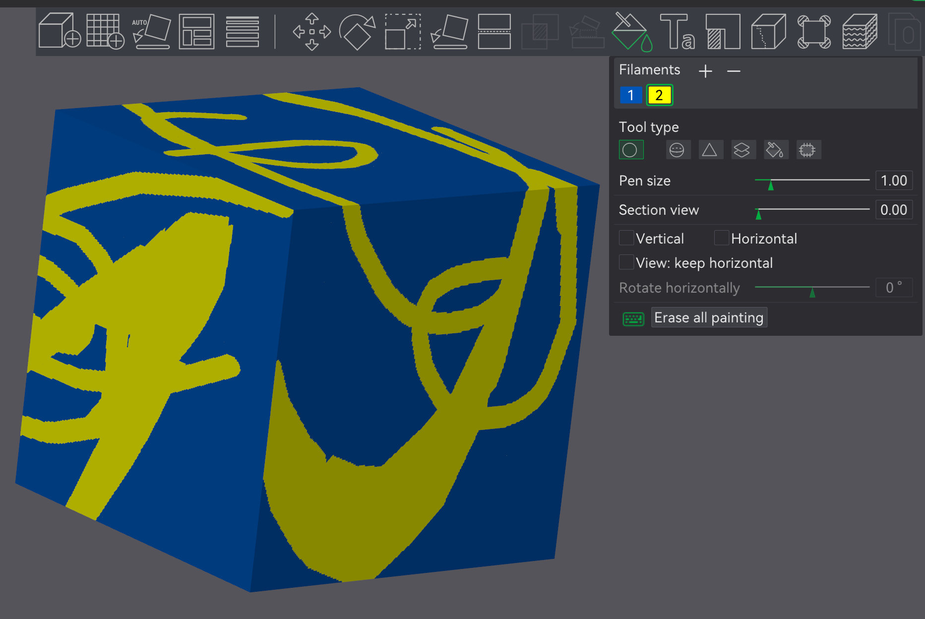

Hi. I have an object where I had set up filament changes,but once I started painting other areas, those filament changes were erased and Bambu studio does not allow me to set any filament change.
Is this the right behaviour of bambu studio? Why can’t I have a lower section have some filament changes and something above it be painted? It seems a very strict limitation.

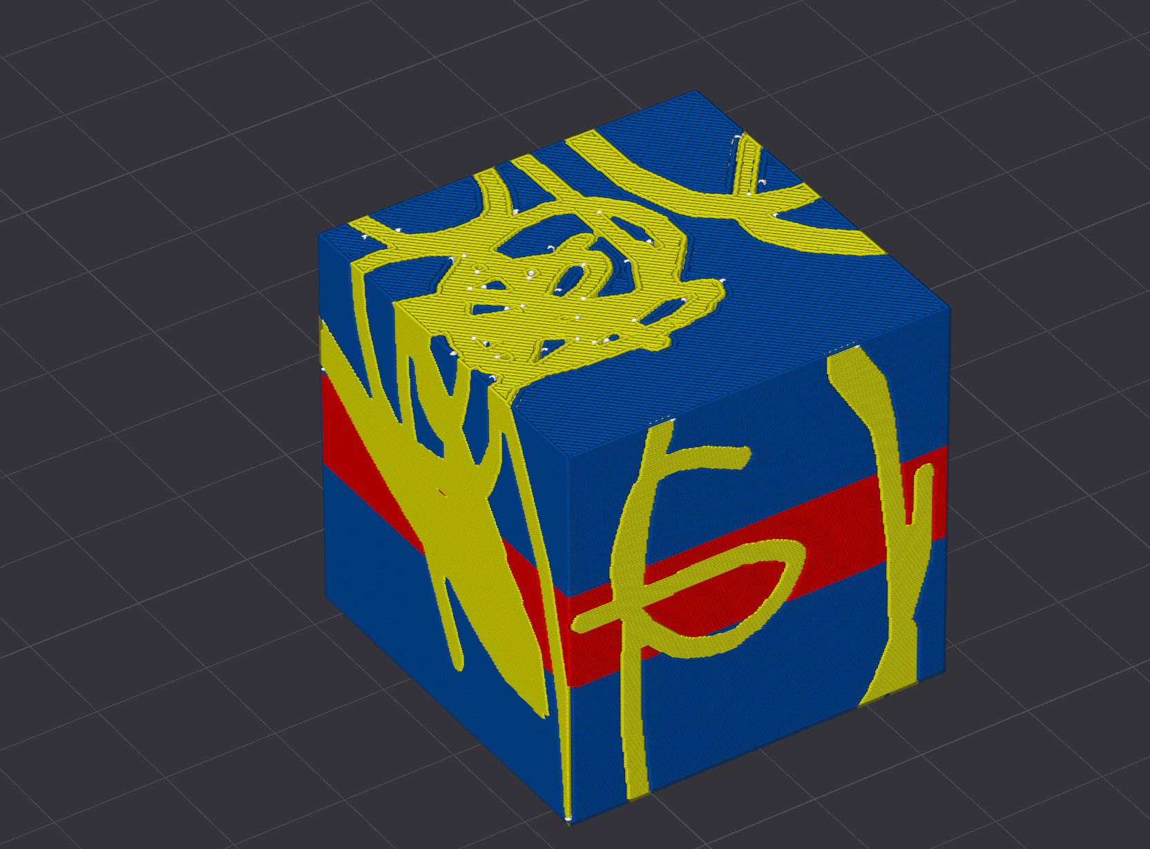

Maybe you should post a few screenshots to show exactly what you mean. In theory, that’s not a problem - take a look: A filament was changed from gray to blue without overwriting the painting.

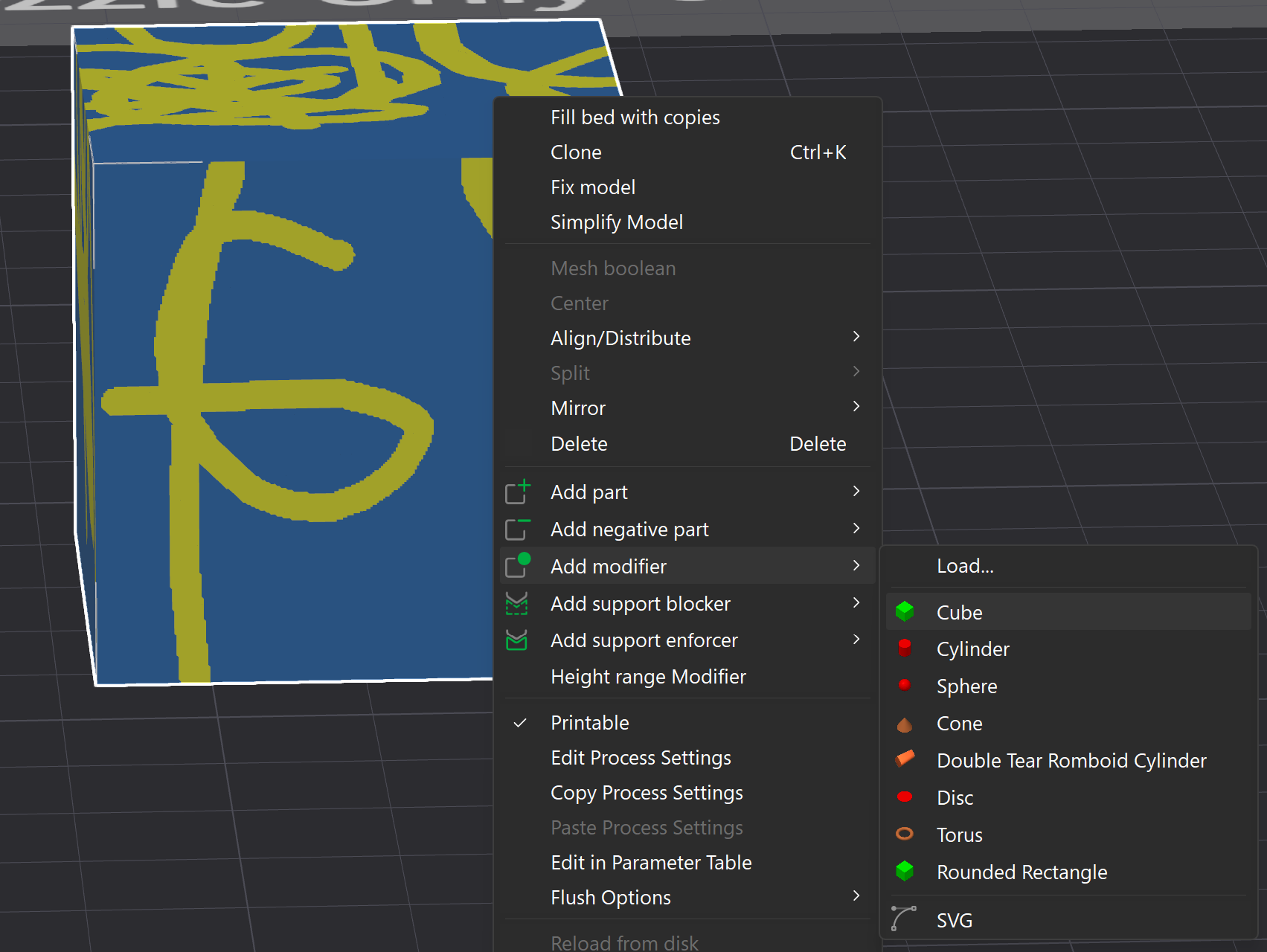

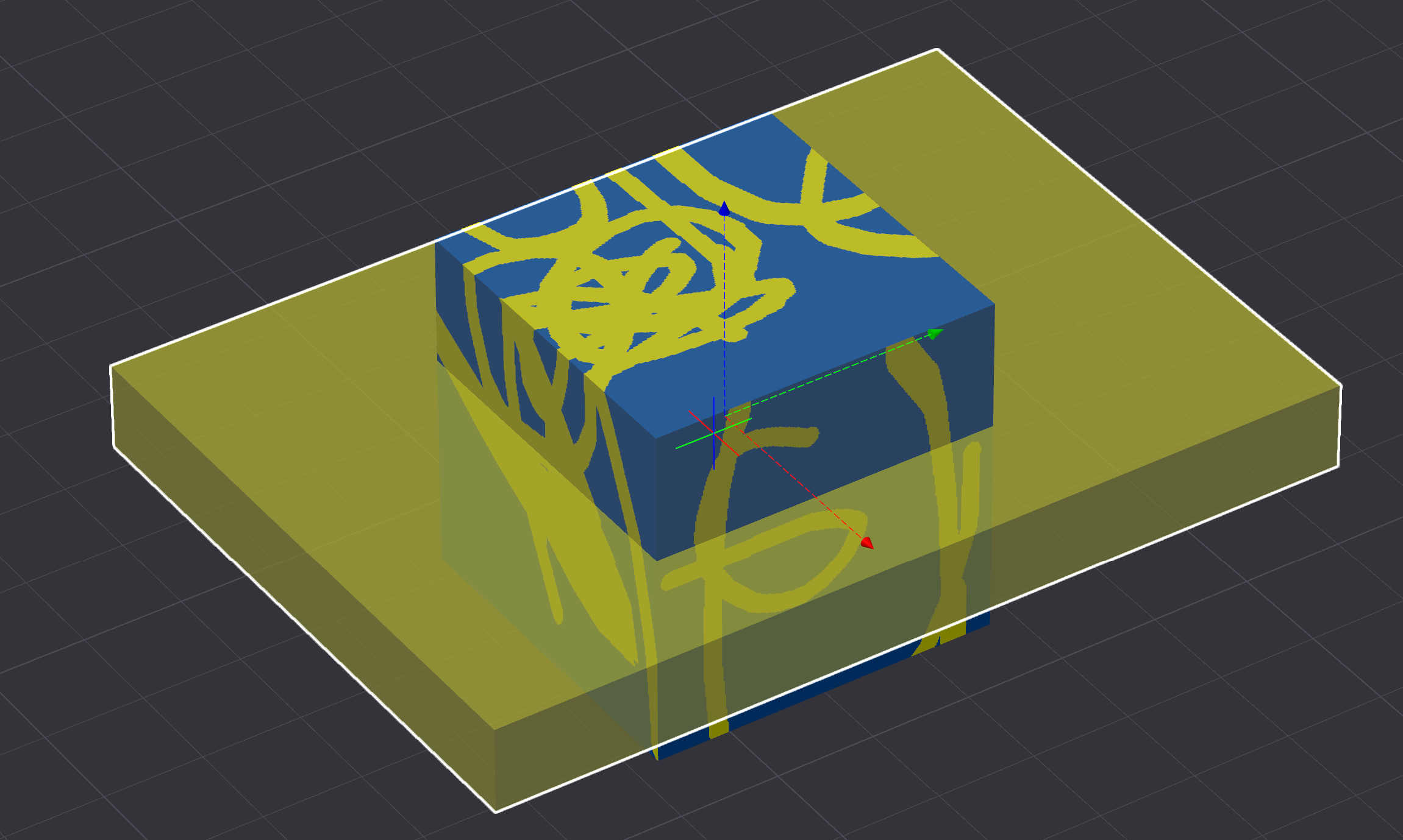

You can also use modifier cubes if you’re specifically interested in subsections of filament change: Here, for example, is a modifier that says: Make this red, but keep the paint intact.
