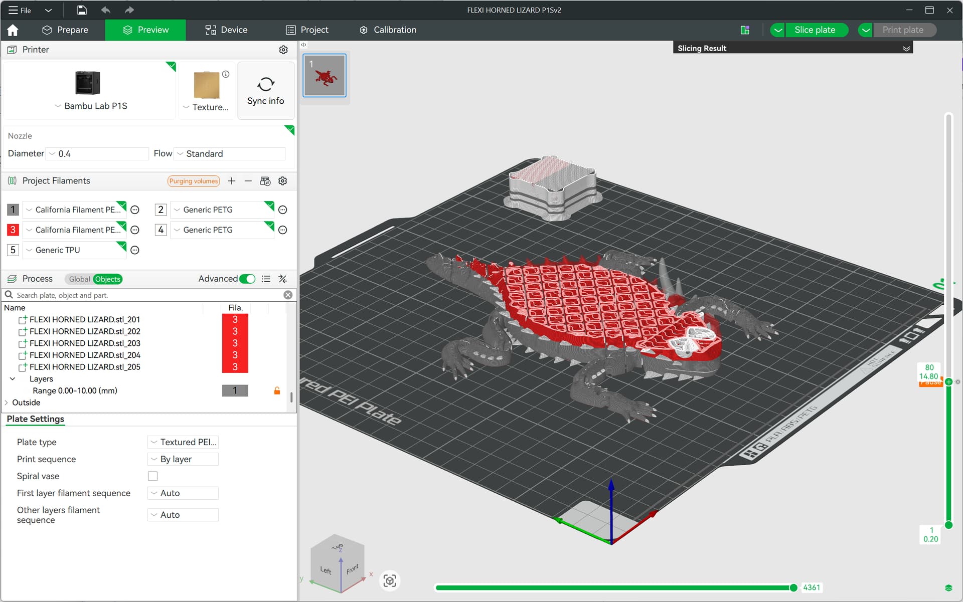

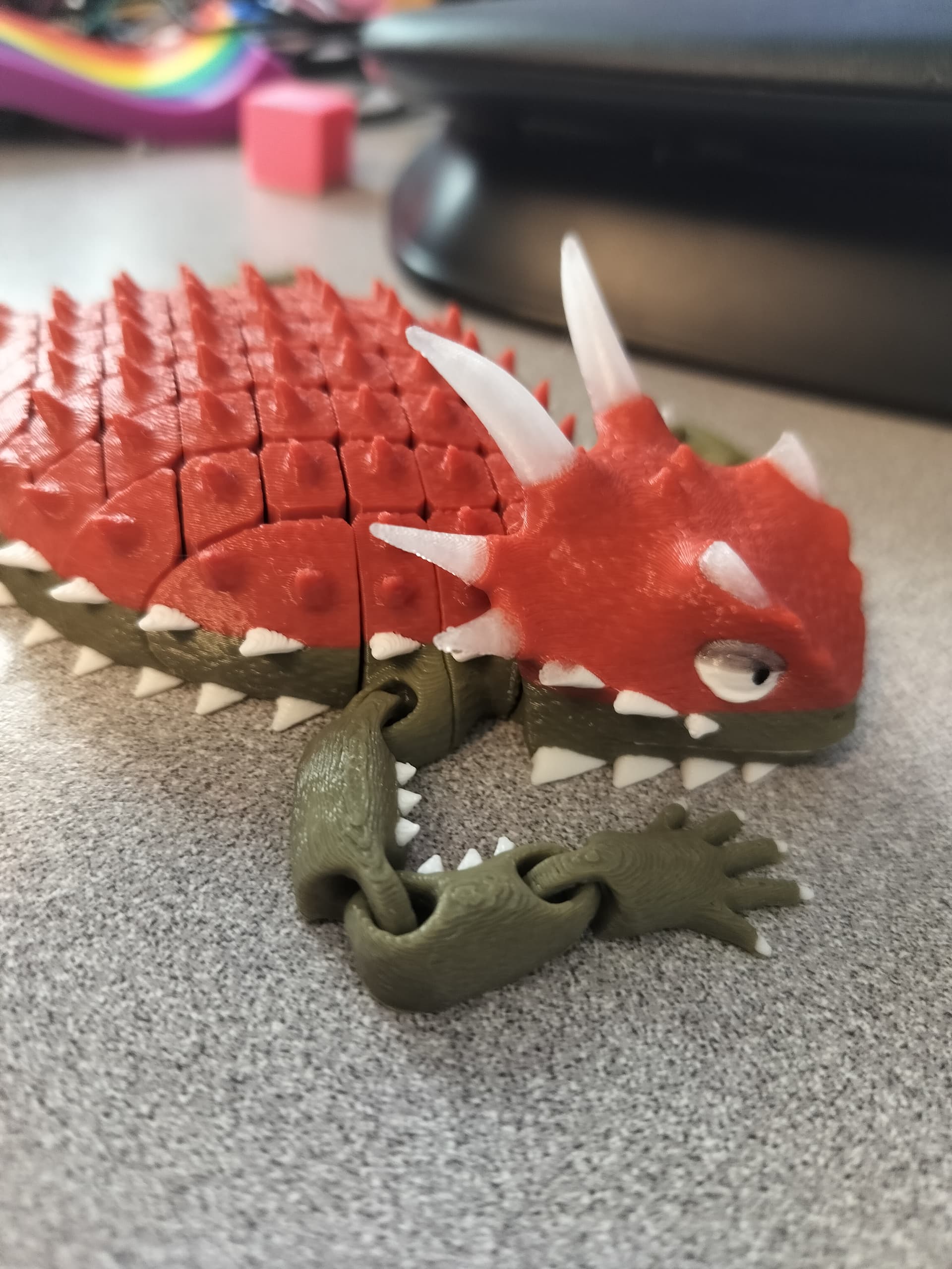

I have a 3mf model that uses 3 colors. One of those colors is due to me using a “Layers” command in Bambu Studio. Now, I accidentally ran out of white once during a print, and swapped in “transparent white” instead, and I really like the effect.
Since I’m only using 3 colors in the AMS, it seems like I should be able to have studio swap “white” in AMS slot 2 for “transparent white” in slot 4. Currently I’m manually inserting a “pause” at the correct layer, and swapping the filament manually. The “change filament” command is grayed out in the UI, but I’m not sure that would work anyway. How do you tell studio that you want to swap slot 2 for slot 4, and not slot 3??? I guess I’m not sure how a 3mf keeps different parts of the model different colors…
