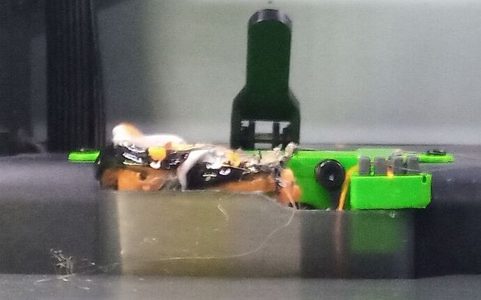

since I started using my new to me X1c, I discovered the various troubles listed here , mostly when printing PETG with 0.4 nozzle
I tried most of the fixes suggested here : various nozzle wipers (curently using the nozzle wipper V3), aluminium tape in the chute, but still got filament balls jumping on the build plate instead of falling through the chute.
I’ve already replaced the head rear cover, after noticing that the purged filament was not shaped in tight coils as before (the cause was clear when looking at the missing part from the head rear cover )

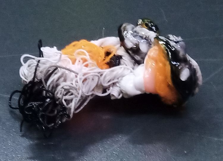

I usually print 1 or 2 colors prints, but had a try at a 4 colors miniature, wich stopped because of a massive clog at the top of the chute, blocking the head :grimacing:
moving the head away , I was able to remove the said blob :
showing that keeping the hot end next to it melted the filament in a solid mess
The chute was indeed blocked by the amount of purge, which I could not see as it was 2 inches above the bin

I fitted some alumium tape (I had a roll at hand)
the metal flap could be another step, but would need to remove the nozzle cleaner which is visible on the first picture.

thanks for the pointers : I ordered and fitted the metal flap : nicely made, but a bit of trouble to install, as it needs to remove the back plate and the chute : the 3rd screw is almost impossible to reach
I also ordered and fitted some replacement BiQ (?) silicone brush, easy fit while the chute was out
the printer is all back together, and the first test print seems to be fine : I’ll see in the long run if the cloging risk is now gone
