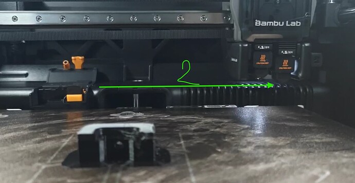

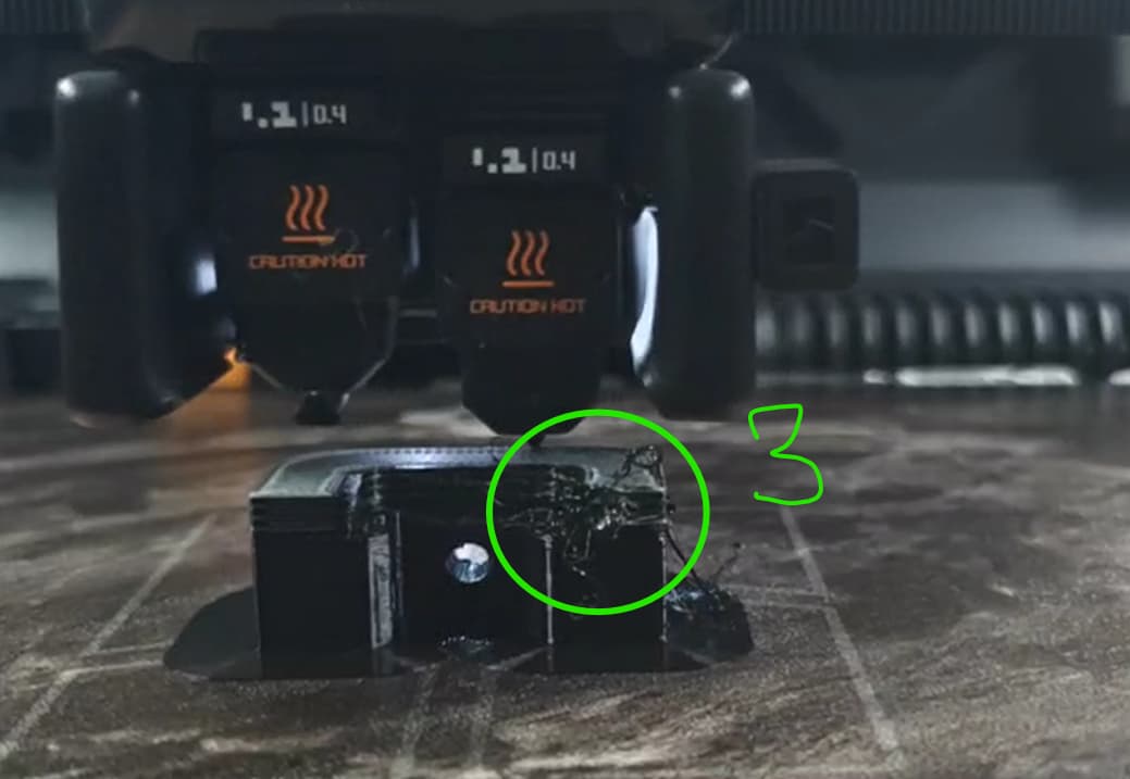

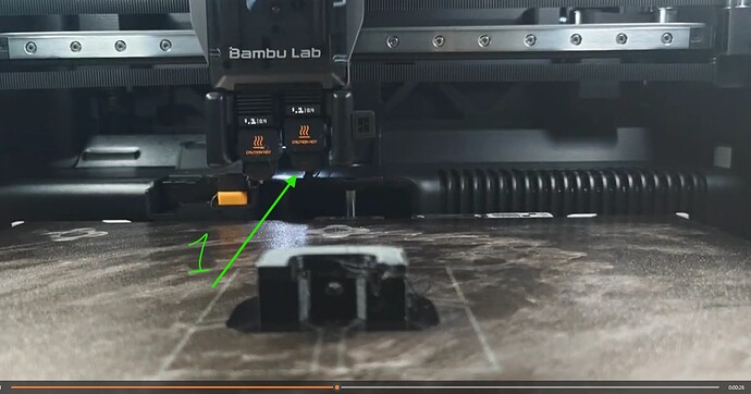

I would ask Bambu, is it possible to add a nozzle cleaning step between changing them?
I’ll describe the current steps of printing two different filaments:
I have the same problem, I would like to have the possibility to change how the nozzels are switched, when they wipe the silicon pad or when and where to switch nozzels directly for small features to save time and material
Are you using a prime tower?
Seems you are printing with 2 different materials.
No, this case is without a prime tower.
Then use a prime tower, and the problem will be solved.
In most cases, a prime tower is necessary when printing with multiple filaments. Simply cleaning isn’t enough to fix the pressure buildup in the nozzle, which needs time to restore after being idle.
As @L0rdS474n already mentioned, enable the prime tower.
The filament in the inactive nozzle also degrades slowly while it sits idle under a high temperature. An additional reason for a prime tower.
The question is printing without a prime tower. When it is necessary.
When you only print a single filament :wink:
As many said, enable prime tower.
