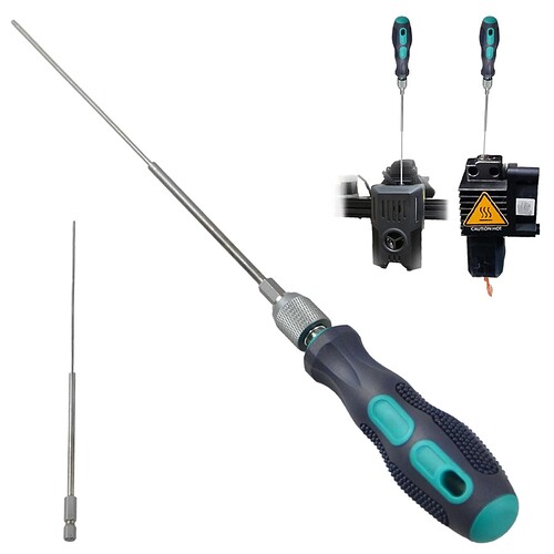

I know about the cold pull method for cleaning clogged nozzles, but I recently saw a post where that wasn’t working. Is a Clog Poke worth having on hand, and has anyone used a Clog Poke on an H2 before?
Amazon.com: Clog Poke 3D Printer Accessories, Φ1.7mm L200mm Prolong Throat Piercing Needle Tool for Any 1.75mm Nozzles, 3D Printer Nozzle Cleaning Kit, Removable Needle, Reuse The Handle : Industrial & Scientific
The H2S comes with one. Its the tiny wire in a tube in the accessory box. I believe the one it comes with is .4 mm. I have used them on other printers, haven’t had to on my H2S yet. It works, but not the easiest thing to do with a hot nozzle.
I got one of those with my H2C. The end of this tool is 1.7mm and designed to force the clog through the nozzle without actually going through the tip. I just don’t know if it would mess up the extruder gear.

I definitely wouldn’t push this tool through the extruder. You might damage more than just a nozzle then.

Thats the poker I use. Works great when you have a tpu clog all the way up to the cold section of the nozzle. The tiny needles they give you are useless against these clogs
And you don’t see any damage on or interference from the extruder gear?
That would be nice. I had an ABS clog on the left side of my H2C yesterday. The little poker that came with the machine didn’t work so, I tried something new. This may help specifically for left side clogs only. I removed the Dual Extruder Filament Guide and left the nozzle in place. I told the machine too heat the nozzle to 280C. The cutter left about 3mm of filament sticking out of the nozzle so, I was able to grab that with some needle-nose plyers and carefully remove it. I then grabbed a fresh length of filament with the plyers and pushed it into the nozzle, bypassing the extruder, using the space left by the Filament Guide. Burnt filament eventually came out followed by the new. I thought that this did a good job of clearing the clog, keep your fingers away from the hot stuff and don’t beat the extruder back and forth with the plyers.
No. Been using them on printers for a long time. Maybe on non hardened gears, it could possibly be a problem. I mean, we feed rough carbon fiber through them for 1000’s of hours. Im not sure ive ever seen anybody post a Pic of worn out gears.
First, I use the printer to feed the poker in. when it stops, I shut the printer off, turn it back on, heat the nozzle and push. If the motors arent energized, the gears will roll. Really bad clogs that would require alot of pressure, I just remove the nozzle from the printer and hit it with torch while pushing.
Nope, don’t do this when a hotend is on the printer. You can’t even get to the hotend without first having to go through the extruder gear.
I use this technique, but only when a nozzle is off the printer.
