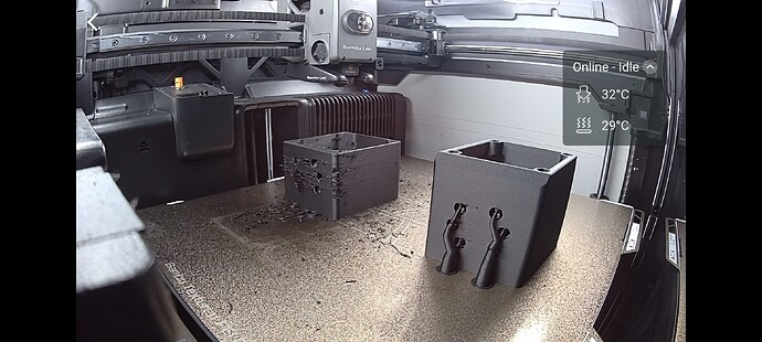

Was searching the forum for solutions for issues with PETG-CF clogging and piling up on the Nozzle of my H2S. I found some posts, but many are older, and there are a lot of suggestions, but no one seems to have fund the perfect solution.
When i first got the printer, I able to print 9 of the parts with no issue, even without support, but then one day the material clogged up on the nozzle and destroyed the print.
I made a full calibration on the printer, put in a brand new 0,4mm hardened steel nozzle. Made all the flow tests on the material, so it should adjusted perfectly. Dried the filament for 8H in the HT AMS.
Then I tried to print just 2 parts with “print by object” and support.

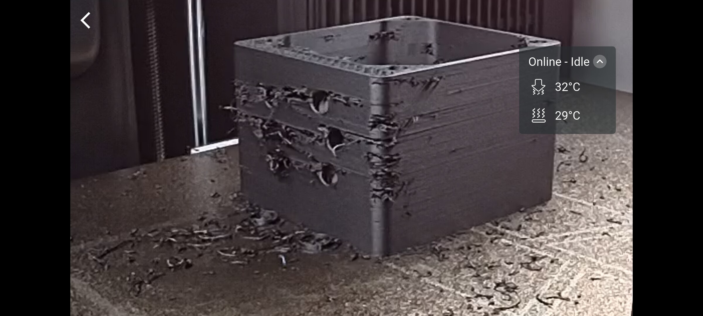

First one turned out okay, but second one is completely destroyed.
Has anyone found the perfect settings or solution for this?

Issue is the other side of the part, that is not visible here in the pictures.
The part has an emboss of the customers company logo and name. Therefore it is necessary to print with 0,4mm nozzle and 0,16mm layer height, to meet the customers expectation.
What I don’t understand, is that I could print 9 of them at the same time before with no issues at all, and now I can’t even make 2, even if I make every effort to make sure that everything is 100%.

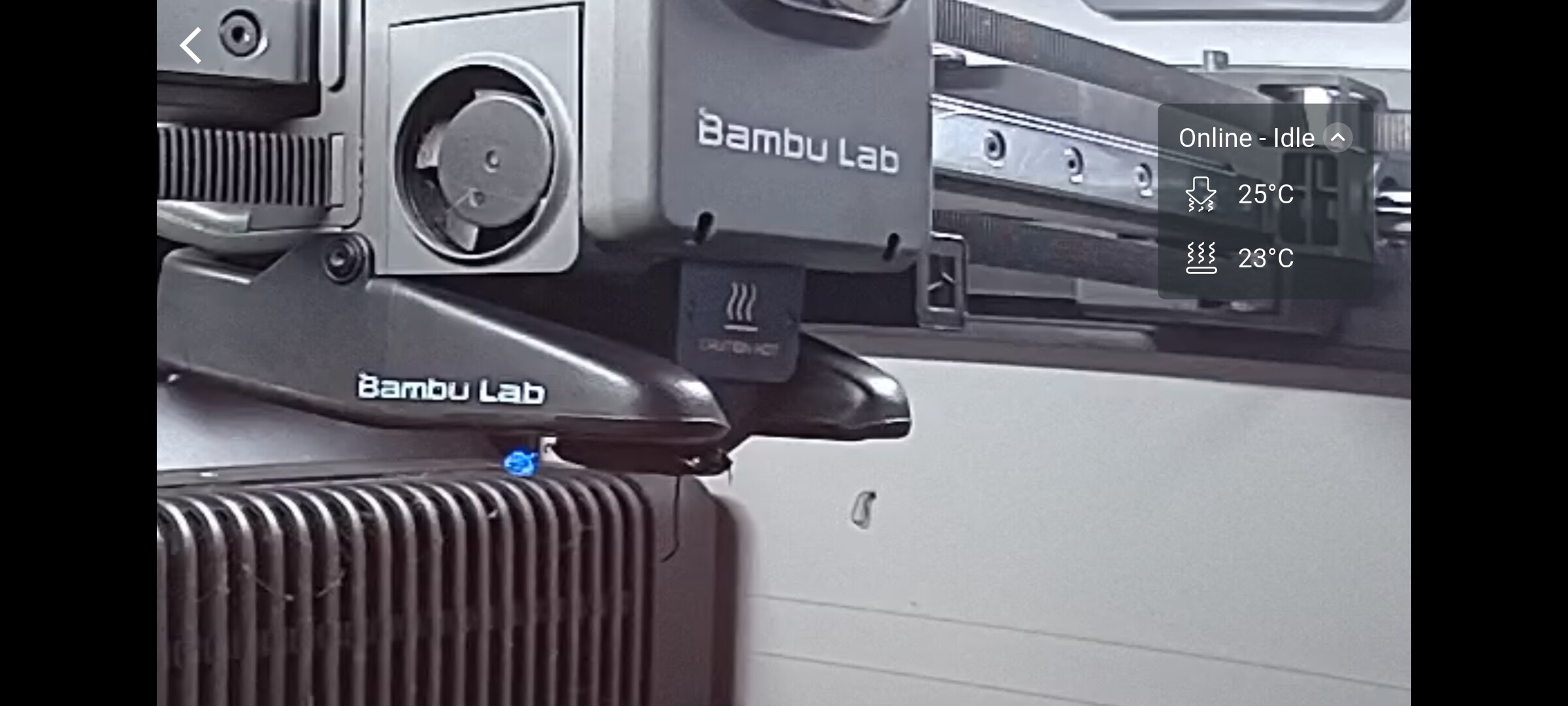

It never clogged up the flow trough the nozzle. Just build up all the way around it and inside the silicone sock.
I did the flow rate calibration in Bambu studio after drying the filament, to rule out over extruding.
those things seem failed supports to me
Base of the support is still adhered to the print plate. I think the big blob of filament sags when the nozzle is not over the part, and knocked the support over and also damaged the print.
The 4 on the first pictures were printet without support.

that’s not clogging and that’s just very normal for petg-cf if you don’t pay a lot of attention to prevent nozzle clumping.

If you use the AMS, the filament is cut then pulled backup. So a piece stays inside the nozzle and if there is a fiber stuck, it will stay there. Only a collpull can get it out.
