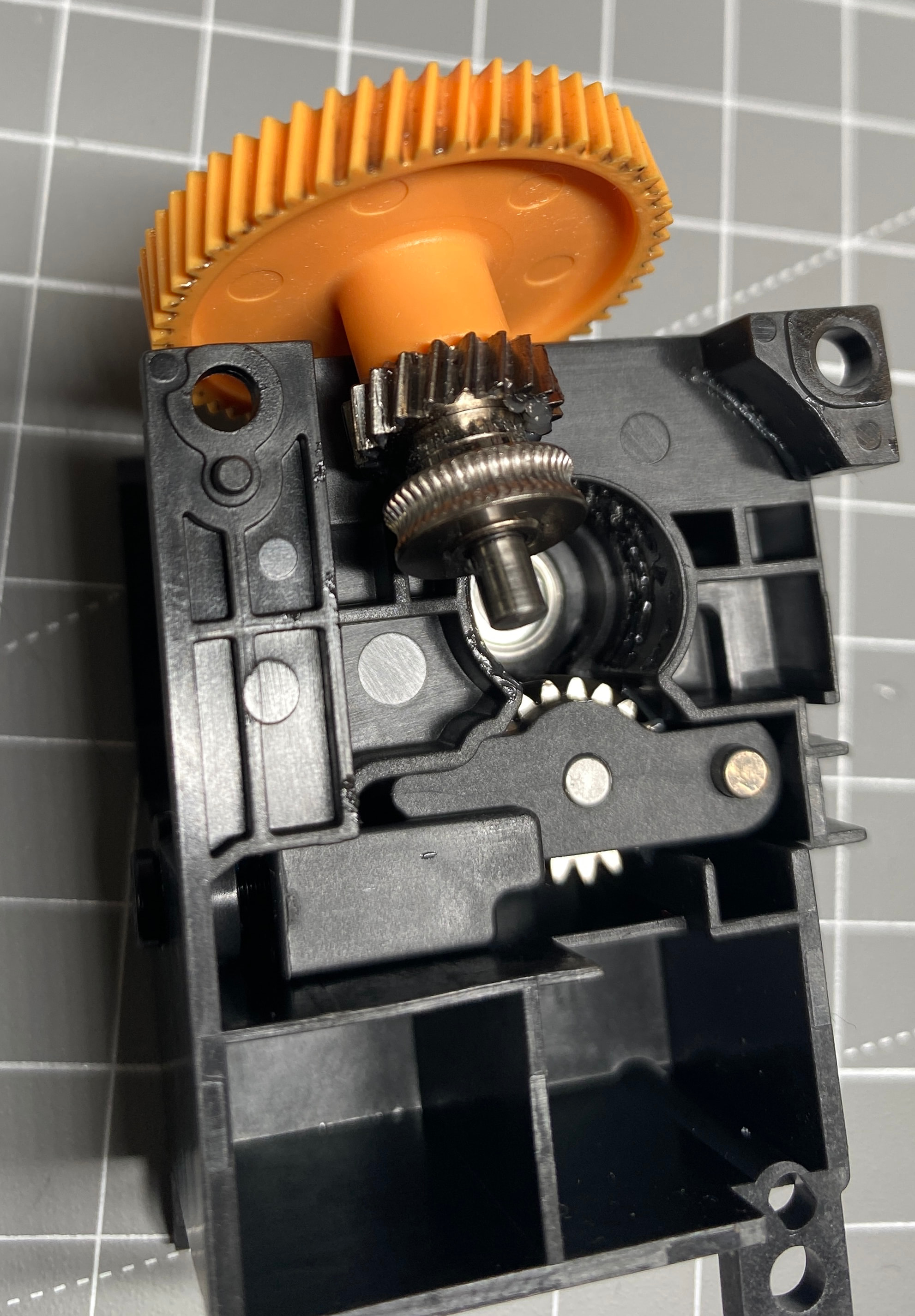

It wasn’t heat creep. Tried to print with a brand new 0.2 mm nozzle and the filament got jammed in the extruder during the filament switch. It unloaded the old filament, fed the new filamet to the extruder and the extruder started just clicking.
Might have to open it and see what’s in there.
Update: it wasn’t the extruder. It was as good as new even after 950 hours of printing.
The issue seems to be with the nozzles themselves. Tried to print again with a different colour filament and the AMS wasn’t able to feed filament past the heat sink. Swapped a new nozzle and the feeding issue was gone.
0.2mm nozzles get extraordinarily low flow, due to physics, so they are very vulnerable to heat buildup. Check the nozzle you just replaced for bulged filament bits. All it takes is one little piece to deform above 2.00mm, some unlucky retract, and it can be stuck.
