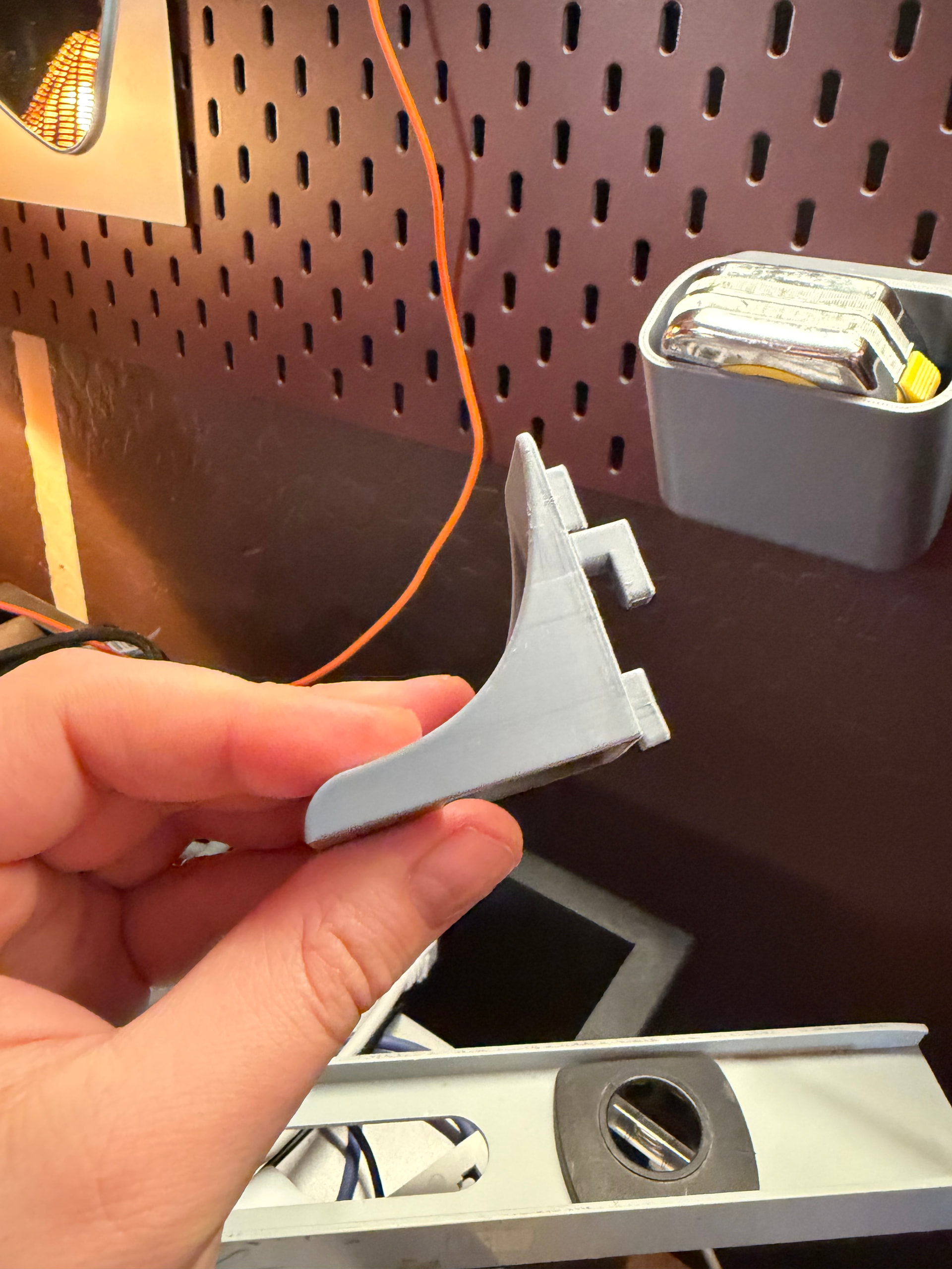

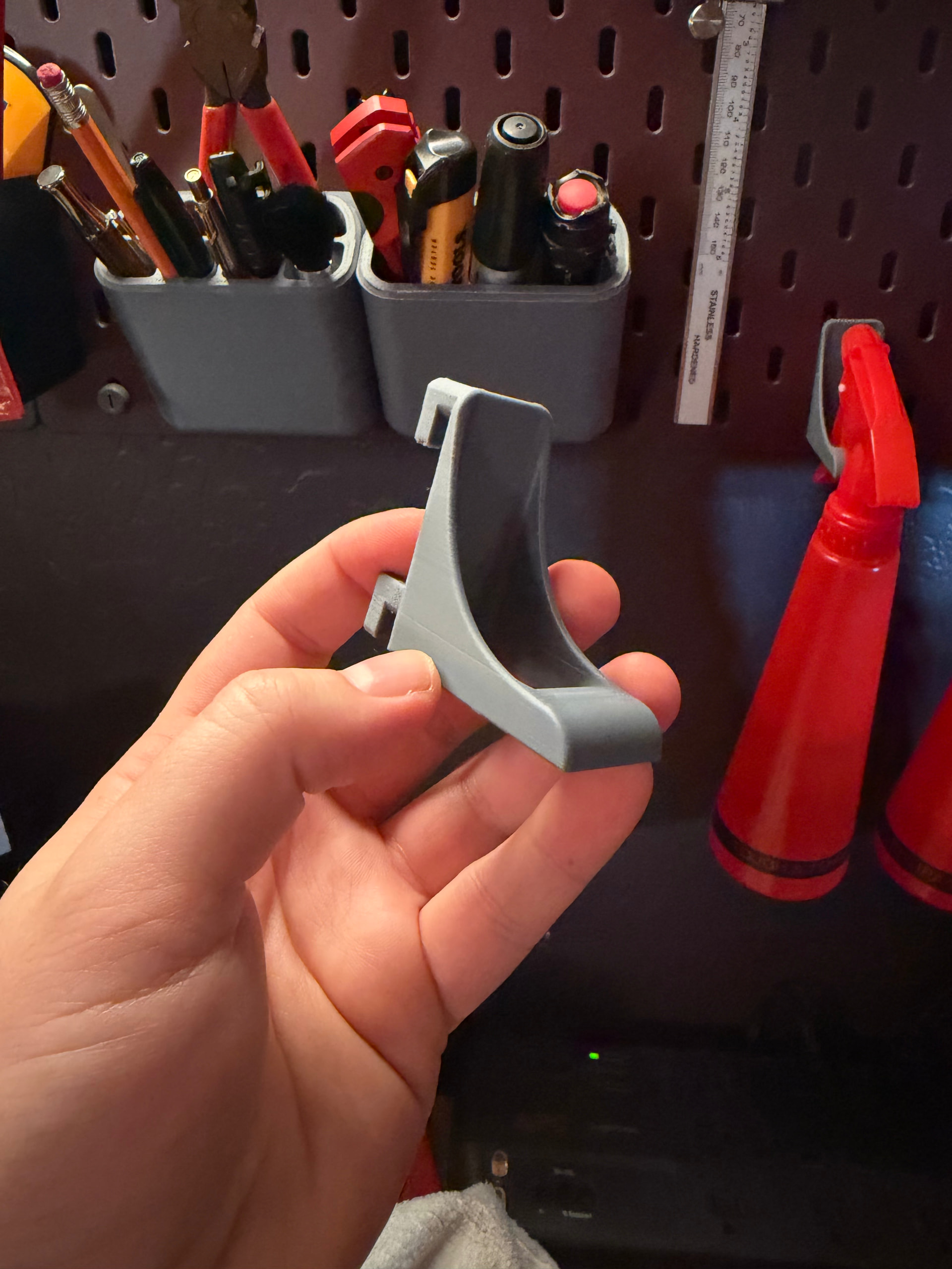

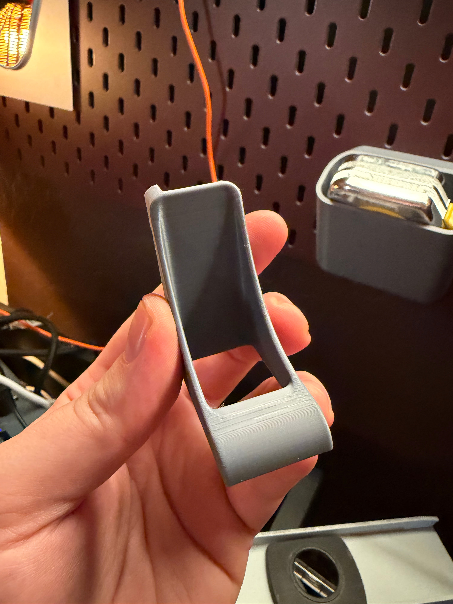

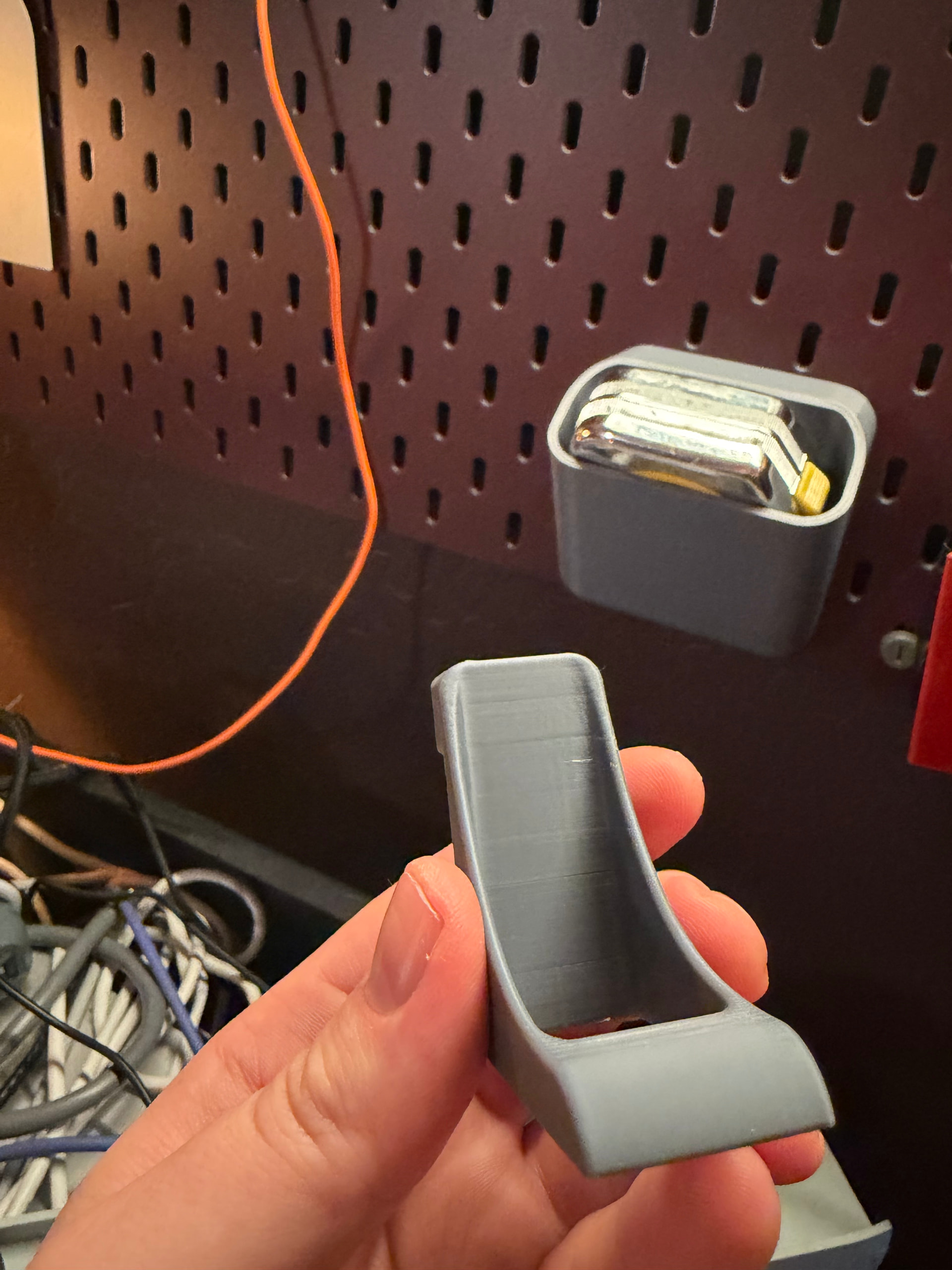

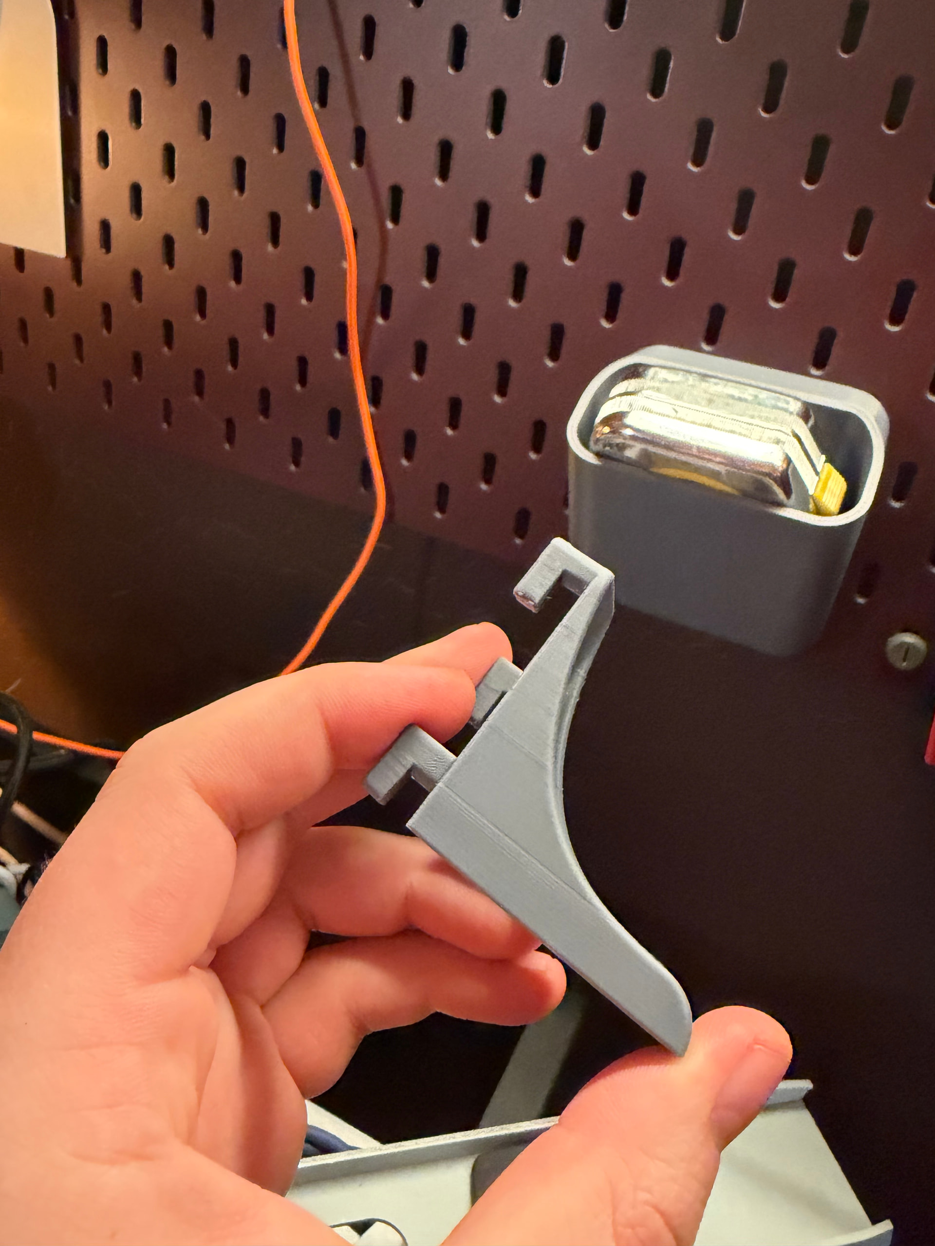

Hey guys! The x2d is my first printer that I’ve had for about a month now. I’ve watched so many tutorials and tried so many settings but feel like I can’t get this to where I want yet. I was getting some ringing and finally found out that slower speeds on the x2d can cause it too and did some tests and now have outer walls at 120mm/s rather than like 40 and seems to be better. Happy to add any other settings you need but how do I make this print better? Used 0.08 layer height. It’s pretty smooth but still can see those different lines in direct light. Build plate is cryogrip glacier. Only tried inland pla so far. Thanks!

There’s always going to be situations where certain lighting conditions will make the part look worse than it actually is (unlike my ex, she’s just always the worst regardless of lighting). I wouldn’t over think it. I think the print overall looks pretty decent, especially for something that is functional? I’m surprised you’d print it at .08.
I guess I’m not sure either though how much of the defects shown in the pictures are from you rotating the model to get the light to hit it right, vs it being a very obvious defect in any lighting.
I guess it makes me wonder too, where do your expectations come from on this?
I have a X2D, and it does fine. I like my H2D a little better, I’d say. Again, I’m not sure if you’re trying to play up defects with the lighting, but I can get models looking pretty ugly under the wrong lighting, but drop dead gorgeous under the right lighting. There will always be some level of defects from the FDM process that you’ll never be able to fully get rid of.

You might try printing that model on its side. That will smooth the front curves, eliminate the horizontal lines on the sides caused by differing layer times, and strengthen the hooks. But you may then need more support and have a couple of new layer lines on the front.

So this is my first printer so I don’t really have any previous experience with what older printers could produce, but I just am trying to get the quality of the prints as good as possible. Even though it is just a functional print I would still like it to look like a decent product and look good on the skadis board or at least as good as it can. It looks decent without being in direct light like that or from afar, but I am mostly trying to figure this out for other prints as well especially if they would be in the sun or just in brighter light in general. I feel like the layer line differences on the side could be better? I am just not sure what even the problem is because looking at the slicer all the lines seem to be the same height and same speed.

ah ok ill give it a try! Would it at 45 degrees work at all? Also, if I print it on its side wont each side have a different finish than?
See that’s the thing…looking at the slicer there shouldn’t be any different layer times on the sides so what is causing that?

Well, I think those kinds of defects are probably most noticeable on vertical walls like that. Sloped surfaces, things with more shape, tend to look better. To get a nice smooth vertical wall requires a very consistent print from layer to layer. Things like abrupt surface features (Like the hooks on the back) can affect that consistency in different ways, causing banding in sections.
You’re pushing out molten plastic, and there’s only so much control you can have over it.
There are some things you can do to help. I use 3 walls instead of the default 2, as it tends to help produce a nicer exterior surface quality. Your seam position can also matter, as having the seam change spots can cause some banding. It’s part of that molten plastic thing. You can’t just print a consistent line from start to finish. Starting and stopping the flow needs to be accounted for.
