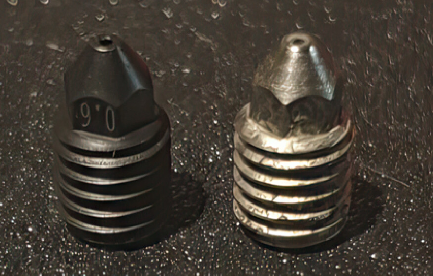

Coating nozzle (CHT clone) with nickel using electrolysis?

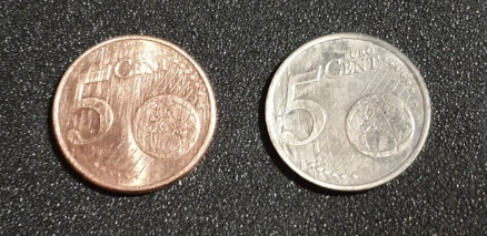

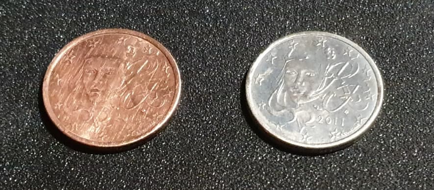

Well working pretty well, I need to find something to polish.
The coin have changed almost immediately of color (20 seconds)
EDIT: with a bit of polish
Yes, I know coating a hardened nozzle is completely dumb :slight_smile: But I was needing a guinea pig.
Result is not that good, but that’s a very first & fast try, interesting.
I got a couple of ideas to improve this process.
