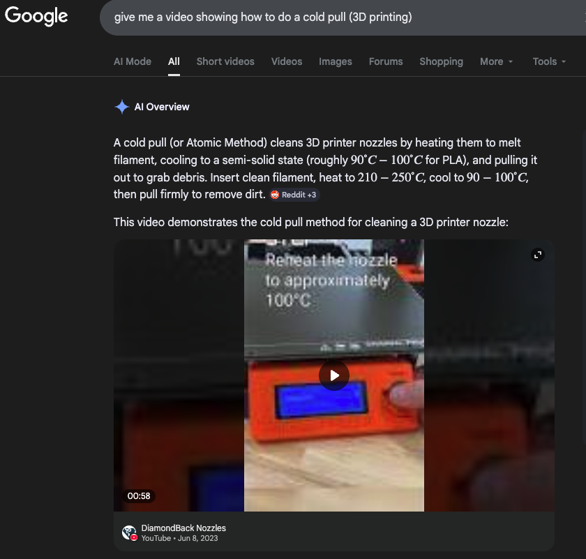

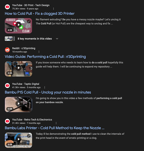

I typed “give me a video showing how to do a cold pull (3D printing)” into Google and got some links to Youtube videos. You can Google the same and click at the links to watch the videos.
