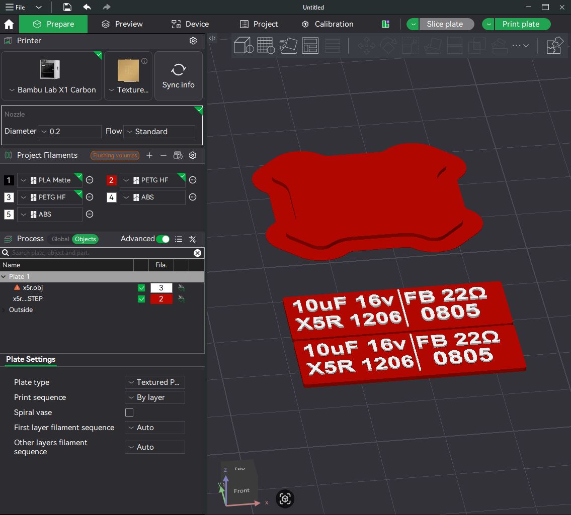

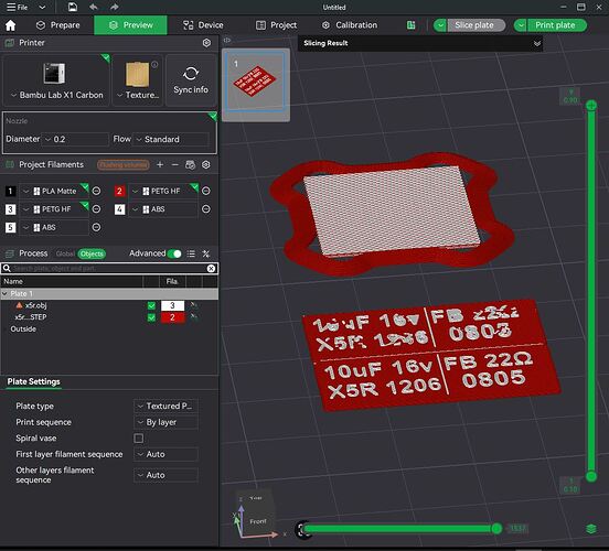

I’ve been making custom multicolor lables. Painting each one in Bambu studio is tedious. My method has been saving models as a colored .step and converting them to .obj online. This works most of the time, but sometimes details get lost when I slice the model, which doesn’t happen when I color in Bambu studio.
I’ve taken screenshots. The model is exactly the same. The “good” one is painted in Bambu studio, and the other is a .obj

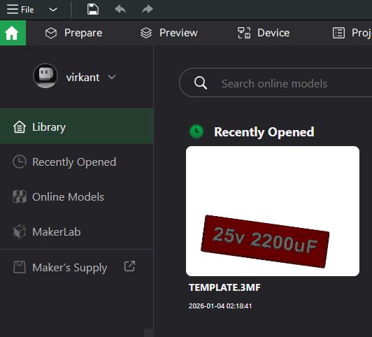

Sadly, it doesn’t work. I find it funny that the preview is showing a colored model, but color gets lost when trying to slice.
Tried the plugin. It seems the problem lies in the .obj format itself. It could be that the label text is too small… its just weird that it works fine if I color it in Bambu studio…

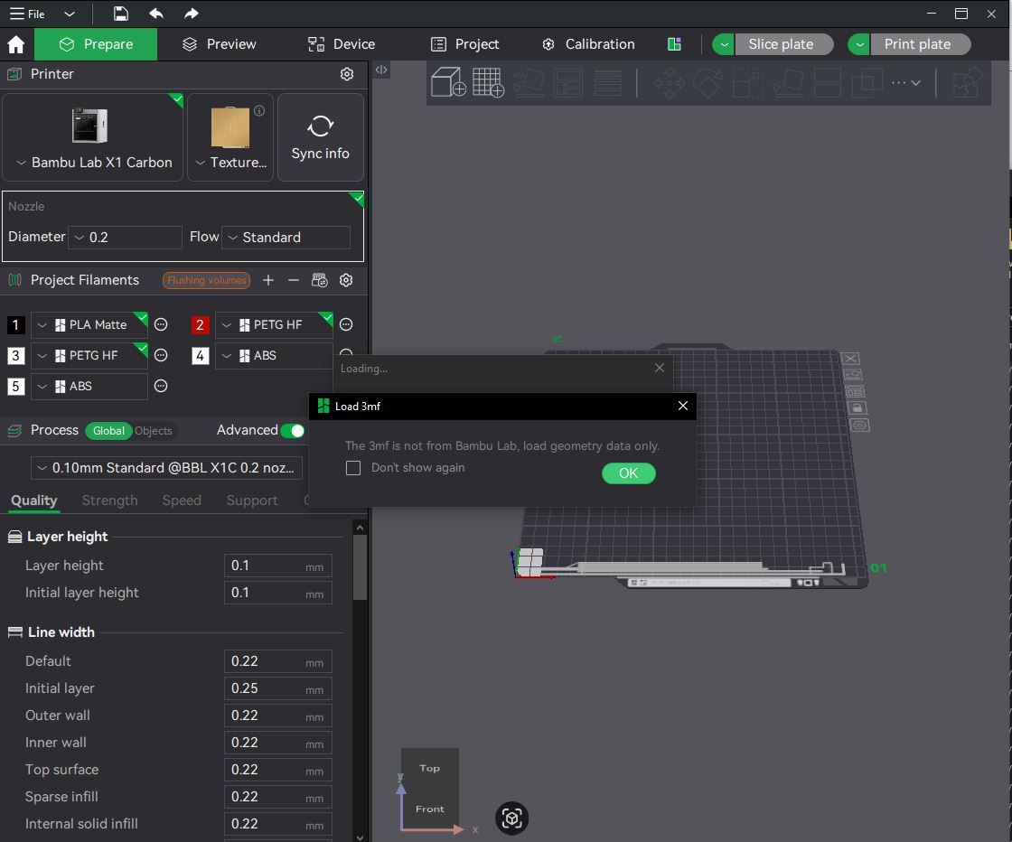

Yeah… I tried tricking BS into thinking its looking at its own .3mf file by editing metadata… It sems that they store color in a completely different way, since it detects it as a BS file, but cant find color data… Slightly dissapointing outcome tbh xD
