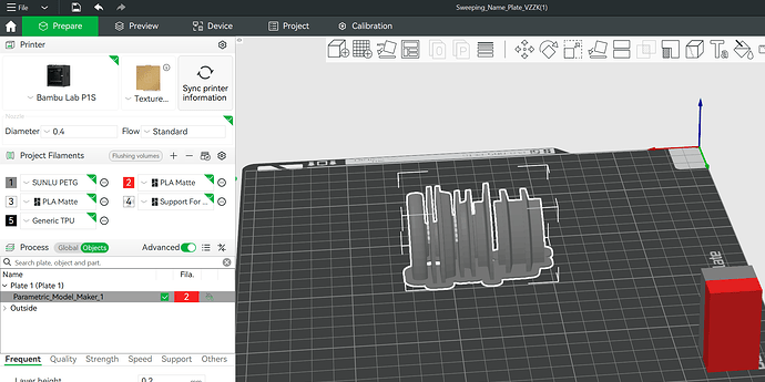

Coloring whole print but color doesn't change & it creates purge tower
As you can see in the image, I have selected the whole model, pressed 2 to color it with my red PLA filament, but the model remains grey (PETG) and for some reason a purge tower is generated. The other side of the model is also entirely grey, there is not one single red pixel on the entire thing.
What’s happening?

You have painted the model (or someone has), tis is likely overriding your filament colour choice.
There is a painted icon to the right of your model. As it also says "Parametric Model Maker for the object, chances are that tool did the painting.
  • Use the paint tool from the toolbar.
  • Select the *Erase all painting" button
  • Return back the the build plates (exit painting)
Your colour choice should now be respected.

It usually means the infil/or some part is remaining its original colour
just delete the icon next to the object to reset it
