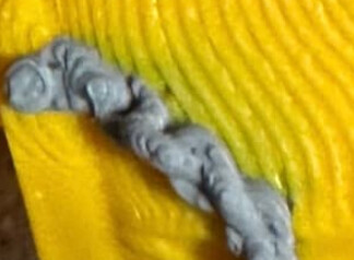

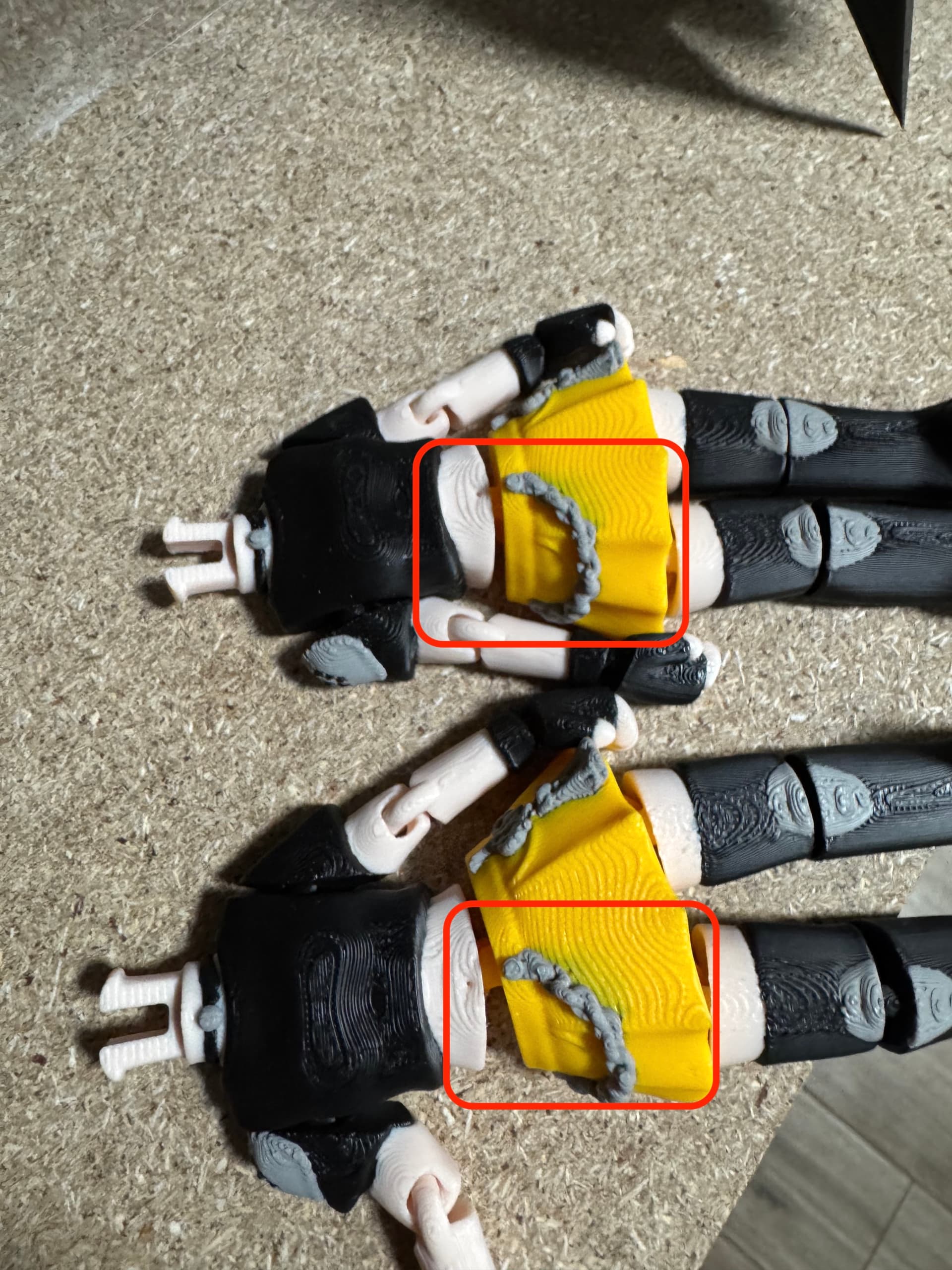

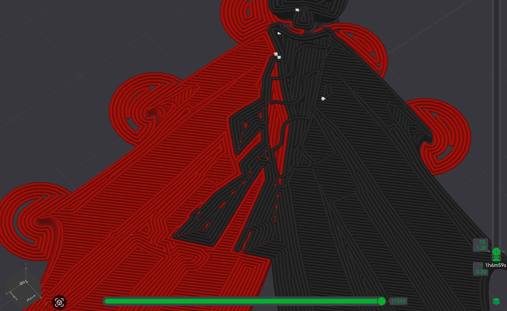

Almost two weeks ago I got my new H2C and started to make multicolor prints. And sometimes I face next issue: some colors are “bleeding”. I can’t understand how it’s even possible, such as it uses different nozzles for different colors. I posted some photos below
photos
Does anyone know how to avoid this?
Are you purging to infill?
I’ve noticed that with that setting on the H2C seems to not swap to whatever colour is used for infill in that area, just whatever happens to be loaded. So for example if you have black and red like for the tail there it might use black for the infill then do only the required walls in red rather than black infill in black areas and red infill in red areas.
You might be looking through the light-transmissive exterior layer of yellow and seeing more opaque inner layers of grey. Slice that again, and go to your preview tab, and inspect UNDER those elements to see if the slicer is making that area gray

You’re seeing a darker color showing through a lighter color. It’s not bleeding like ink. If you were using CMYK filament for a Lithophane, this would be how you’d combine layers to get all the different colors you need. If you look at the slicer, I bet you see grey in that area just below the yellow top layer.

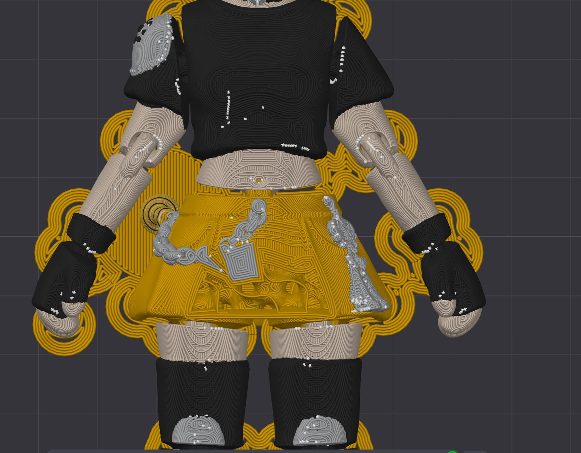

I just checked printed models and there are underlaying layers with another color
screens
Is it slicer’s choice to slice model by that way? And is there a way to fix this?
UPD: Purging to infill option is disabled for both models
The slicer is doing what it is told.
If the model is built up in parts merged to a single model in the slicer, you can choose to set a filament colour to each part appropriate for your choices.
If the model is a single part, then it appears you (or someone else) painted it in the slicer.
If you use the paint tool, it can do a great job if you know how to use each tool correctly. Most can’t. The paint goes beyond the surface to give it enough saturation to be seen when printed. However, depending on the triangles and the resolution you paint, it can grab more than you expect.

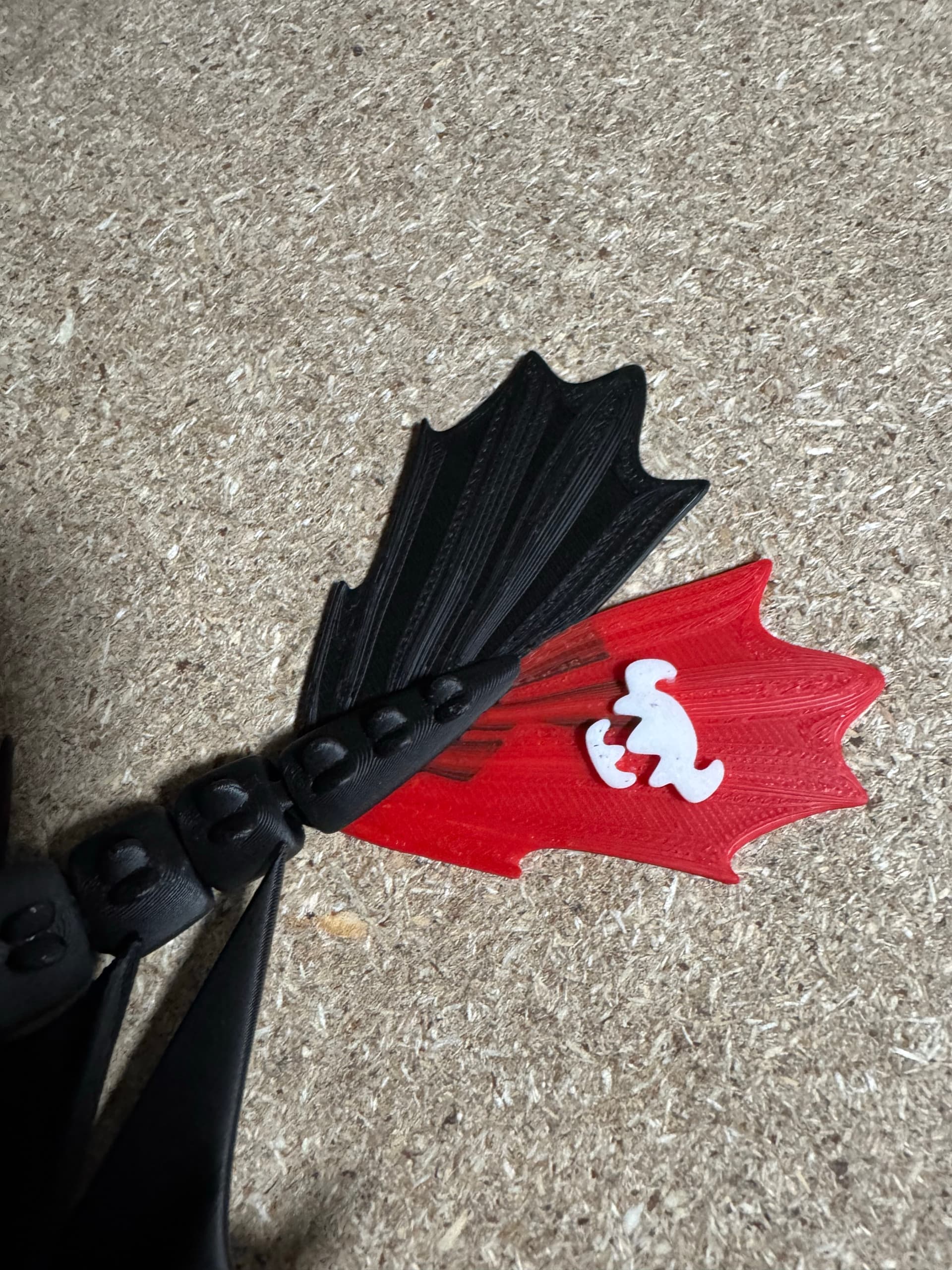

It’s not my model, it was downloaded from Makerworld. I tried to change some settings in slicer, tried to adjust Top/Bottom paint penetration layers options, but it does not change anything

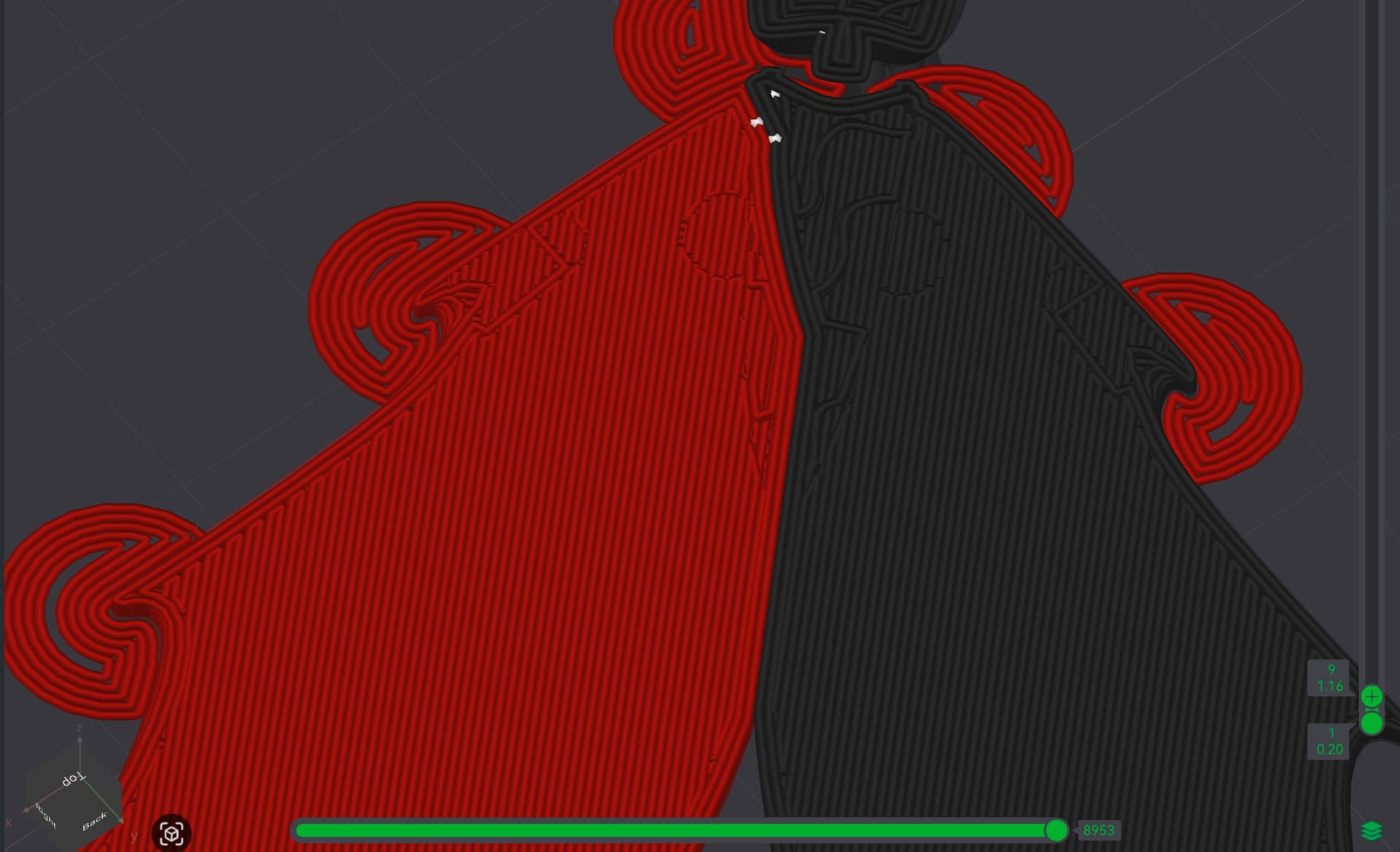

I just don’t understand next thing
Here is layer #9
screen

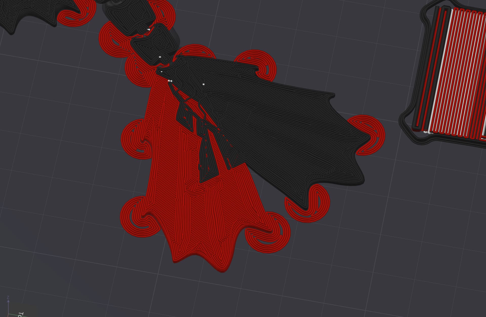

And here is layer #10
screen
Why? If this part of model should be completely red? Next layers (12, 13) became red again
Every model is made up of many triangles, I designed some with well over 30 million triangles.
When someone paints the model to give it colour, they choose how many triangles (the resolution) brushes will affect. Too few and it takes ages, too many and you loose accuracy. Worse, the painting tool thinks many unrelated (to your eyes) parts get grouped in.
Have you looked at the paint tool yourself in Bambu Studio?
It is worth the time you invest in it as you can fix many of these issues with patience. Play with the different toolbar tools and the bar that changes the scale of the painting area (what I call resolution).

The slicer is creating “Anchors” to ensure a good mechanical bond between different colors. Otherwise, especially small colored spots can literally drop out (amhik :joy:). As mentioned by @Bullocks and @RocketSled , this can lead to such bleed through effects.
The best way to avoid this is to have one object per color or to use modifiers for color application but this is not always possible.
