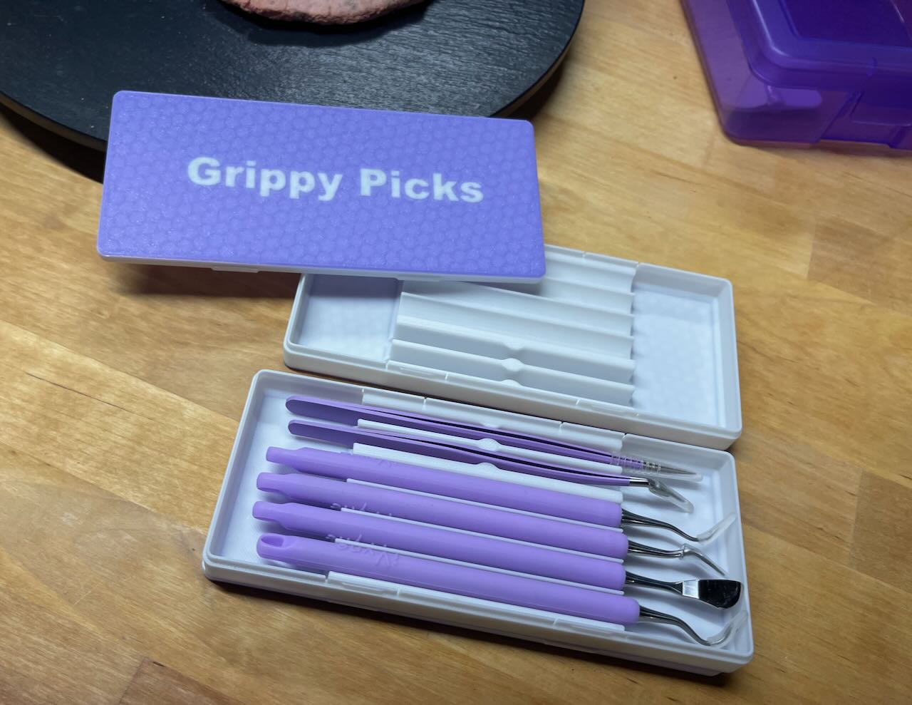

It is news to me that some have trouble with the combo. I’ve printed quite a few mixed parts; here’s a mix of a generic purple PETG and Sunlu PETG HF white:
(from a new project I just uploaded to MakerWorld)

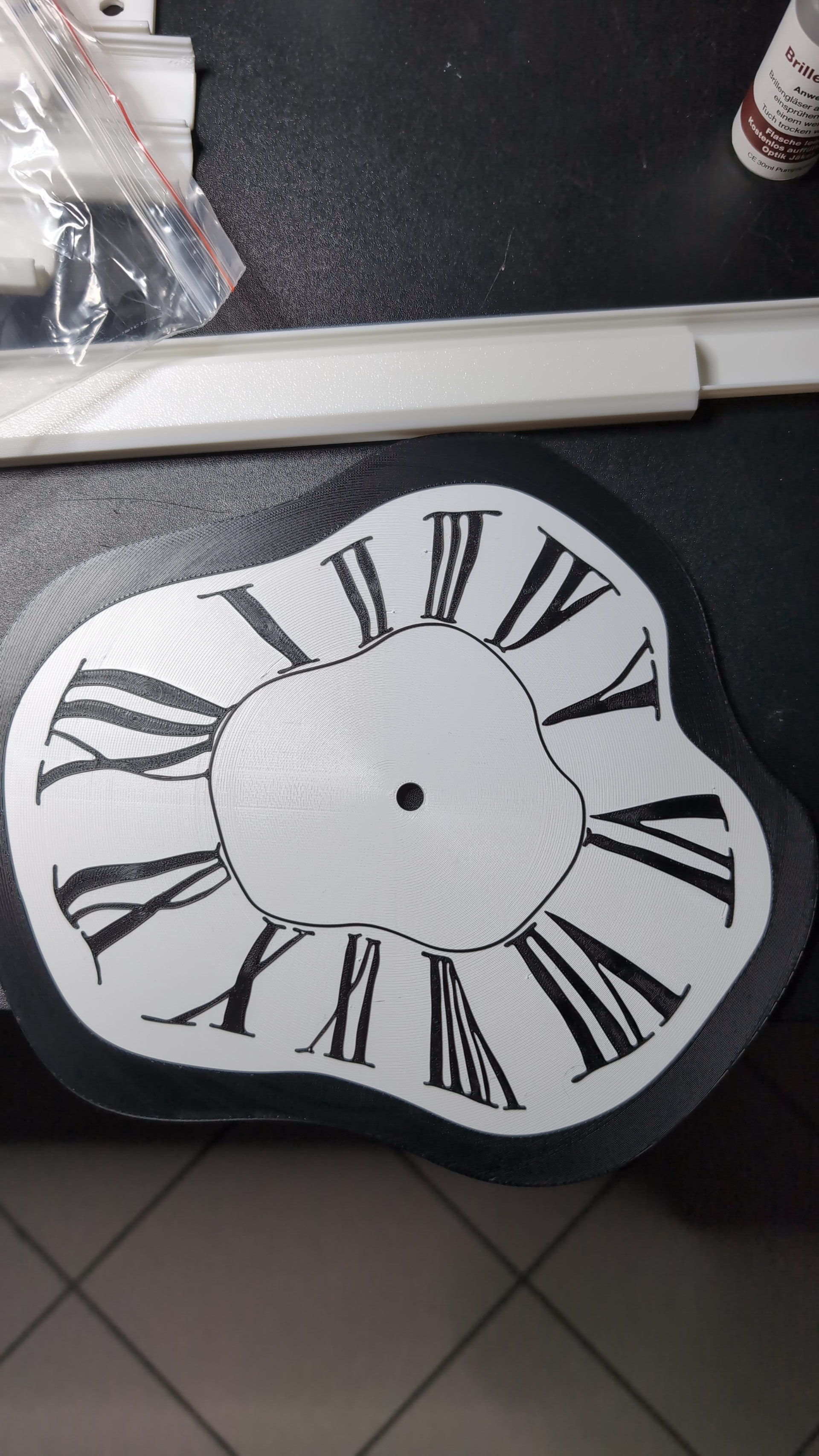

i printed this clock and the marked areas show defects, i sadly already threw the prime tower away so i cannot show those defects
so after seeing a tip from bambu studio, it says that PETG Basic has higher schrinking rates
maybe there is the issue
