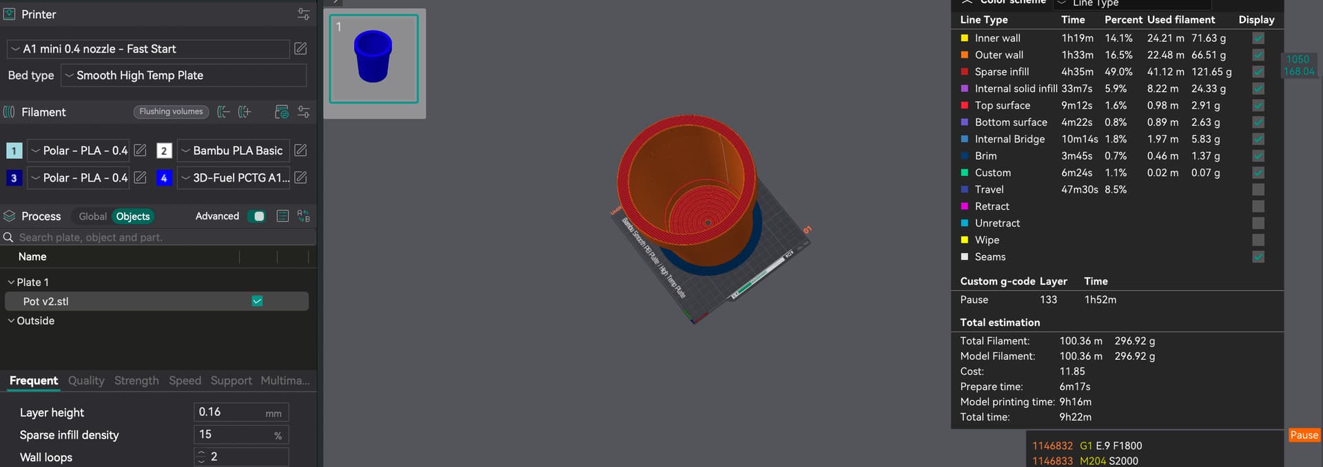

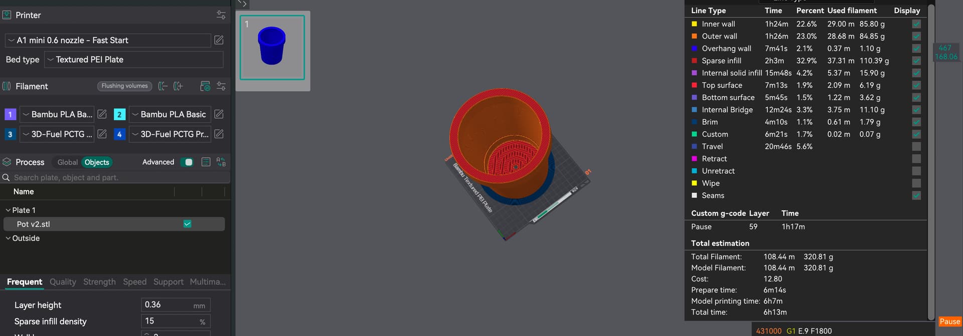

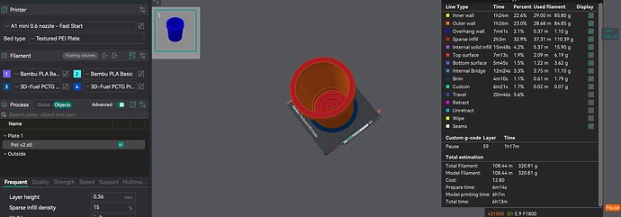

In the middle of some PLA prints right now, but I need to make an easy potted plant out of my PCTG. Will show the results and time savings tomorrow.
Just slicing for S&G:
.4 - 9 hours .6 - 6 hours
I’ll show the print tomorrow.

If my A1 mini can do it, why cant a P1 do it? I have a P1 coming in the mail as we speak, I wanted to provide a test, showing it works, showing increased speed, and when my P1 shows up, I’m going to do it again. I need more pots anyway lol
