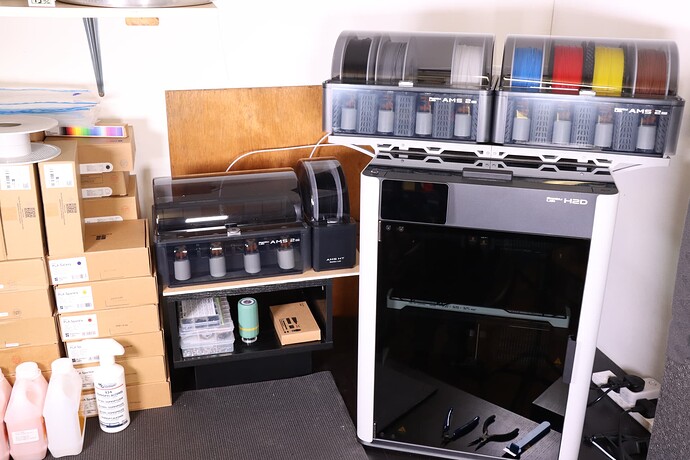

My AMS HT is around 350mm as it’s right next to the printer - has been fine so far… 2 of my AMS’s are also cut to less than 600mm - again, no issues…
Good point about the Bambu team not knowing where the AMS(s) are. I think the Bambu Lab frame of reference is having an AMS on top of the printer where the PTFE adopts a sort of “S” shape curving down and then left (as seen from the back) to enter the the printer. That is two turns so extra length makes sense. If one places the AMS(s) close and on the left of the printer (as seen from the front), it is a relatively gentle arc and a shorter than 600 mm may be possible.

(OT) Considering the equipment I guess you print a lot. Doesn’t that bother you having the two AMS on your printer?
I had also two AMS 2 Pro on top of my H2D but this got really annoying every time I wanted to open the top glass cover (which is for some tasks a lot more convenient than working from the front door) so I put them on a shelf 10 cm above the printer which makes maintenance easier.
I’ve never had any need to open the top glass cover TBH - don’t think I ever have since I’ve been running the printer!
