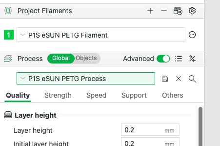

I am about to try a new roll of eSun PETG Basic in my new P1S and have found the eSun filament and process profiles on their website and have copied into the appropriate folder and restarted Bambu Studio.
I now see the process and filament so I decided to try and do a calibration but don’t see the new filament in the AMS Material selection dropdown. I don’t understand what this list of filaments is representing, I am assuming these are “physical” filaments in either an AMS or EXT spool. How do I get my new eSun PETG in this list so that I can do a calibration?
And then there’s this screen - yet another place to define filament… pic below.
I performed a flow calibration and gave it a name and now that’s disappeared into the ether. Why is this so difficult?

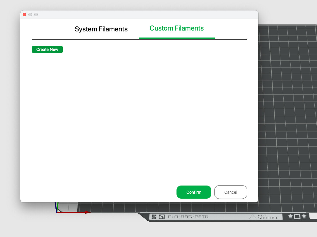

There’s:
  • Project Filaments
  • System Filaments
  • Custom Filaments
  • AMS Filaments
  • User Preset “Custom Filaments”
I’m lost :frowning:

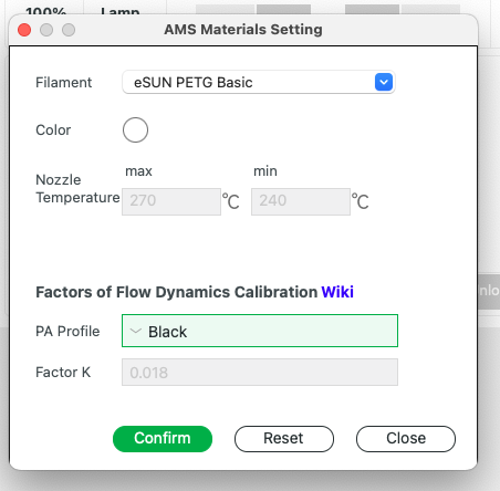

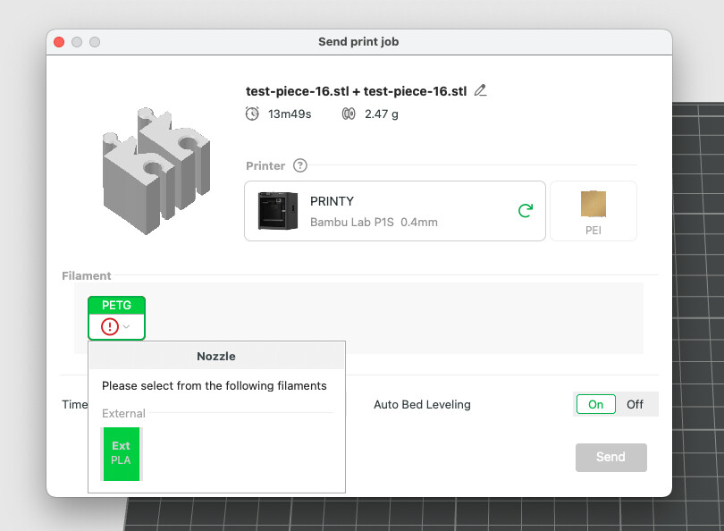

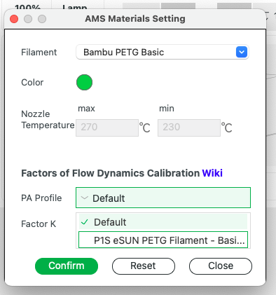

All I am trying to do is get the correct filament listed here (the one I ran the flow calibration on):
If I change this AMS Material Selection to “Bambu PETG Basic” I can then see my eSun calibrated K Factor but I don’t want the “Bambu PETG Basic”, I want “P1S eSUN PETG Filament” in this dropdown.

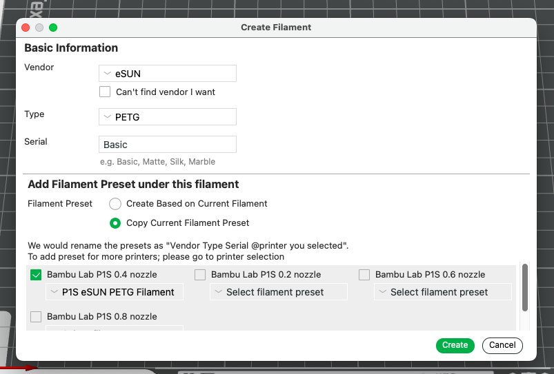

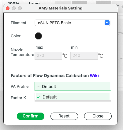

If I go back and create yet another new “Custom Filament” based on the downloaded “P1S eSUN PETG Filament” I then see it in the AMS Material Setting dropdown but my flow calibration K Factor is now gone.
So 4hrs later this is where I am at.

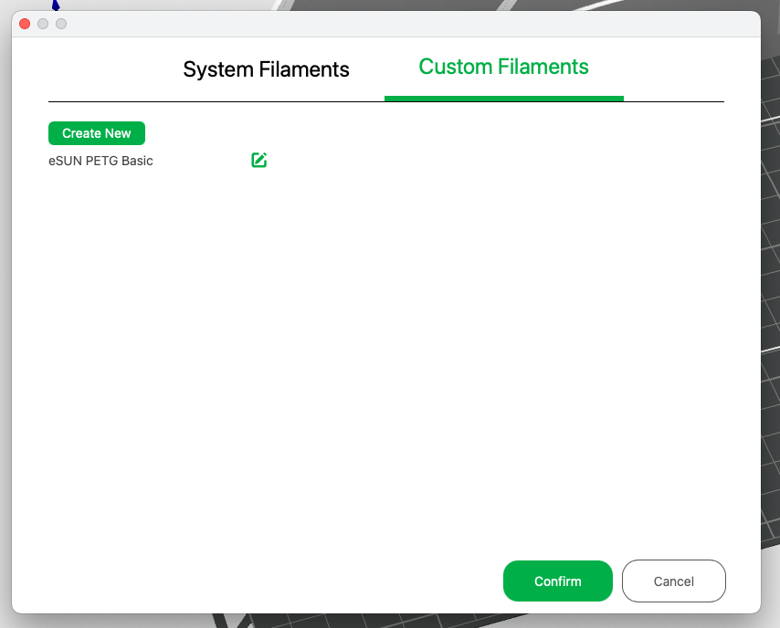

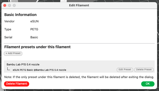

Created new “Custom” filament and copied the eSun 0.4mm PETG profile:
This now appears under my Custom Filaments:
This then allowed me to apply my K Factor setting in the AMS Material Setting screen:

Thanks for the reply. You are correct about the K factor storage. It is stored on the printer and is seperate from gcode. The reason is that they want gcode abstracted from K Factor / Pressure Advance as this is a per filament setting. However you can add PA to the filament profile in Orca and a one line filament gcode change will have it recognise the PA value in BBS. I am back on BBS for now. The whole thing is a bit of a mess. Kind of regretting moving from Klipper, I wish I had just built the Voron.
