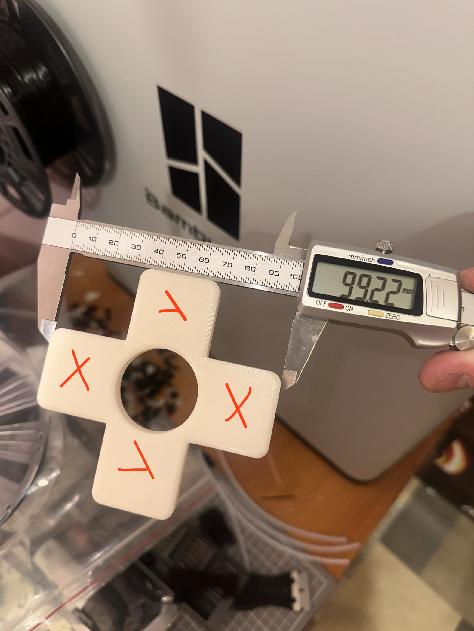

I’m observing a consistent dimensional difference between the X and Y axes on my Bambu Lab H2S, which becomes noticeable on larger parts.
Test case:
• Model size: 100.00 × 100.00 mm
• Material: ABS
• Shrinkage compensation: not applied
• Expected overall size: approximately 99 mm due to ABS shrinkage
Measured results (without shrinkage compensation):
• X ≈ 99.2 mm
• Y ≈ 99.0 mm
• Difference between axes: ~0.2–0.29 mm
The exact value varies slightly from print to print, but the difference itself is stable and repeatable.
If I apply shrinkage compensation to bring the part back to nominal size, the result becomes approximately
100.0 × 100.2 mm, meaning the axis-to-axis difference remains and is simply shifted to the final dimensions.
It is not clear whether the Y axis is underscaled or the X axis is overscaled — what is consistently observed is the relative difference between the two axes.

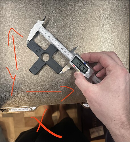

I printed cross-shaped test parts in black PLA, oriented diagonally and placed in the same positions on the build plate.
The measured dimensions of these PLA cross parts are identical, which suggests that there is no XY skew or diagonal distortion.

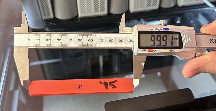

No shrinkage coefficient was applied — this model was printed without any shrinkage calculation or compensation. I understand how ABS shrinkage works and I’m not focusing on the absolute size deviation.
The printed part (red ABS) measures:
• X = 148.92 mm
• Y = 149.15 mm
This results in a stable axis-to-axis difference of ~0.23 mm.
The concern is not that the part is smaller overall (which is expected with ABS), but that one axis is consistently larger than the other.
Even if shrinkage compensation is applied
later, the part would only shift closer to nominal size, while the ~0.2 mm difference between X and Y would remain.
This consistent axis-dependent difference is what I’m trying to understand.
This cross was printed aligned normally along the X and Y axes (not at 45°).
There is a small difference between the X and Y measurements, but it is minor — depending on how it’s measured, it may be around 0.1 mm or slightly more.

And what’s surprising is that when printed diagonally, PLA comes out accurate to within just a few hundredths of a millimeter
I also separately printed calibration models. Dimensional differences are still present, even with a shrinkage compensation factor applied. The shrinkage factor used was 99.41. The measured dimensions are approximately Y ≈ 99.98 mm and X ≈ 99.81 mm.
I am attaching the 3MF file as well as photos for reference. The overall trend of an approximately 0.2 mm dimensional discrepancy remains consistent across prints

Here are samples printed at 45 degrees. There is still a difference, but it is already minor and, overall, acceptable to me. A shrinkage compensation factor was applied, although not very precisely.
