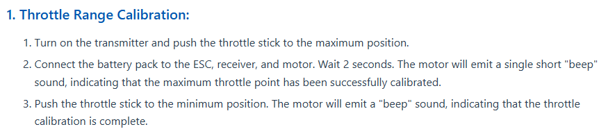

Honestly yeah, I think that’s where my problem is. For now I am looking for documentation on how to start an arming sequence on my ESC specifically. For now I found this part of a documentation:
However, there is no single “beep” at the start, so I think I need to start the arming sequence in some way.

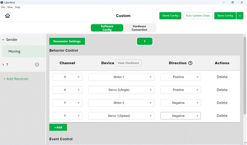

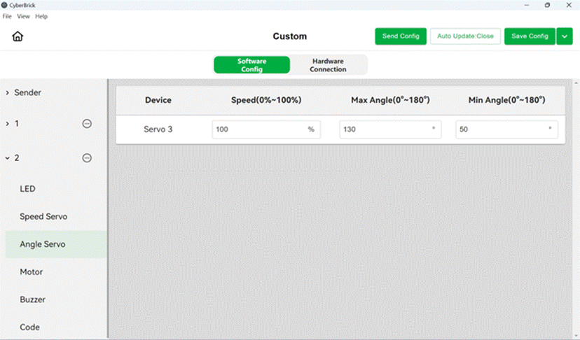

There might be even an easier solution - via CyberBrick app you can limit the “servo” travel:
If you limit the angles from min 45° to max 135° (middle 90° position plus/minus 45°), you should also get 1.0 to 2.0 ms pulse output, as usually expected from R/C model ESCs.
And you should also be able to reverse the function, to have a short pulse (1.0 ms), as typically expected for ESC idle input-command, at stick down position and high pulse (2.0 ms for full throttle) at stick up position, by negating the direction:
