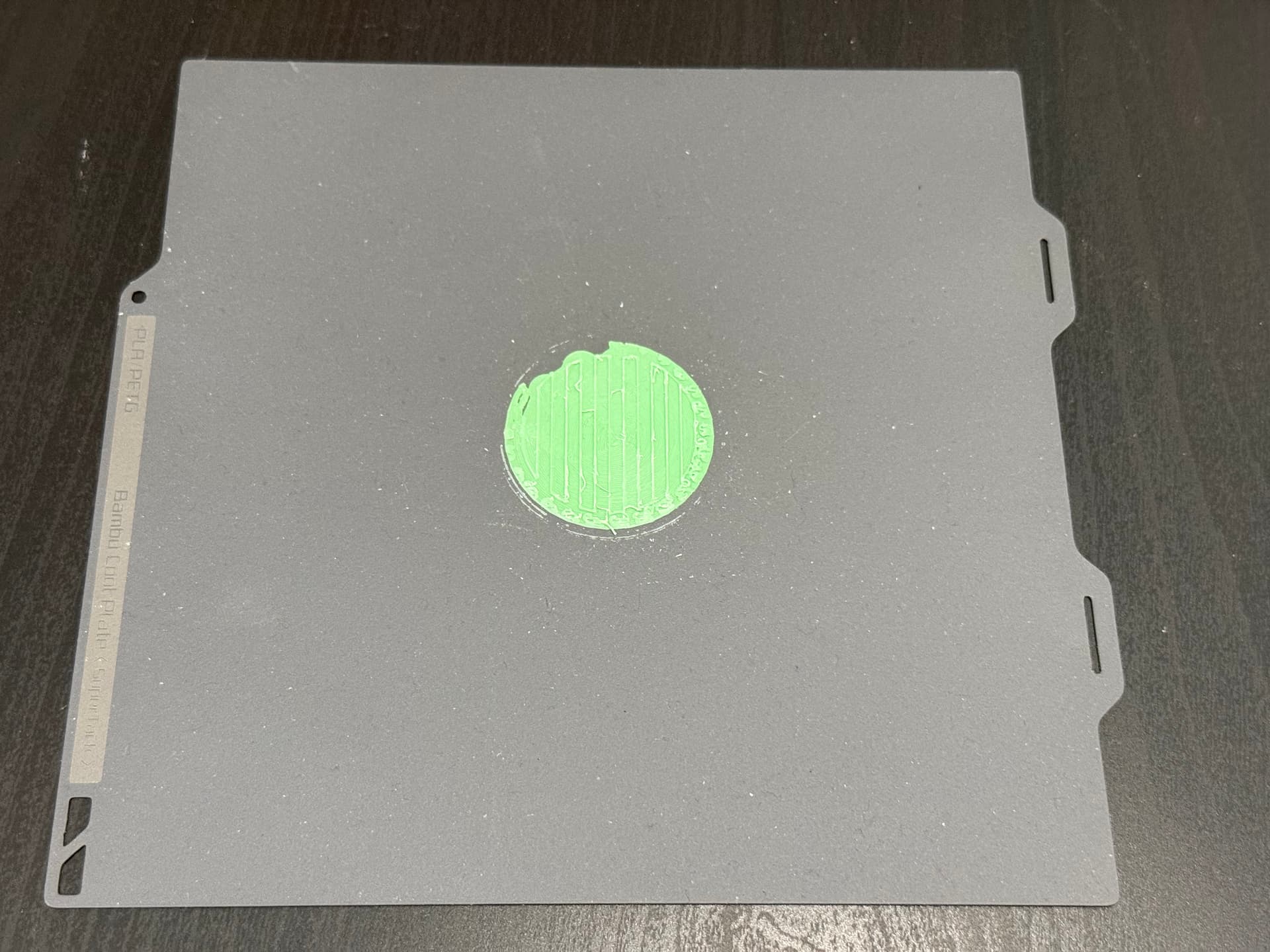

I have been trying to get a great first layer with the cool supertack plate….uggghhh
I am using matte pla on my p1s. I have calibrated filament and machine multiple times, levelled the bed, chosen the correct plate/nozzle, cleaned the bed and nozzle,dried the filament, altered first layer flow rate, tried different plate and nozzle temps etc. sometimes it looks somewhat ok but then I try to print a second time and it’s ■■■■ again.
My filament sticks but always looks under extruded which is not helpful when I have to print my product top down. The slightly textured matte finish is perfect so I am really getting annoyed that I can’t get it to work!

Welcome to the community. It would be helpful if you could upload some clear photos of the surface you’re unhappy with. Then members here can offer more specific recommendations.

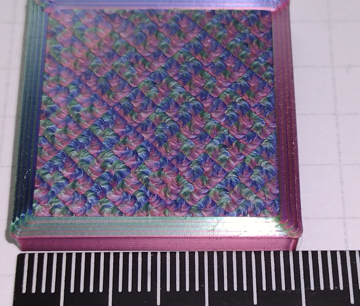

Alternatively, sometimes it’s best not to fight the slicer but to feature it. What I mean is to use a surface pattern like Hilbert Curve, Archimedean Chords, or Octagram Spiral to camouflage the surface.
Here’s an example where I experimented using multicolor silk with a smooth build plate. I’ve found that for symmetrical objects, Archimedean Chords or Octagram Spirals produce especially pleasing patterns.
