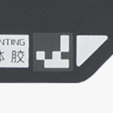

Could someone post a picture of H2C Engineering Plate code
I plan on using the engineering plate code on my H2C glacier plate which is missing a plate code.
I noticed H2C textured plate has a different code than H2D’s and suppose it is the same with the engineering plate.
If you own one, can you post a picture of the code so I can replicate it. Thanks
If you pulled this from the store, it was incorrect for my H2D.
I had good luck with this model but again only speaking for the H2D: https://makerworld.com/en/models/1360489-bambu-lab-h2d-h2s-h2c-magnetic-ar-qr-code#profileId-1790937

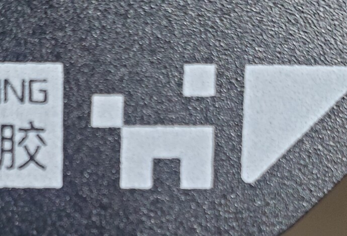

That’s why I need a picture of an actual plate as I have no confidence in either the store (unless someone confirms it’s the actual code for H2C) or makerworld. I « paint » my codes using white heat transfer and when applied, they are very difficult to remove without damaging the coating… I could try sticker first and see if the plate is recognized but I prefer to make it right the first time
This is from a genuine H2C-specific Engineering Plate, purchased early Jan. from BL store.
Let me know if you need a better picture… I’m guessing you re-create the codes with actual vectors, but I can do a better photo if needed.
HTH,
-Max
Thanks Max, this is great! I was right not to trust anything online :slight_smile:
Picture is fine I will just recreate the code from a 4x4 matrix
Edit: Makerworld design was right though :wink:
