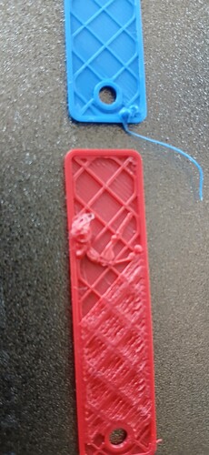

Could this be this damp Filament
Hi all brand new 74 years young (well almost)…
Bambu A1 Mini…
like to find out stuff myself but 5 failures 2 with same filament, the red was only used 15 hours ago and all was great just need someone to verify this for me and I can get on with stuff and leave you good people alone too deal with real stuff…

Did it lift itself off the build plate? (the red one)
I’d clean that plate within an inch of it’s life, try again, then consider dryness.
Moist is easier to see on walls, tops, and travels, so this top-down view into infill doesn’t give us much to judge on
Thanks for the reply… All five did not lift they all on or about the 4-6 layer a small glob or sometimes a little more than a small glob came out of the nozzle and then as the head came around it wiped it of the plate…
I always clean the the plate with dish soap and water then dry with good quality paper tower and never touch the pale again until finished…
After I posted the first message I recleaned the plate and the print did finish but for the first time since I had the printer the bottom right corner lifted about half a millimeter… Then I finished for the night…
History: Had the printer now for two weeks straight from the box I forgot to clean the plate but it printed without any problems and has been until now, I have been using esun ePLA-gloss 1kg roll and then .250 rolls from Sunlu various colors… But I clean the plate as stated above each day but between prints I rub down the plate with clean paper towel before the print starts…
I did change to another new Hotend with the last print, the one that lifted but the print was all good other wise…
Will give it another go tomorrow…
Carry on then, seems like you’re on the right path. Maybe do one of those full self calibrations from the pad of the device, too, if you haven’t done it since installing the new nozzle.
