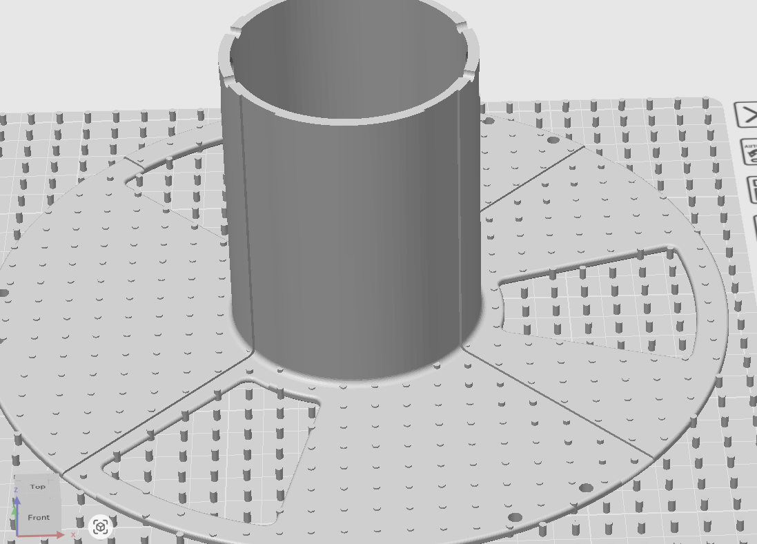

Creating a mesh. Need help with Bambu Studio
Trying to create a mesh for my spool.
I thought I could fill the bed with cylinders and convert them to a negative part - looks like this doesn’t work that way.
Probably there’s an easier way to create a mesh like on the SUNLU spool?
Please advise, I’m a newbie here.

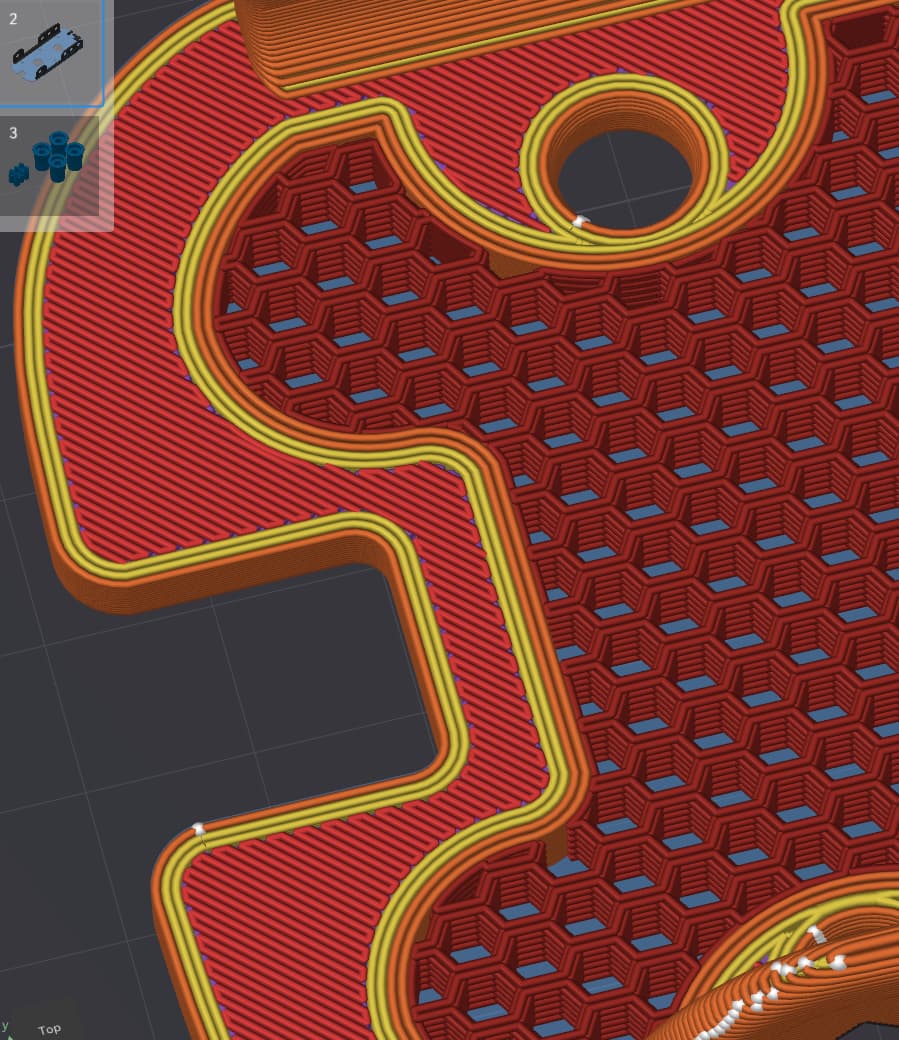

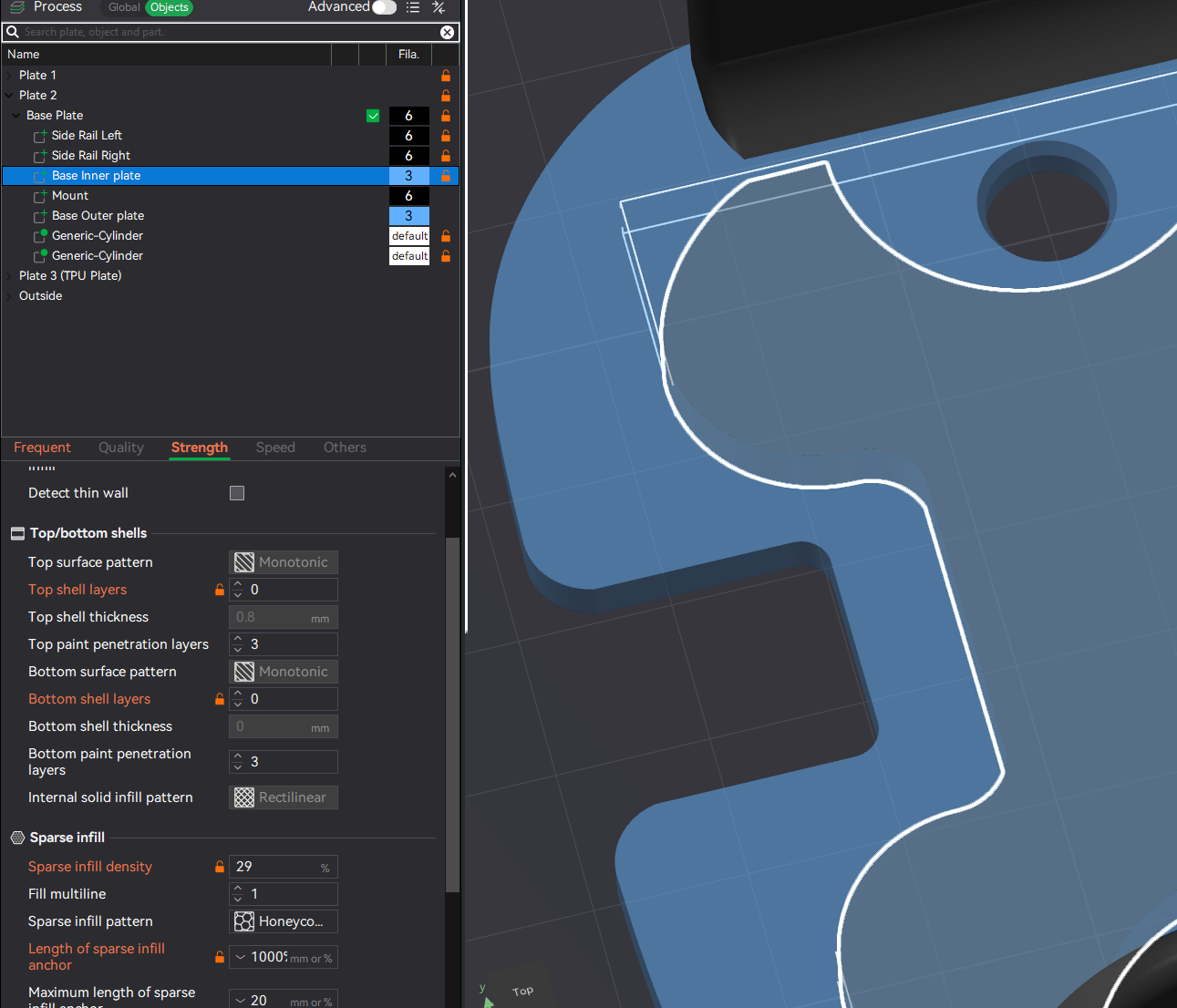

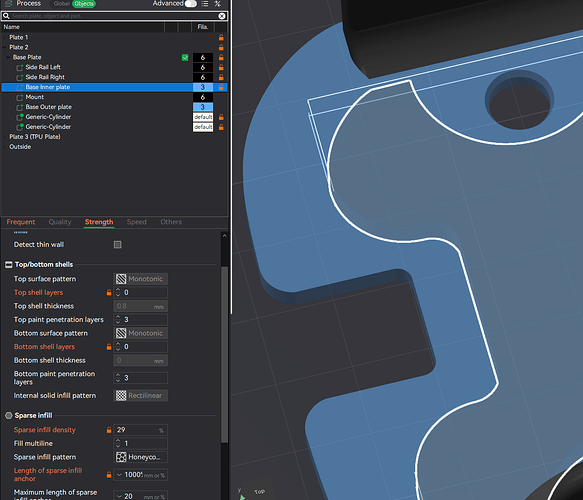

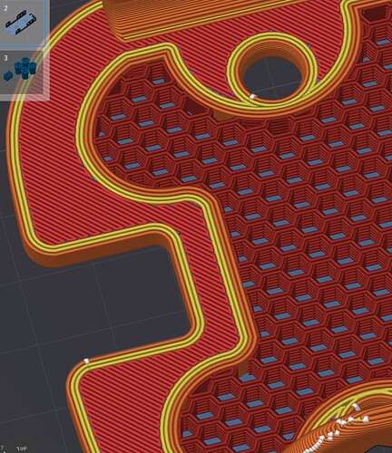

One related technique I’ve picked up for something like this is to use infill patterns on parts of the model w/out top/bottom shells. Requires the model separated into “outer” and “inner” parts. So here “outer” would be the outside rim and core sections of the spool, and “inner” being the spool walls, if you will. Then the walls can be set up to use zero top/bottom surface thickness, but with some kind of infill that makes a nice pattern with some inherent strength, like honeycomb for example.
Not sure how clear this will be, but in the screenshots here I have the “Base Inner plate” and outer plate separated, along the highlighted line, although they’re actually joined together once printed (no gaps). Then I adjust the “inner” part to have no top/bottom, while the “outer” frame is more typical and provides most of the strength for the part. Ignore the other parts, they’re not relevant to the example.

I tried Mesh Boolean, and it was exactly the approach I had in mind. I used it to subtract the cylinders I added, but performance was very poor. The app could only process a few at a time. I had to do 5 cylinders, wait around 2 minutes for it to finish, then spend another minute fixing the model afterward.
Considering there are about 200 cylinders total, that workflow is not practical.
I also tried using infill patterns on parts of the model without top/bottom shells. I experimented with the settings from the screenshot you provided. It was a neat trick to learn, but it did not work for my use case.
