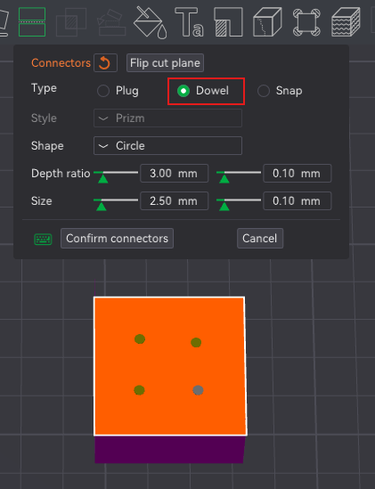

I know there is an option when you cut to create alignment pegs, any chance there could be an option that cuts and aligns 2 holes and then just creates the pegs seperately for you? sometimes the petgs it creats are the one that touches the bed, then you have a bunch of support material you have to print for that piece because its raised up by the peg.
When cutting choose the “Dowel” option. That will create holes and separate dowels/pegs you can insert to the holes to align.
Omg, thank you for that, I can’t belive I missed that!!!
