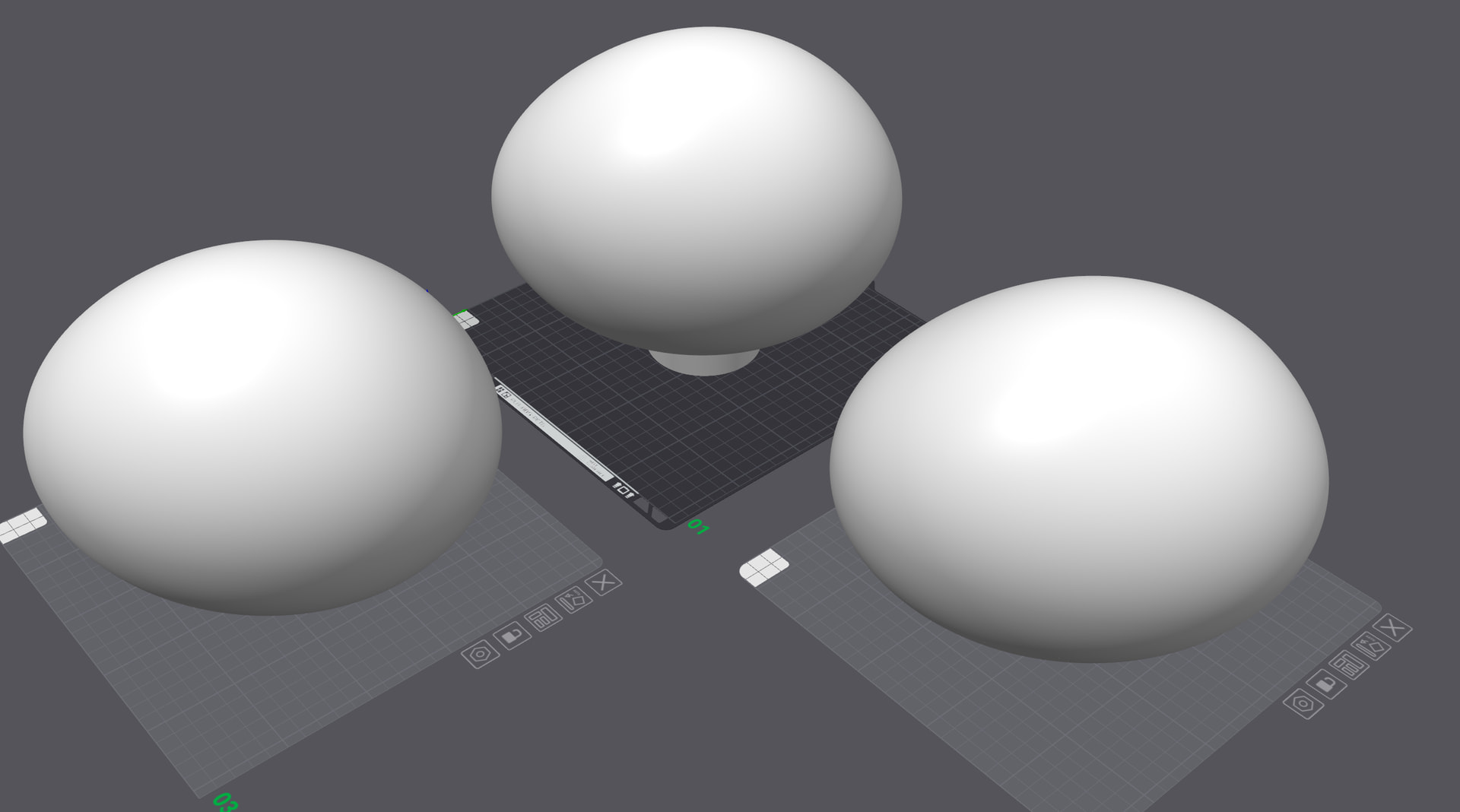

Plate 1 is what I have ended up doing, plate 2 is where I tried the hollowed shape in modeling, plate 3 is the solid shape. In preview mode (showing line type), the problem I am having more obvious. (I’ve also played around a lot a bunch of settings including the wall thicknesses, which didn’t seem to help) https://drive.google.com/file/d/1Ibj0xjvXz3mExQId4cne-QyfMb7vRZGh/view?usp=sharing

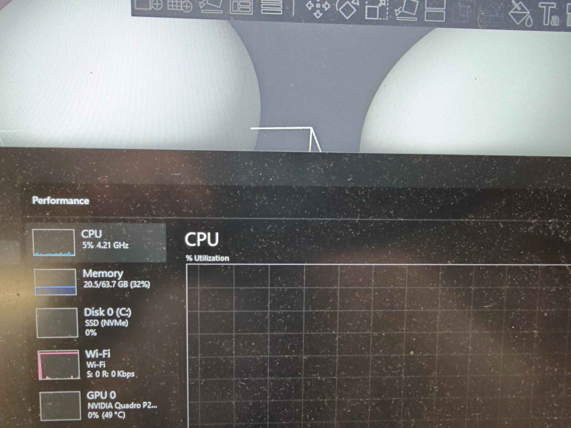

Holy moly, I know that wasn’t the question, but you should definitely check your workflow or export settings: 130 MB - just opening that file makes even my high-end computer sweat.

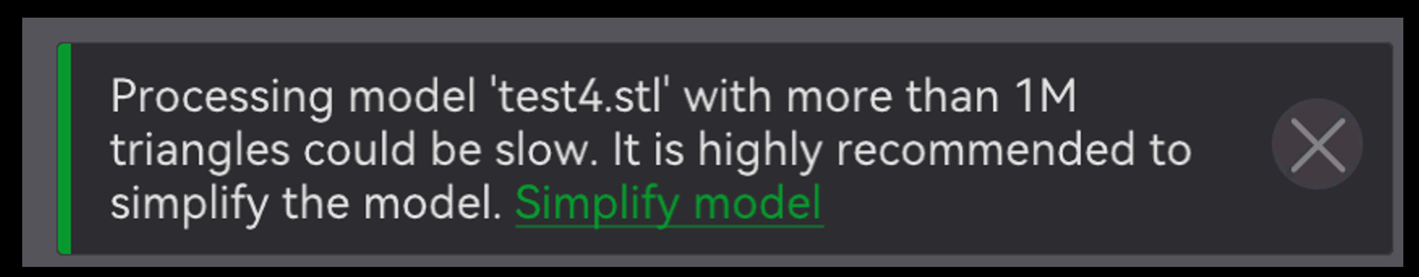

Even Bambu Studio is already displaying a warning message:
…and we’re only talking about three simple spheres here:

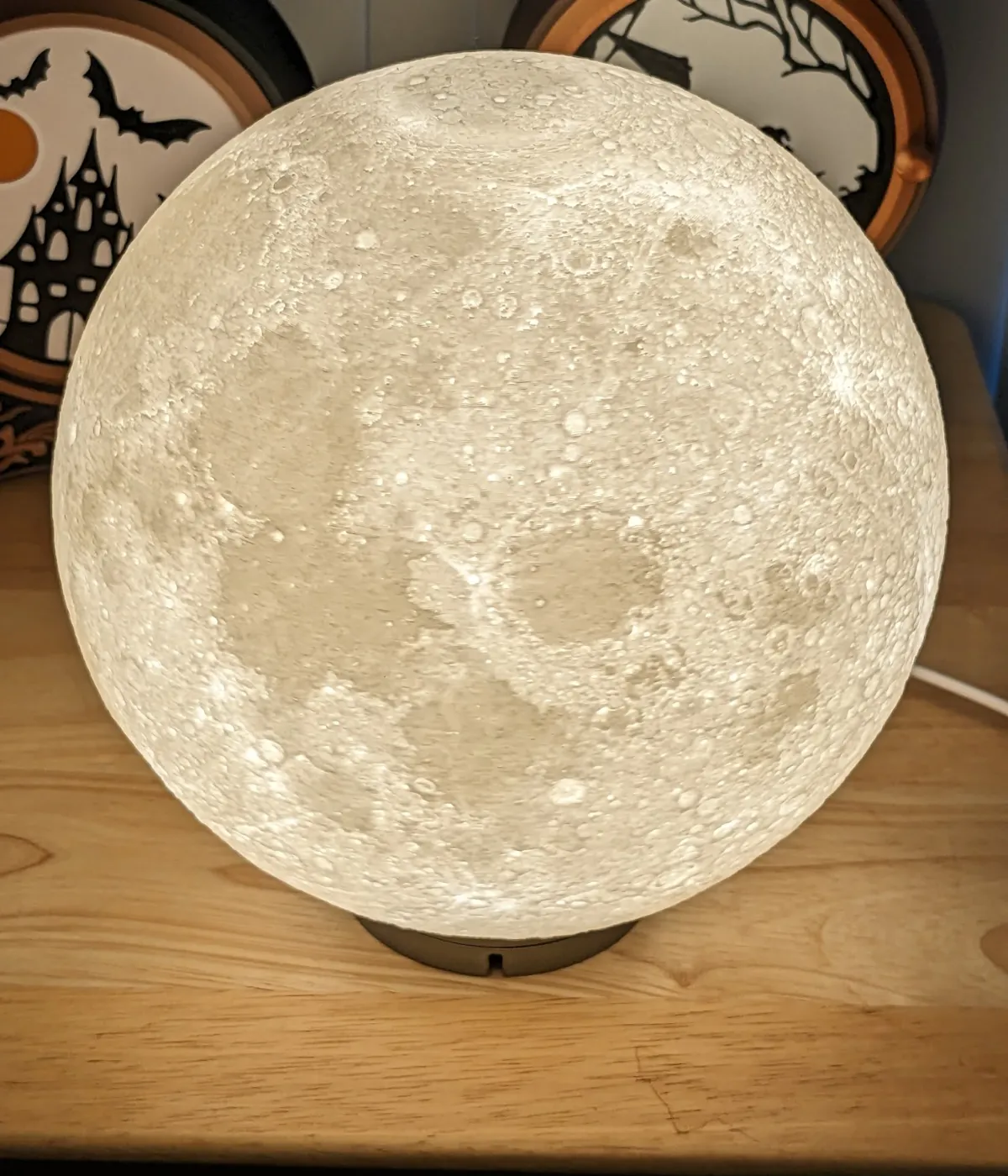

I took a look at how others do it and came across this lamp. It works just fine without any support - and it’s completely hollow inside. Maybe you could take some settings and ideas from it:
Thanks for the thought! Something I’ve also tried is meshmixer, and i’m pretty sure the thickness is even, but once its in the slicer I get the same, i’m really just wanting it to treat it like a wall loop and not infill. As for CAD, I’m looking for an organic looking egg shape and haven’t been successful. I think with the moon globe the problem i have kind of plays to their advantage, their texture kind of hides away those darkened areas/swirls… at one point I tried adding more surface texture but I don’t think I did it well/naturally. I think I might have to just be satisfied with the dark halos near the top :sob: .
