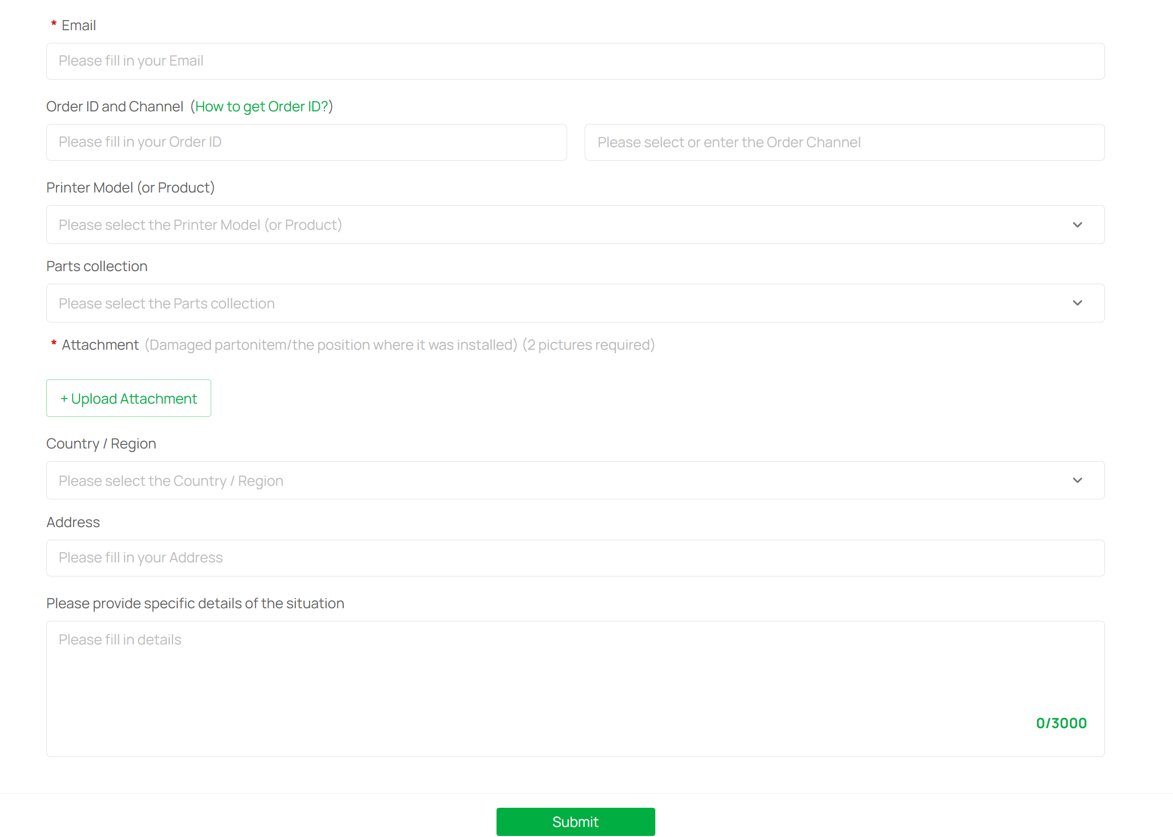

I may have missed it, but if you want parts ahead of time why not just order them?
This is a purchase request. You have to have an actual damage first (see the upload 2 pictures part) before they will ship it to you. Its the same as making a warranty ticket. I guess this route works if your product is out of warranty, but its not like you can buy it ahead of time to have on deck when the lead screw breaks again. They are forcing you to wait for it to break, have printer downtime, then submit a request to get a new part (that you have to pay $60 for btw).
Well darn, thats not really my deffinetion of “Spare Parts”
