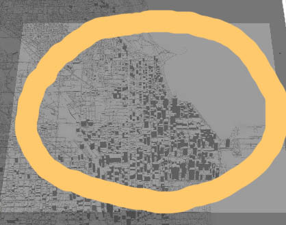

Do you mean something like this?
This is the square, light part. I want to keep the area inside the yellow circle. Everything outside the circle is to be deleted.

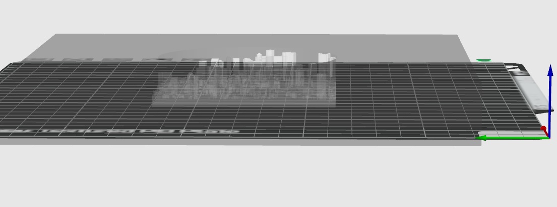

Start a new project, add a primitive “cube”, scale it larger than the model in all directions.
Add a negative part, primitive cylinder in the center.
Export as “hole.stl”, this is your cutting tool.
Load your model as a new project.
Add a negative part, Load “hole.stl” as a negative part and position as desired.

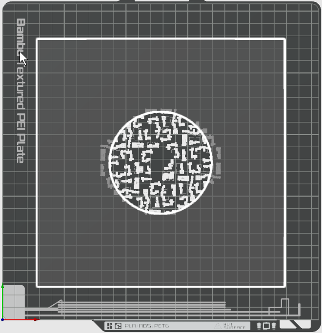

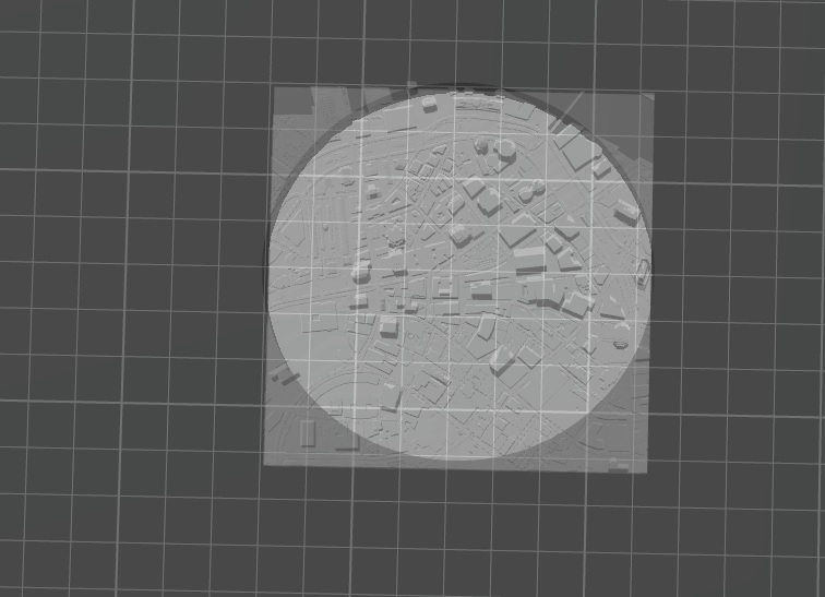

Not sure I did this correctly. Are the corners still part of this round model??
The corners should disappear after slicing.
So something is wrong then, that the corners are still there after slicing (the black areas)?
Try making the X and Y longer. It will toss the excess so it doesn’t need to be so close. Tack on 5mm on X and Y and then slice. Z also needs to be taller than the tallest building.

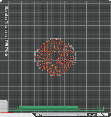

Yeah, I’m seeing the same problem in OrcaSlicer. Add Negative Part>Load… hole.stl is not being treated as a negative object.
Right-click on hole.stl, Change Type, make it a Negative part, slice.
Now the question is… why did Loading a .stl as a Negative work for me earlier?

Still not working. Seems it is indeed a negative part when imported. Change type does nothing.
Earlier I was testing in Studio, not OrcaSlicer.

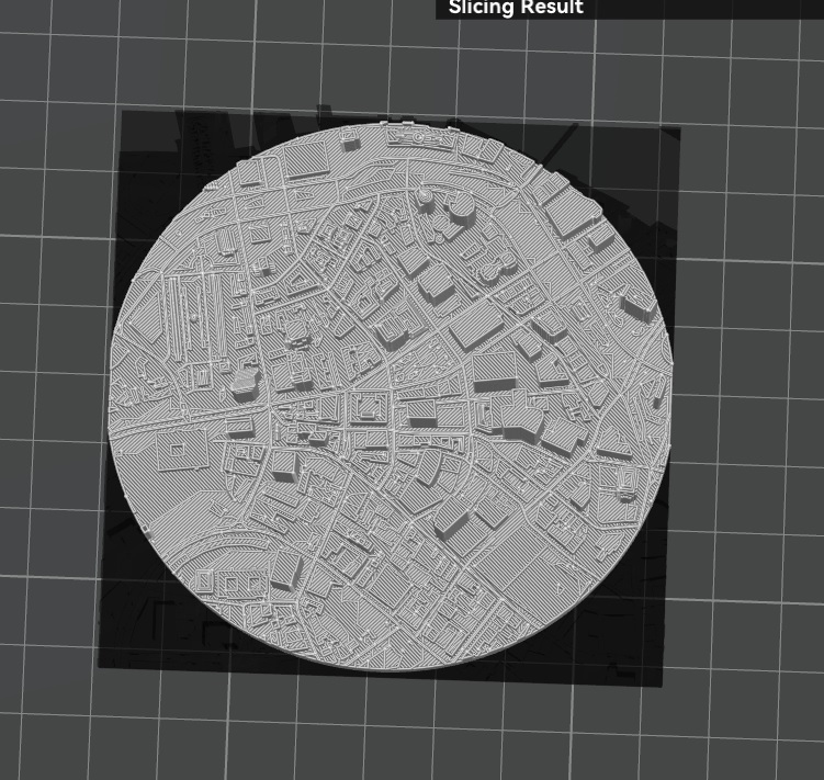

Studio, Prepare:
Studio,Preview does not show “corners”. In Line Type display, Preview still shows buildings “grayed out” outside the hole, but those do not actually print.
And now when I try again in Orca, the hole loads and slices as a negative part, as it should.
