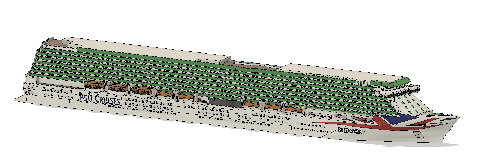

Next model starting to take shape.

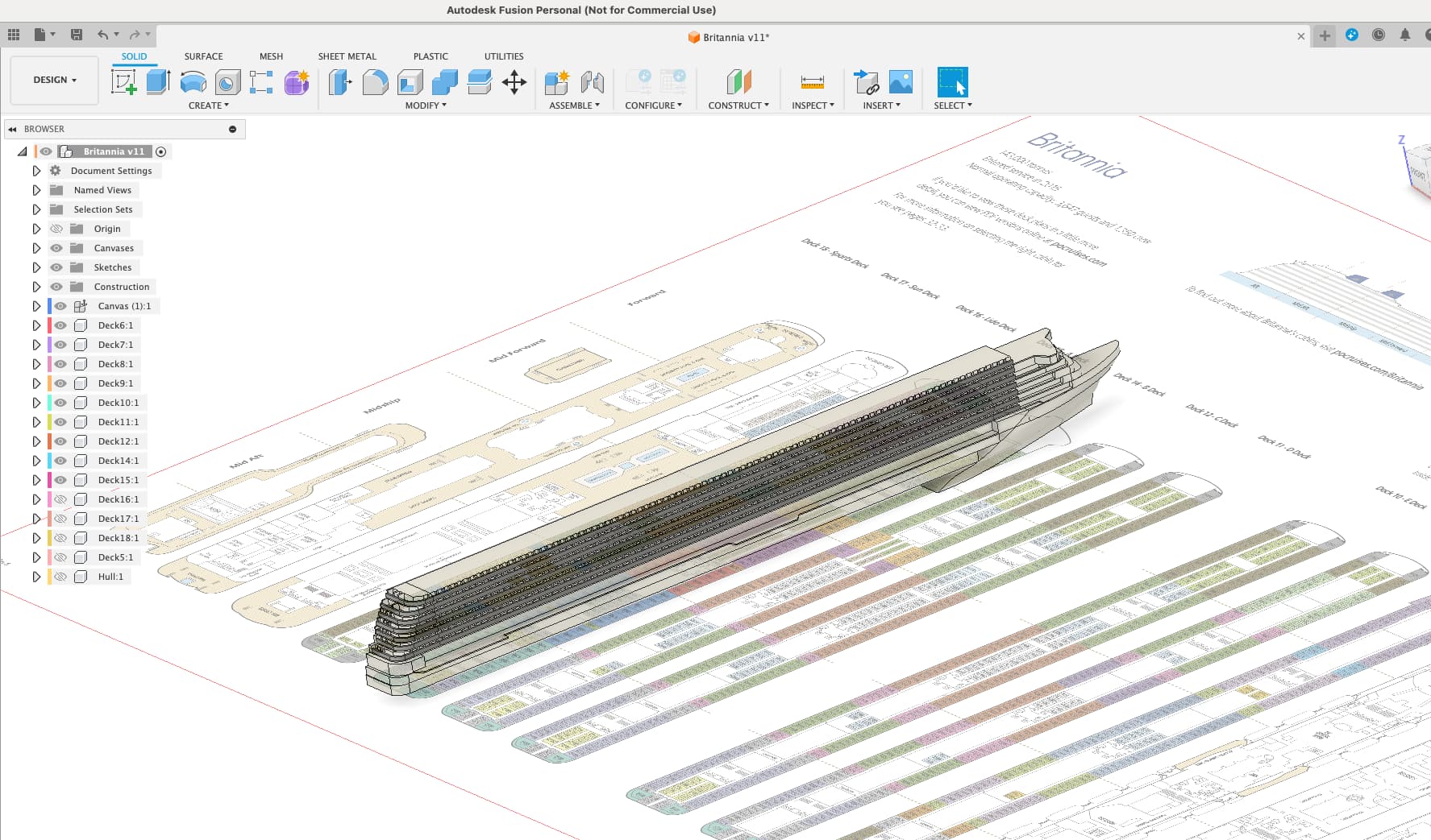

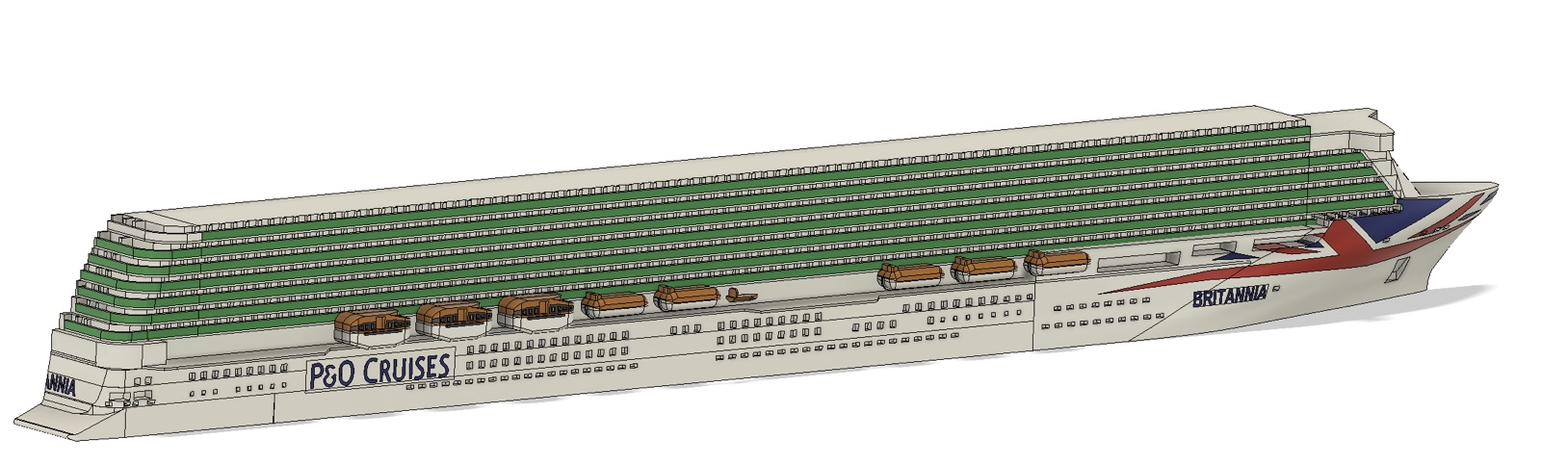

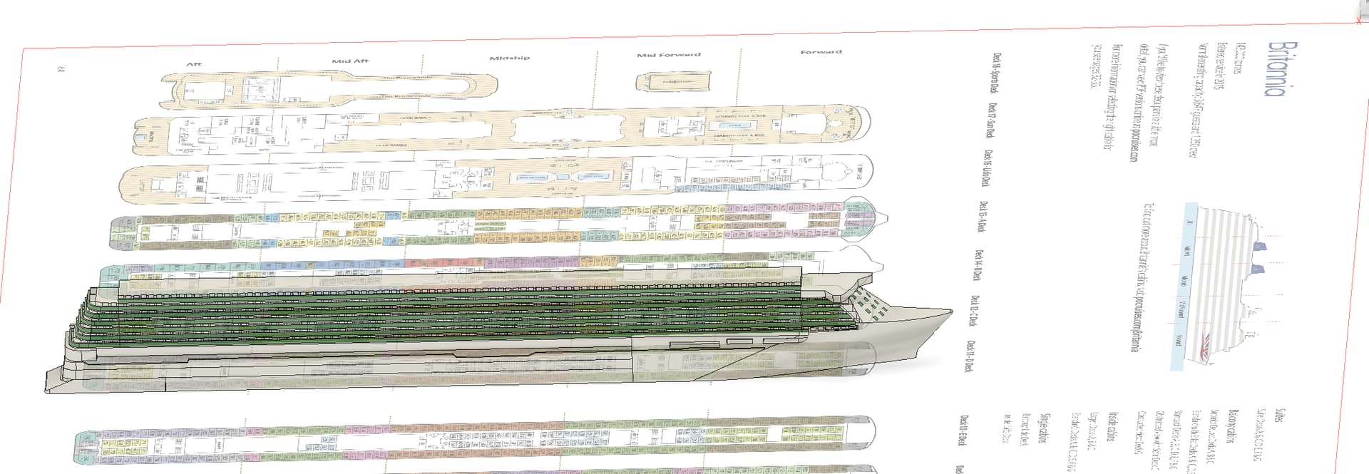

This time the starting point was a PNG 300dpi export of the PDF deck plan canvas in its own F360 component, which was then copied once per deck with the copied component moved to the correct position. That way it is pretty easy to switch the canvas to line up with the deck being modelled.
So far a single screenshot of a side view then used to get the basic dimensions.

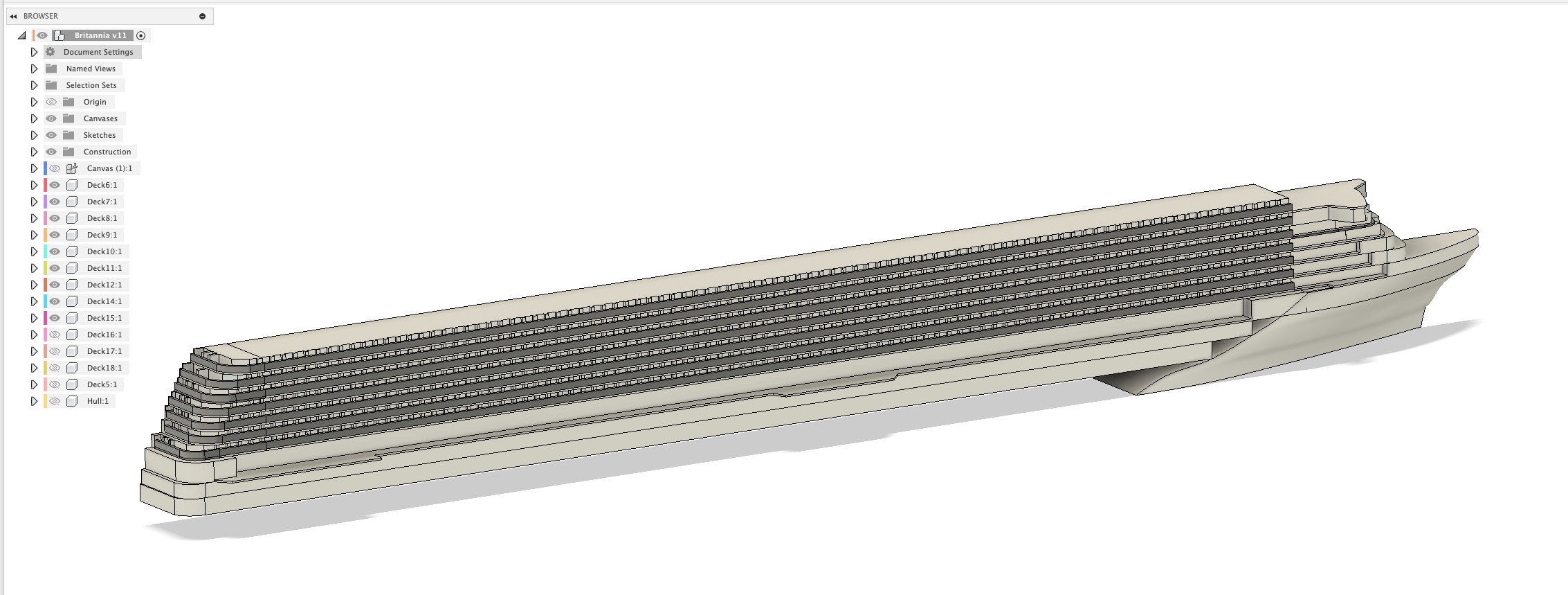

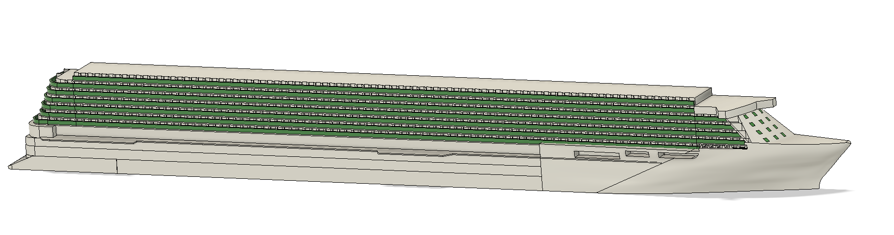

Front part of Hull and single loft going through 6 sketches up to deck8 - needs to smoothing out.
update 19/5 - Further good progress on day 3 - Hull share more or less there. Bow a big loft through about 8 sketches.

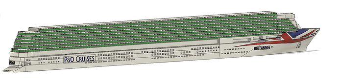

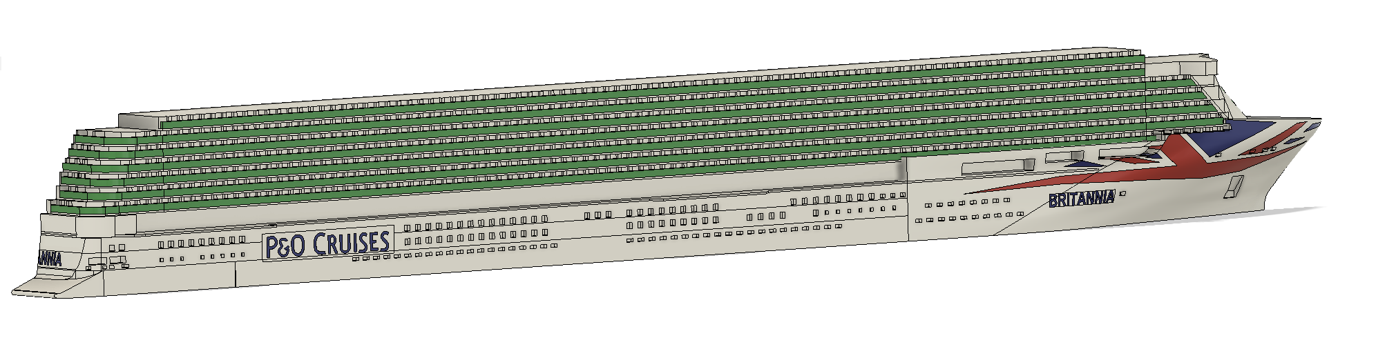

update 20/5 - day 4 - hull side windows, flag and text
Update 21/5 - day 5 - lifeboats
Update 22/6 - day6 - Bridge + Deck16
