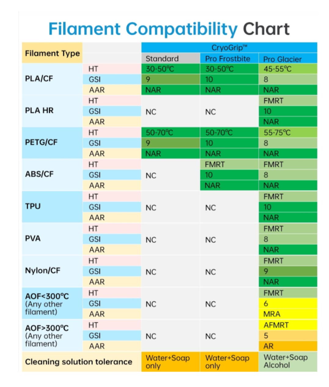

The point of frostbite is, among other things, that you need significantly less temperature and therefore save energy. 65° seems a bit much to me. Have you checked out what BIQU recommends?

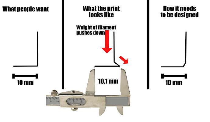

Besides, elephant foot is often an issue with the 3D model itself rather than the printer, because the designer failed to take this into account when adjusting the bottom edges. This can always happen due to the physics and weight of the filament.
The weight of the filament always pushes downwards. I made a diagram about it:
