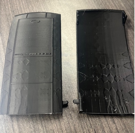

I’m printing this curved door with the door standing upright with tree supports and it’s printing with these circular like depressions at the bottom.
Model: PS1 using PLA Basic
Settings: Mostly default using quality set to 0
File:
Slave1 Ramp Use This One.3mf (145.7 KB)
I tried some other settings like ironing, haven’t tried re-orienting but when I lay the part down there are other issues in the slice that come up. Any help or advice is appreciated.

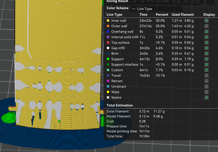

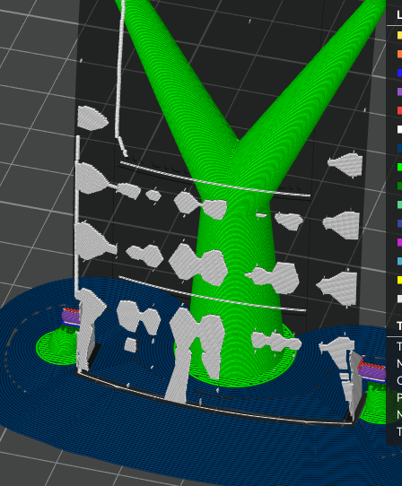

So I found this when looking at the inner wall, those “holes” are what is showing up. But I’m not sure how to fix this.
Malc, just posted below with a picture of the inner wall which is creating these “holes” but not sure how to fix this in the file.
Here is a better picture of the actual print
The gap infill is what is showing, but not sure why this print file didn’t have just the straight layer walls across. I bought this file on Cults as a replacement door for my Slave1 Star Wars ship.
I adjusted from classic to archane and that removed the gaps so trying that now, will see if that works as the gaps are gone in the slice.
It looks like the issue is part of the design.
If archane solves the problem, excellent, otherwise you may need to speak to the person who designed it to fix the shallow surfaces.
It looks like the archane did solve the issue however now on the model lines within the print they aren’t as defined specifically on the left side of the print near my finger. The rectangular raised outline on the right is ok but on the left it jittered meaning low then high then low
Arachne can only fix so much, the source model needs to be corrected.
