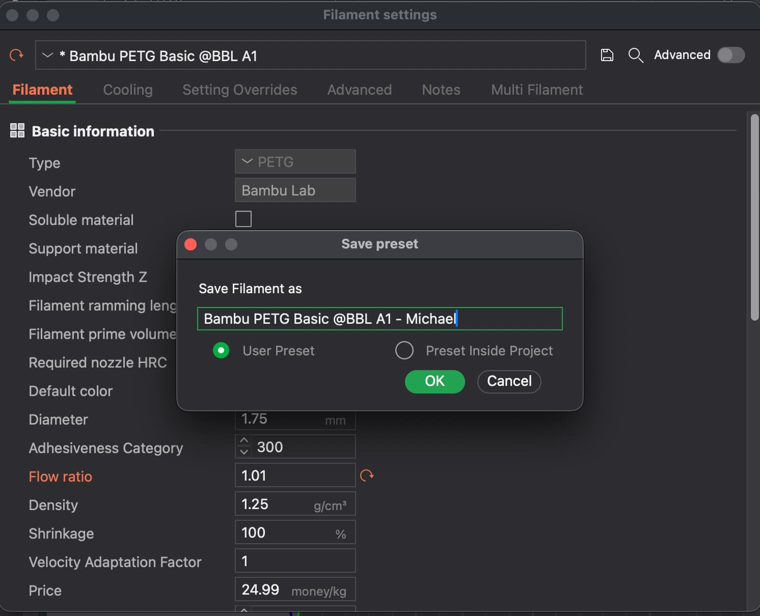

Custom filament G-code - filament won't save as user preset
Problem
If I make a new filament preset and save it, it persists if I close BambuStudio and re-open it.
If I do the same and add custom G-code, save it, and then close and re-open BambuStudio then the preset disappears.
Screenshots
I edit the filament and change one value (flow ratio) and save it.
Close and re-open BambuStudio, and can see saved filament:
Edit filament and add custom g-code, and save:
BambuStudio still open, can see filament:
Now close and re-open BambuStudio, filament has disappeared:
The custom g-code is:
