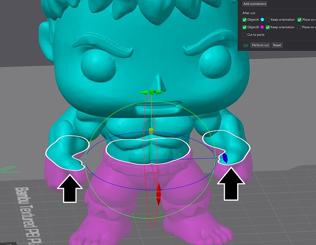

hello,im trying to cut this model in half(torso-legs),as you can see hand pieces have been selected,i know about selective cuts with right click,but when i do that,the hole upper body is selected,any fix?thnx

to only cut the legs off,not the hands,at the waist line

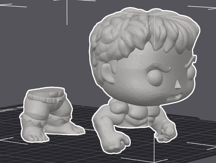

If you right click the hands, that’ll remove them from the waist/leg cut and leave them attached to the top.
Like this.
i knew that you had to click on the individual part(white circled),but what do you know…!it worked,thnx for the comment brother

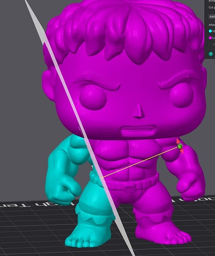

wish it could work like that want you want to cut the arm and nothing more,but still helpful
