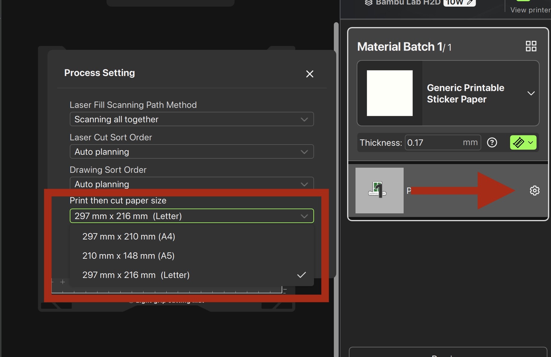

There is also the issue of print sizing. The layout defaults to A4, but I have 8.5x11 vinyl sticker paper. I have to print A4 size onto the 8.5x11, if that makes sense. I have to tell the printer it has A4 paper loaded, even though it doesn’t. This results in me losing some of the working width of my sheet and having to be cognizant that I don’t have the full length shown in the preview to work with. Why can’t I just change the template to 8.5x11, or any size of paper I may have that will fit for that matter?

I had the same issue. You need to change the paper size in the Print Then Cut settings first before printing and also make sure your printer is printing in Letter Size.
You can change the paper size over here:

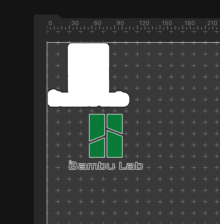

I also had a bug where I turn an item into a sticker and in the next prepare stage the stickers white outline is beside the graphic instead of underneath it. They need to do a lot of work to fix Bambu Suite.
Just as an FYI, the letter size setting has a typo. I believe it should be 279mm, not 297. That was what originally threw me off when looking to change the size. I can confirm the letter size works with US 8.5"x11" paper.

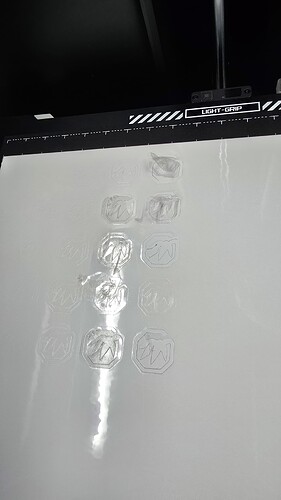

I bought some sticker paper, letter size. Set the settings that are talked about in this thread and I ran a calibration test. The test is supposed to make many cuts and you determine the cut that passed the test and that becomes the settings for that material. Again, reminds me of manually setting up my first layers on older 3d printers
All of my 15 cuts they make for the calibration pass failed.
I then measured the thickness of the sticker paper, it said .192mm, the default is .17mm. I changed it to .18 (didn’t want to upset things too quickly) and ran another calibration, same results.

As far as the registration marks not lining up on the paper, the software defaults to an A4 size. If you print on 8.5x11 you may run into that issue (I did). If you scroll up in this thread, another user showed how to change that in the prepare tab. You want to switch it to Letter if you are using 8.5x11. There is a typo in the metric dimensions listed in the Letter description, but it works correctly.
Here are the calibration results I ran on the sticker paper
hard to see with the glare but the first two columns don’t cut enough, then the last 3 columns cut enough, but none of the cuts looks correct. When I peel the paper off of the plate, it tears, none really stick correctly.
I should try some matt paper to eliminate the glare as an issue, this paper is pretty shiny.
I’m not a fan at all of the design they chose for the calibration template. It is WAY more intricate and complicated than 99% of my cuts. I get that it may make sense to dial in on a worse case scenario, but I had the same results as you. Even cuts that I knew were too much pressure and leaving visible marks on the cutting surface still didn’t come away cleanly. I’d much rather the option for a simple calibration with 2 cm squares. I basically ended up doing my own manual pressure calibration using squares and varying the pressure or number of passes with each job until I found settings that worked well for me. Right now I’m at 190gF pressure and 3 passes using vinyl sticker paper with matte laminate on top.
