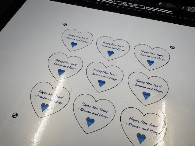

While trying to cut out some shapes on sticker paper today, I keep getting an error that says The cutting blade offset calibration failed…
I’ve used the cutting tool once before and it worked flawlessly with the same kind of print and cut project.
I have tried 6 or 7 times to no avail and have redone the mounting and offset calibration multiple times. The printer doesn’t fail the offset calibration when I manually select it through the menus just when it tries to calibrate before a cut job.
I do get a warning after the cutter makes the two x and y cuts near the alignment marker that asks me to check to see if the paper has been cut all the way through. I check and it has, but then I get the failed offset calibration error.
Once it starts the cut, it is off in both the x and y direction. Well the last one I did was only off in the y direction.
I’m at a loss at this point and have no idea what to try next.

Okay I figured out the issue after a couple hours of messing around. The setting for paper size was set to A4 instead of letter. Ofc I was using letter size.
Had no idea that this would affect the alignment as the printout has the damn registration marks on it regardless of the paper size…
I would recommend putting some Amazon Basics matte tape over the four target points. Also make sure the tape is on the bottom-left target and in the area where the cutter makes the two cut marks, as the camera needs to see the cuts clearly. Make sure the edge of the tape isn’t in the same place as the cut line, as this can cause a visual error.
The problem is the glossy finish on the sticker paper — which I can see you’re using in this case — as it reflects the camera light and causes glare. Matte sticker paper doesn’t usually do this in my experience, but putting matte tape over the targets limits the reflections and lets the camera see them properly… well, at least 90% of the time — nothing’s perfect.

Sorry to necro this thread but I did a lot of reading about this just yesterday. In bambu suite, under preferences, you can turn on expert mode. When you do, under cutting you’ll now have a lot more control over the tool. In this case the reason it keeps complaining about making sure the blade is sharp is it truly expects to cut through the paper during it’s initial cut task calibration cuts. It makes these cuts through an independent setting called “Cut Through Pressure”. Regardless of how you have your actual cut setup, Bambu Studio looks at the Cut Through Pressure parameter for it’s calibration cuts. In the absence of that number (which is 0 by default on a custom material) it will use the cut pressure but not the number of passes.
From what I can tell, if it doesn’t cut deep enough it can’t see, or validate the lines and does exactly what it did to your cuts.
I leave for work tomorrow and can’t do any more experimenting for a week, but if you start adjusting that cut through pressure upwards I bet you’ll get it to work right. I know in my case I can cut just fine on normal paper with normal settings, but when I switch over to stickers I get that exact same issue… quite maddening tbh.
I’ll update here when I get back in a week and can continue meddling with the settings.
I managed to get this working by increasing the cut-through pressure from the default setting of 0, which is actually 288 gF, to 350 gF. Even then, it was not completely reliable. Sometimes the task failed during the initial calibration cuts, and I had to start it and cancel it before trying again. Other times, it worked on the first try. I suspect that increasing the pressure even further might make it more reliable on the first attempt.

In my project, I selected the Bambu Lab sticker paper preset. With that preset, cuts were perfectly aligned when the objects were printed on plain printer paper. However, as soon as I used an actual sheet of Bambu Lab sticker paper, I got the “Cutting Offset Calibration Failed” error. If I tapped “Ignore and Continue,” the cuts around the objects were misaligned, which the error message did warn could happen.
At this point, it seems pretty clear that the problem lies with the two calibration cuts performed at the start of the task. It is disappointing that the stock settings for Bambu Lab sticker paper appear to be so far off.
