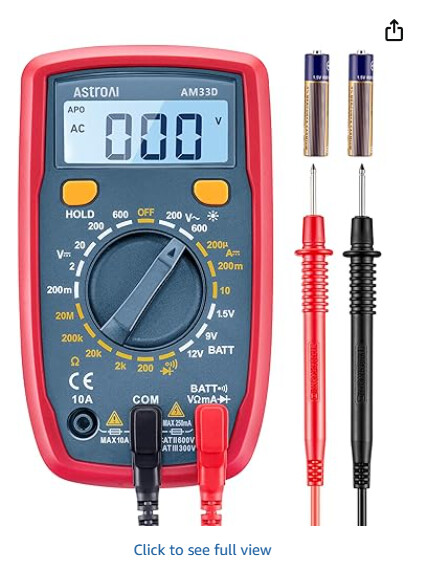

A digital multimeter is all you need. If you don’t own one, you could by tomorrow for less than $20 off Amazon or by taking a run to your local home improvement store. You don’t need an expensive, precision instrument like a Fluke multimeter. For this, high accuracy isn’t necessary. Even a cheap meter will be good to 1/10ths of a Volt and that’s enough to tell if the pack is charged or discharged or dead… :slight_smile:

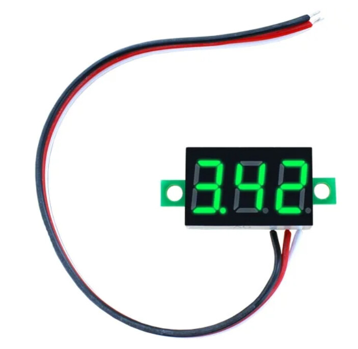

Something like this is about as cheap as you can go. I have some of these, I use for voltage readouts on portable electronic equipment I build. Less than $2.
Or, if you want an instrument that’s good for more than just displaying voltage, something like this can be had for the <$20 I mentioned earlier…

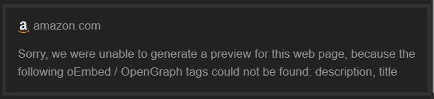

The forum does not appear to want to let me embed any links. When I do, I get this error:
Both of these items were found with a google for “digital volt meter”.

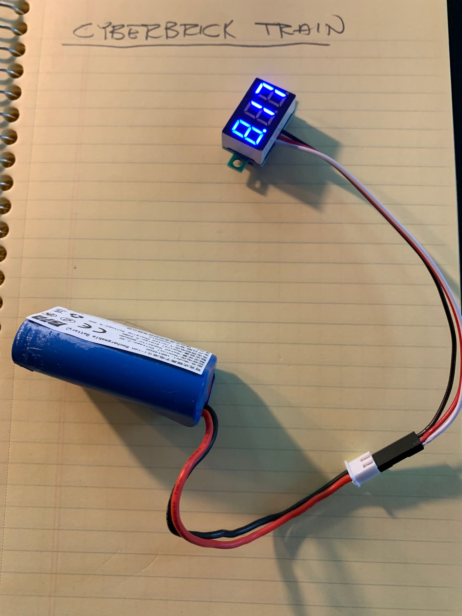

I have been using this volt/amp meter in many of my builds to monitor the battery voltage. simular to the one rocketsled posted. You could splice or wire this meter into the battery circuit if you want. Also, this is a 2 cell battery wired in series to get the 8+ volts, you can tell by it’s shape and if there is a balance circuit build in it is not wired for an external balance meter like designrama was using. There will need to be a three wire balancing plug as part of the circuit.
Just be sure to install the meter on the side of the connection that goes to the Cyberbrick stuff. If you permanently install it on the battery side, so that it’s still connected to the battery when the battery isn’t connected to the Cyberbrick, the meter will discharge (albeit slowly) the battery.
Measuring voltage draws miniscule amounts of power from whatever’s being measured, you’d be hard pressed to detect it even with expensive equipment. But the little microchip that converts the analog measurement to digital, and the LED displays themselves, draw a fair amount of power.
But yeah, those things can be had cheap and they work surprisingly well. I put them in to my battery powered builds all the time.
They come in a few other colors; yellow, red, green.
A couple of examples.
