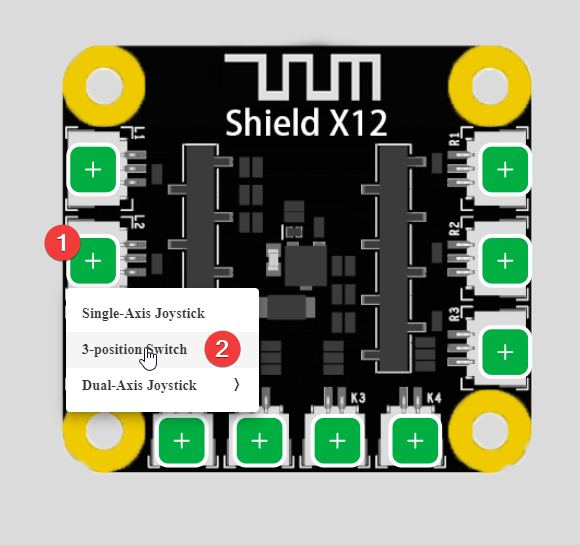

is there a way i could setup 1 remote for multiple RC ? thanks guys :slight_smile:
Yes, you can configure 1 transmitter to control 2 receivers. You must first set up your transmitter with a three-way switch input. Then add two receivers. On adding the second receiver you’ll have an option to select either “Switched Control” or “Synced Control”. Select Switched Control and you’ll be promoted to select which switch input controls the mode.

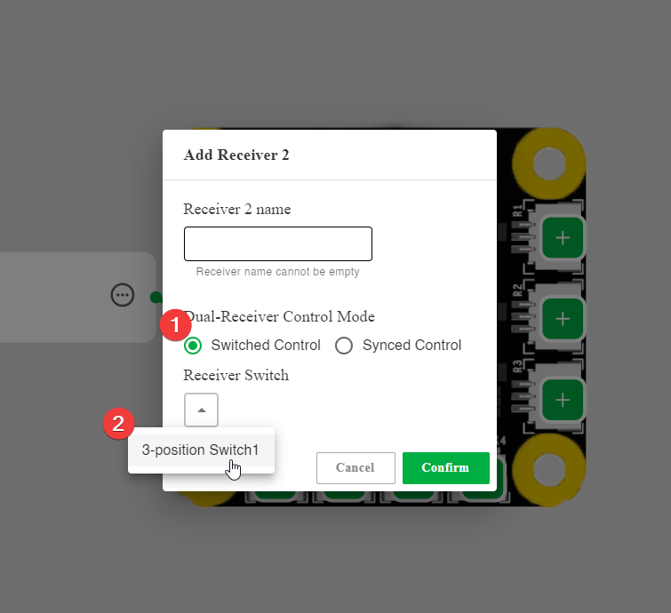

I literally provided a screenshot. I can provide more
Add a 3 pos switch
Add a receiver
Add another receiver
Set the receiver to Switched Control
Select the 3 pos switch
thank you very much :slight_smile: i really appreciat it
if i used synced control does that mean it will switch automaticly to the other car ? or does that mean it will make both work at the same time ? thanks
Yes, you can control both models, ie forklift and truck at same time. Left joystick the forklift and right the truck.
