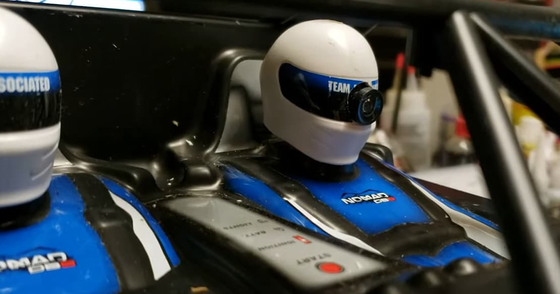

I have a RC race truck I built for “FPV” (I drive it using a camera in the truck, wearing goggles so I can see what the camera is seeing. Same transmitter I use for my airplanes and helis and drones, where I get a few miles of range easily. On uneven ground, that’s reduced to a few 100 feet.
The helmet is attached to an RC servo so I can swivel the head left/right as I drive.
