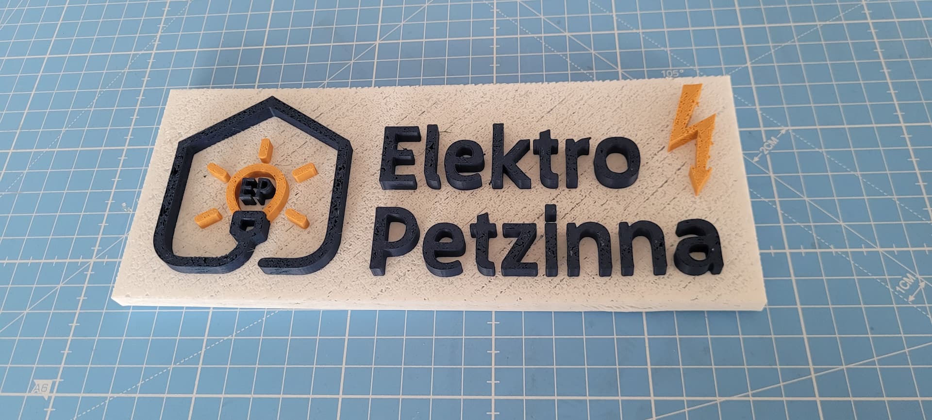

Hello everyone,
Can someone explain this to me?
I am using the default settings of Bambu Studio:
“0.12mm fine @BBL X1C”.
The only thing I have changed is that I have selected “Hilbert Curve” as the surface pattern and not “Monotonic Line”.
But that’s not the mistake, I’m sure.

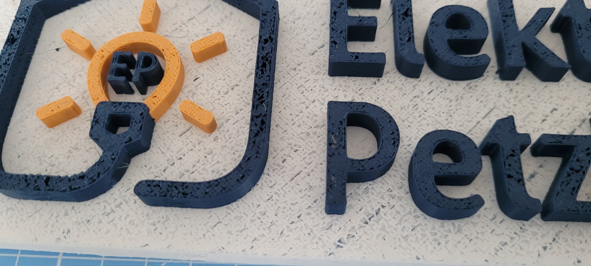

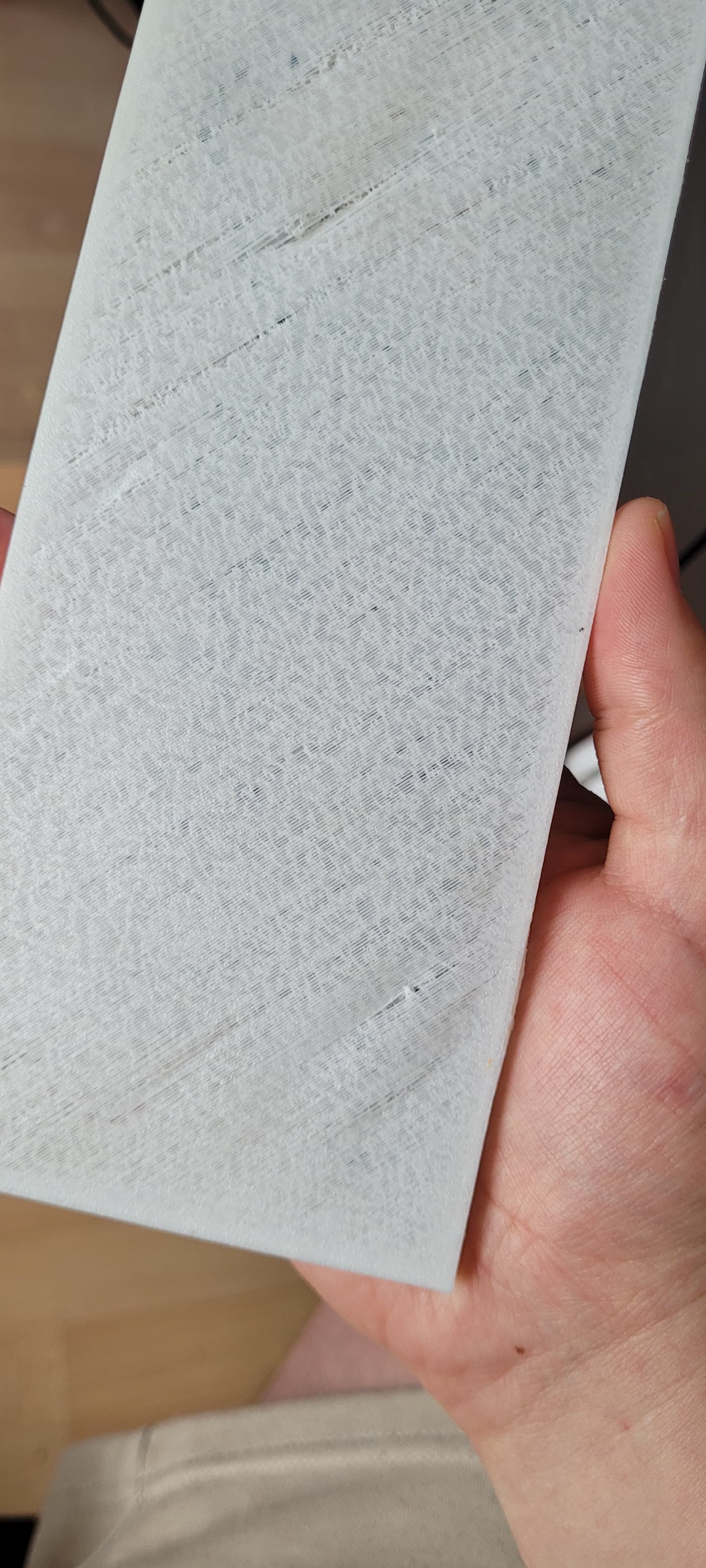

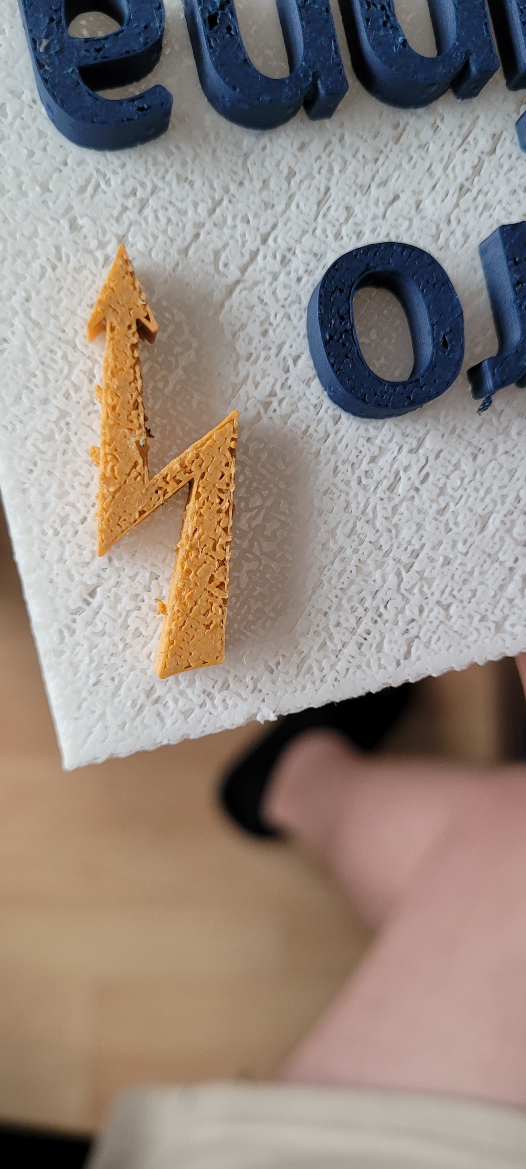

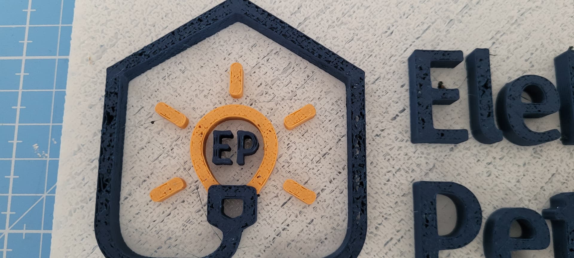

I can’t explain why the surface looks so miserable.
I am using original Bambu PLA filament.
Have any of you had the same problem and can help me?
Thanks :slight_smile:
Check for a nozzle blockage, and/or put that roll of a filament into a filament drier.
However, I am assuming your extruder calibration is correct.
I dried the PLA filament in the oven at 45°C for 4 hours.
But it did not make any difference in the 3D Print.
However, I changed the nozzle.
Now it works. Thank you!! :smiley:
