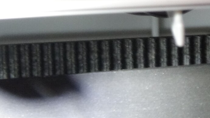

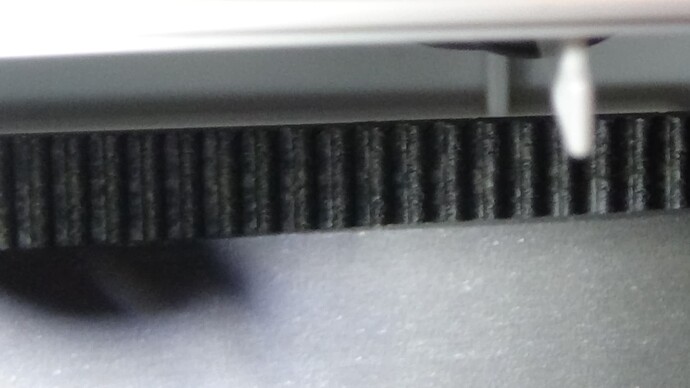

Belt is still quite tight, here are some images but just because a belt doesn’t look worn… doesn’t mean it isn’t when your talking precision stuff.

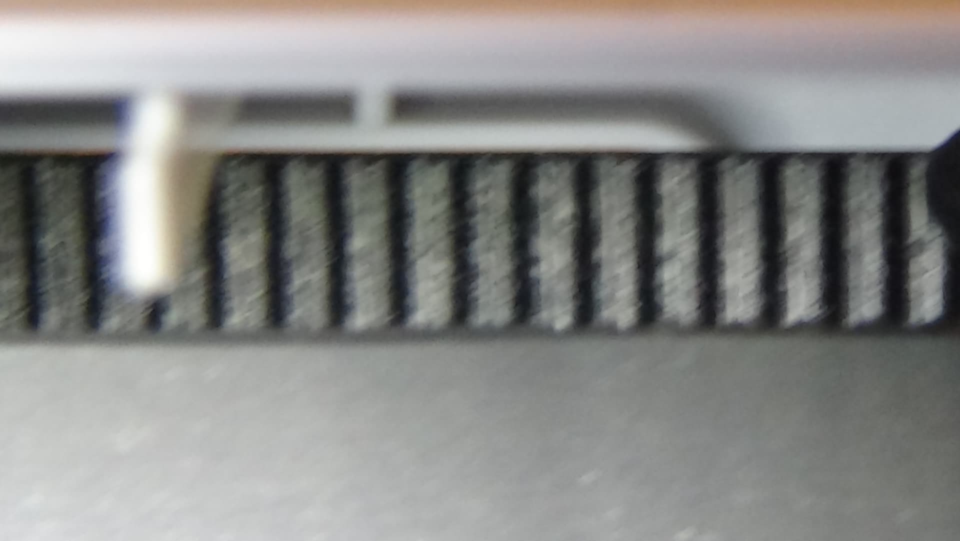

Here lemme get a better one, can’t use my phone for this and have to hold a flashlight at the same time, hard to make my mini cam snap a pic without shacking while pressing:
You can see it here: Definitely chewed er up. only has 500 hours on it.

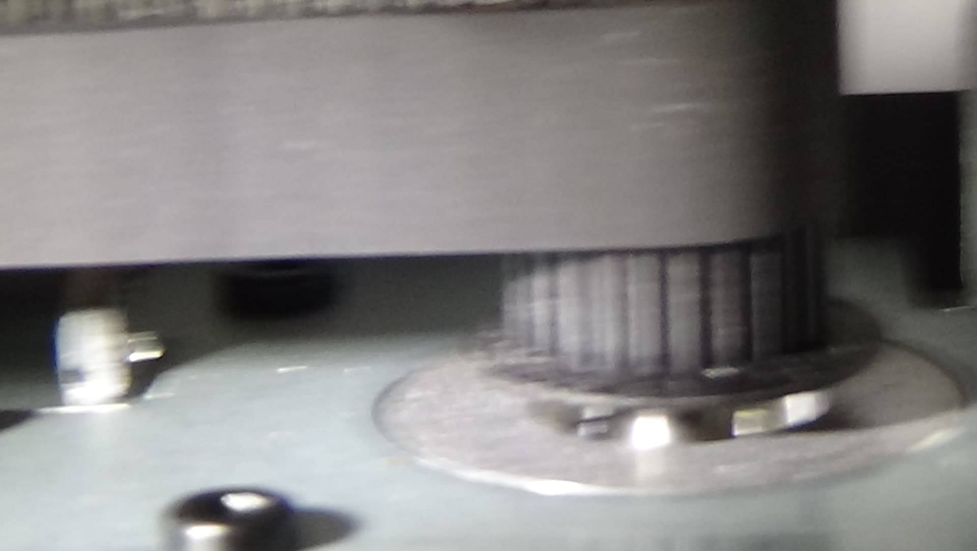

I guess I won’t understand until I get the belt off. I can’t get it off the Y motor pulley theirs still not enough slack.

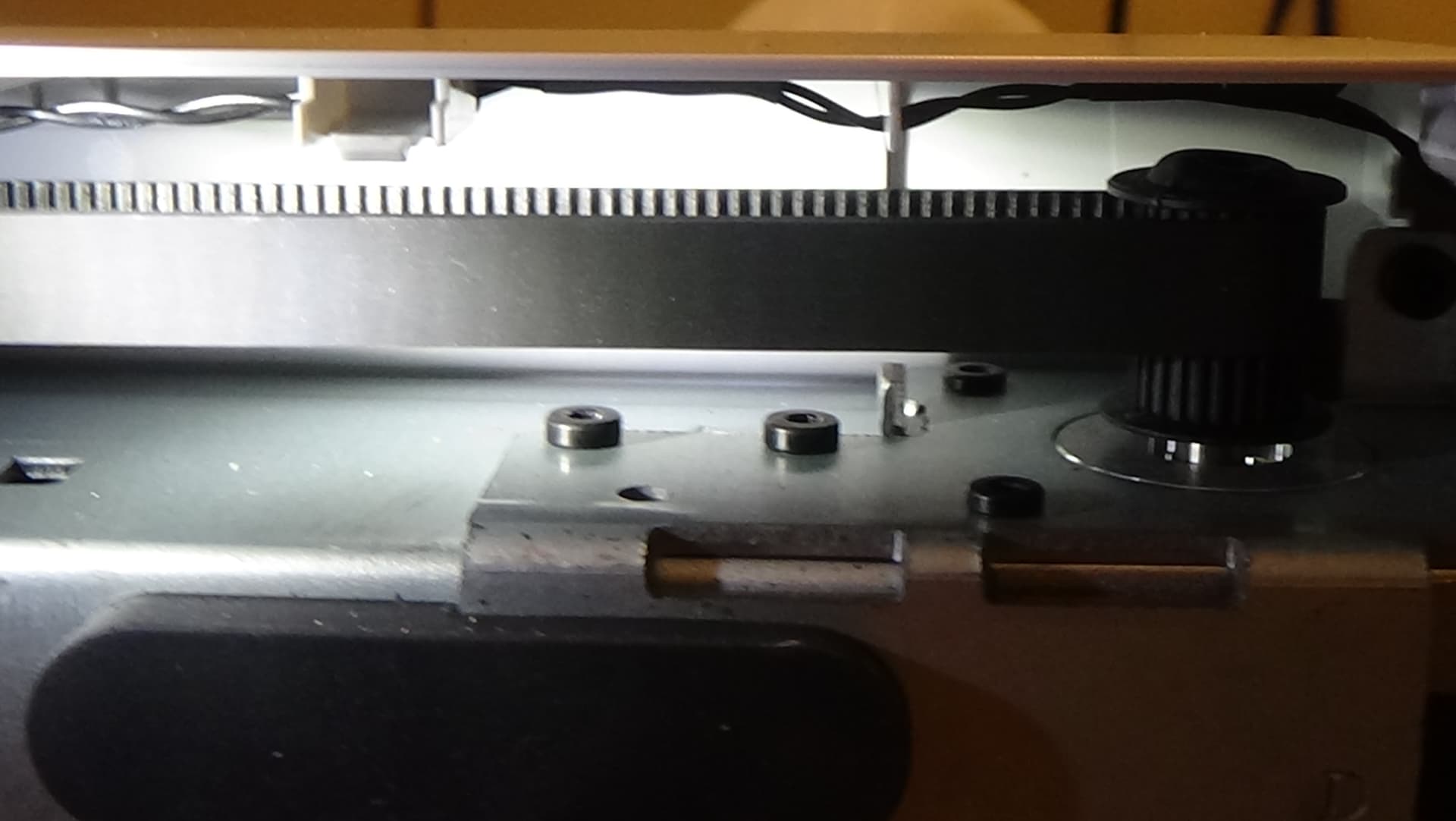

I CANNOT get this belt off… i’m noticing in the instructions this dude has the entire machine disassembled. The whole top is gone…

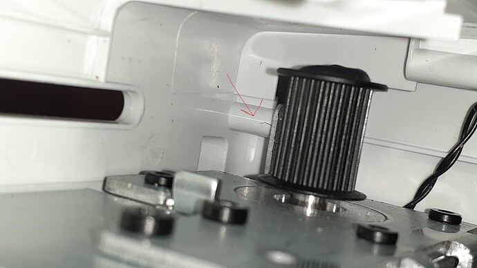

I think I know what the problem is, maybe, possibly:
  • Loosen the Y-axis tensioner screw by one turn. Do not loosen it entirely!
Did you accidentally loosen it completely? If you loosen it completely, it could get stuck and jam?

I loosened it one turn, then a little more. I didn’t loosen it all the way as I have done the tensioning procedure after 500 hours.
There is a TON of slack on the belt, just not enough to get it off yet.

Update: There is NO WAY this belt is coming off, I’m going to end up bending the motor pulley trying to do it, I can get part of it just over the lip but thats it. Tensioner is fully loose and spring is disengaged.
Something else is going to have to be disassembled, either the motor mounts or the tensioner mount… my belt is just too tight to follow the directions.
GOT IT! Wow is that an uncomfortable thing to do… will update possibly with short video on how the new belt goes. I think I know what i’m doing, and I have practice belt I got from work to try gluing them together to get through pulley.
