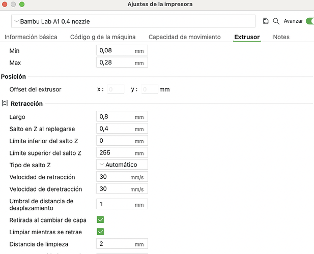

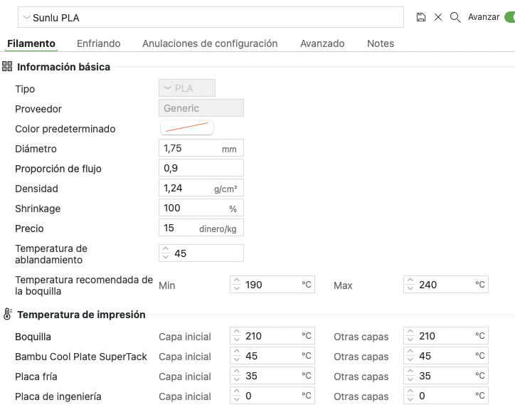

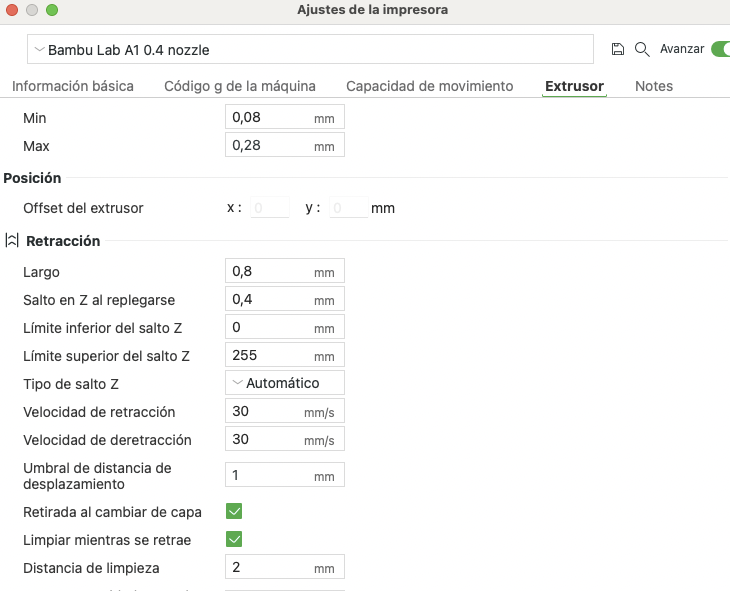

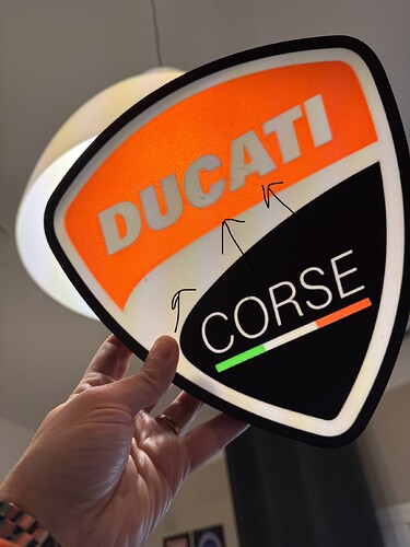

I’m a new user. I tried to print some lamps facedown but I’m having a big problem. Some dark lines or some stains in white zones. I made some retraction tests with great results. I have no idea where the problem is.
Here is my config filament and settings for 0.2mm/0.4 nozzle
Thank you very much!!!

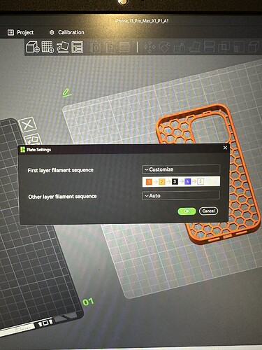

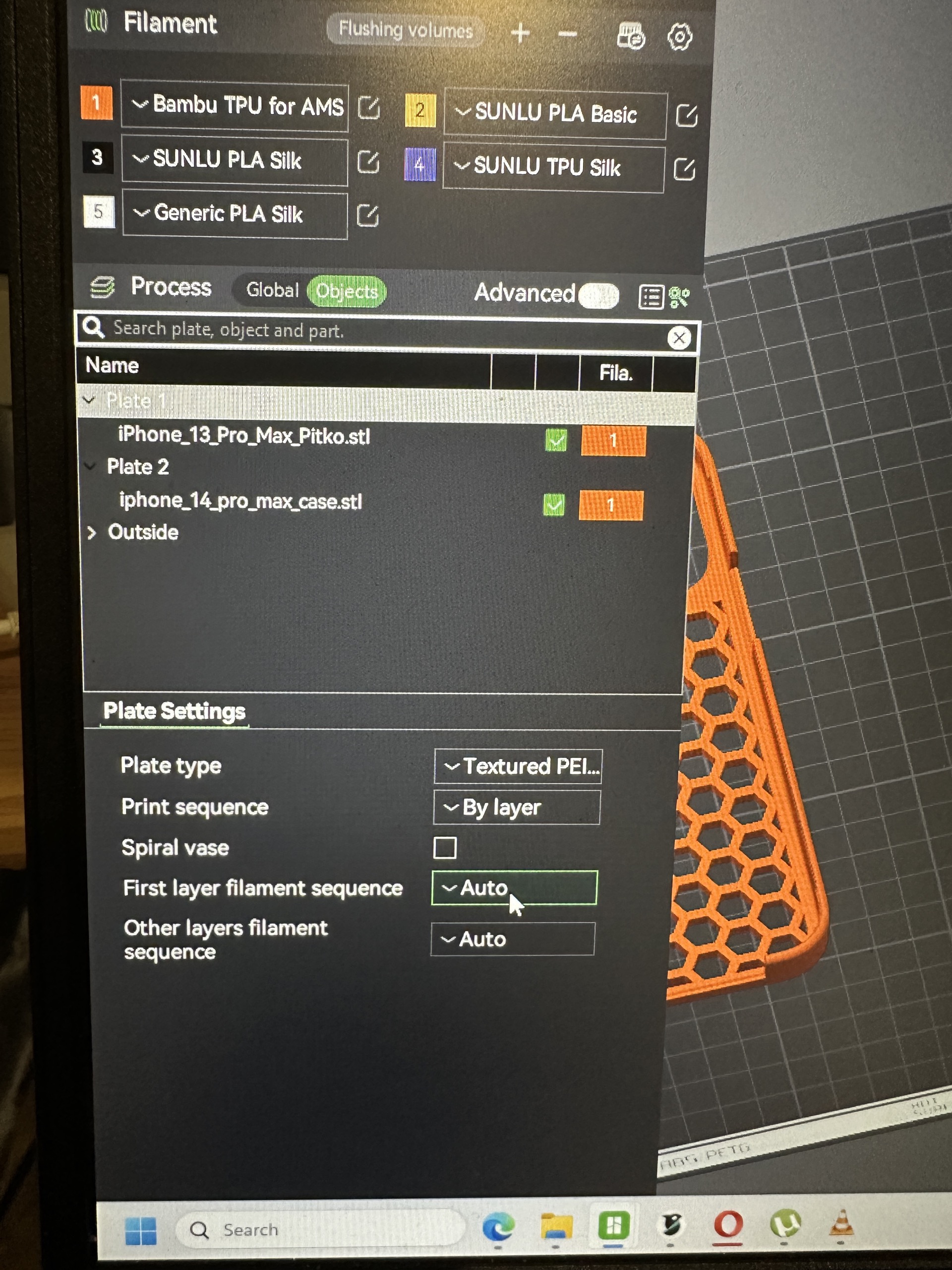

I havent tried this myself but what you need to do is change the colour order in your slicer.
Go to process settings:
Click on plate 1
Click on custom and drag white as the first filament in sequence
Hope it helps
My sequence is always white first, and black second in all layers… this not solve the problem :frowning:

Try changing retraction settings in the filament profile
Could it be stringing? If so you might need to calibrate your temps and filament retraction, especially for the darker colors, and even more so if you are not using Bambu filament.
First impression was something of retraction settings… but my test or retraction is quasi perfect!! I try with some changes of retraction… Thanks!!
Always print light colours first and black last. Lower your printing temps way down to like 208 or so for black, and enable Z-hop, and retraction. That should get you there!
Can u share your config files please?? I need to see the difference with mine.
Thanks!!

Its stringing or tiny wisps of the dark filament which then get blended into the white.

So you started with white on layer 1, but then switch to black and print 2 layers of black - plenty of chance for stringing and particularly small wisps or blobs of black to be created and blown around by the fan (that’s why the black can occur in pure white parts nowhere near black parts of your print).
A tiny spec of black filament sat on white parts will melt right into the white layer when the next white layer is printed. A spec of back melted in will easily show through 3-4 white layers (especially when illuminated) so it’s difficult to get a 100% clean print.

I solve the same problem with the order color printing. It’s magic solution for me
