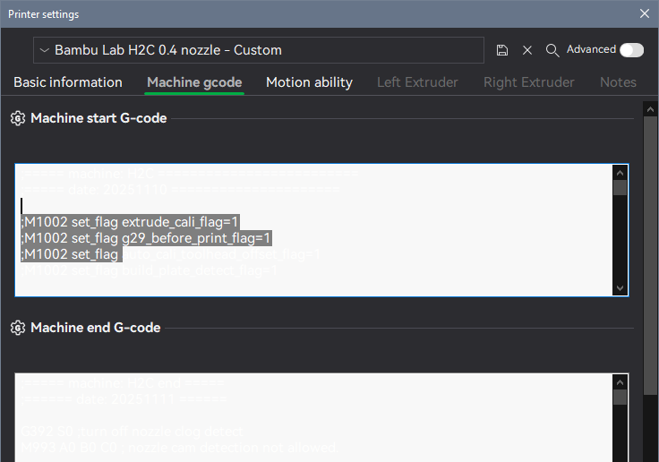

All the g-code editors (I highlighted some text to show it’s actually there):

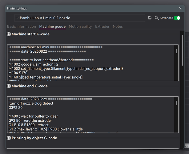

I know this doesn’t help you right now, just posted for comparison purposes. This is how it should look normally:

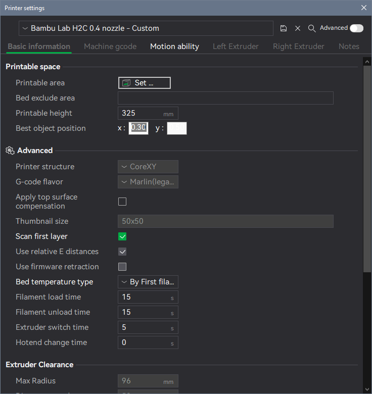

In the Printer Settings dialog for example there are a couple text entry fields with white backgrounds (and white text), although most of them are colored correctly. See the “X” and “Y” fields (one value is selected to highlight it) vs. the other editable fields below, like “Filament load time.”
There are two more like that in each of the Extruder settings tabs, but otherwise this is an anomaly.
Also all the large text boxes are affected, on all UI pages, just like the “Machine gcode” example I posted in the first round. But same with any other box, like in the “Others” property tab (again, text selected so it is visible):
I’ve compared both to the Studio install on my other PC which works correctly, and neither of those issues appears there.
