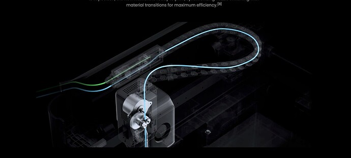

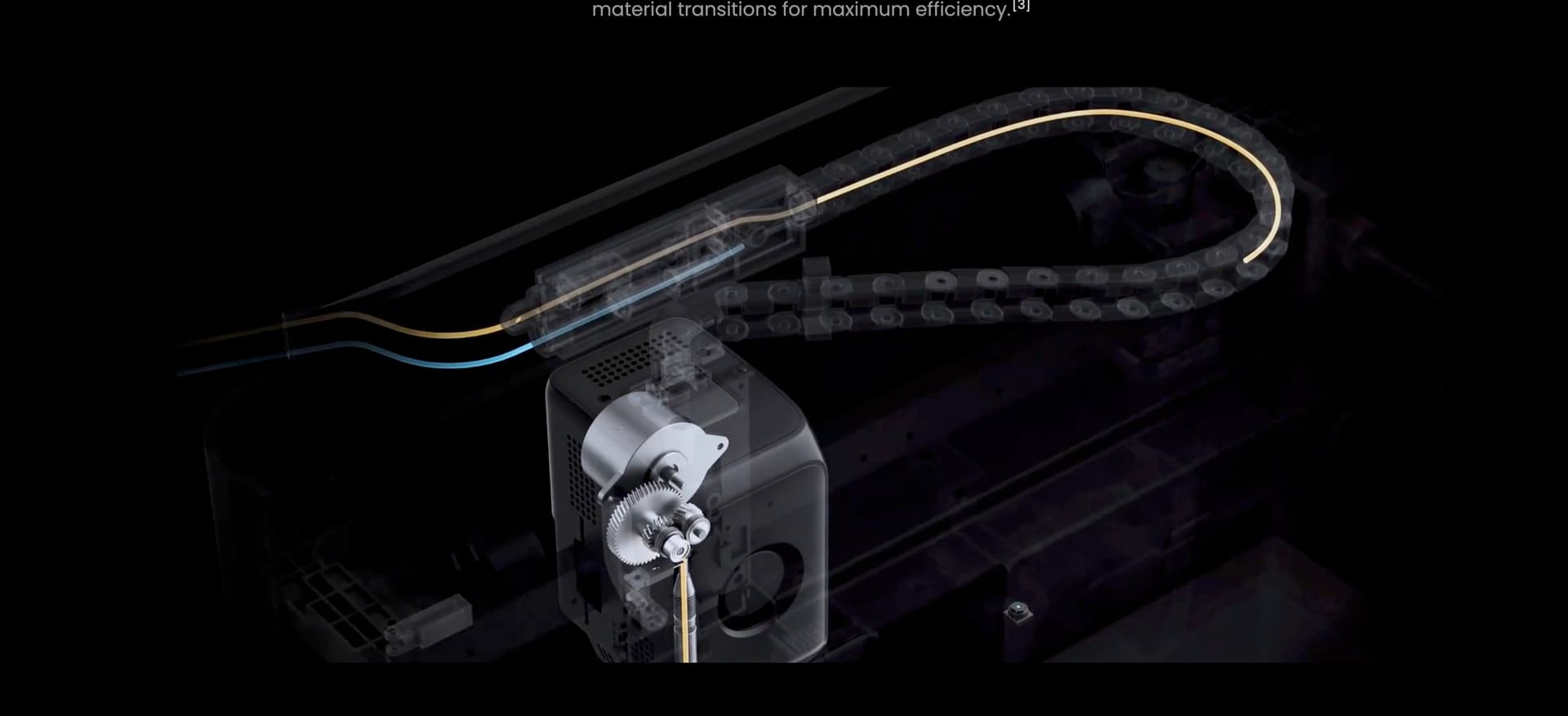

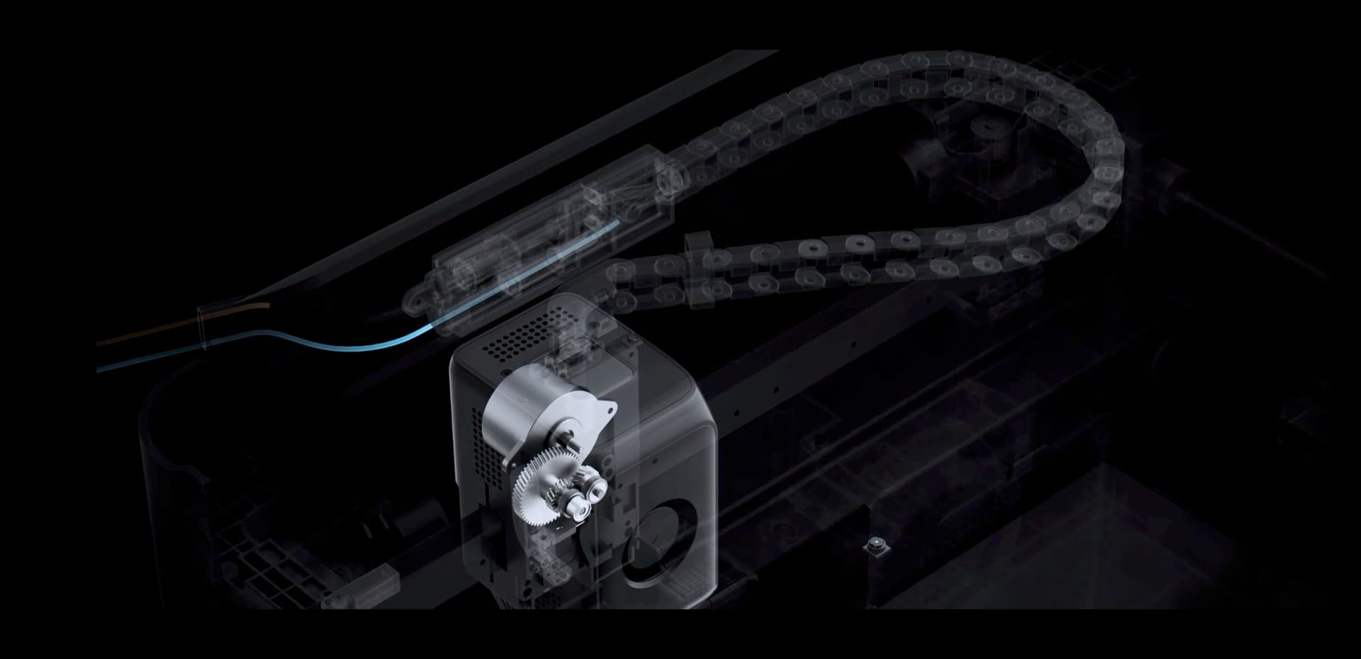

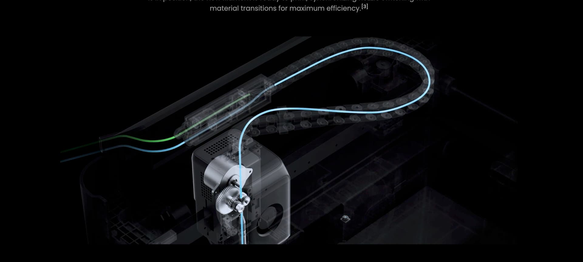

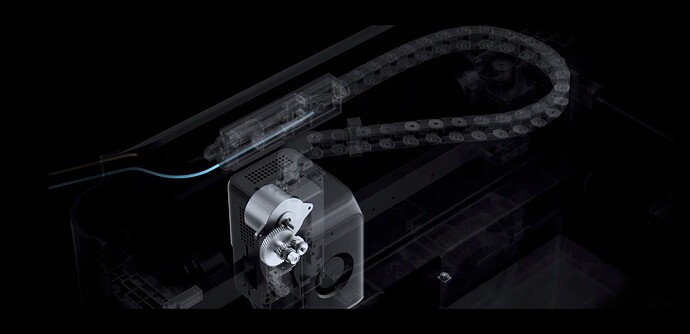

OK so here is one of your competitor’s video, quite impressive:
In case that the video cannot be played, let me show a couple frames:
The faster filament swapping method:
First filament cuts and retracts
The second filament immediately feed in
The third filament follows up and wait at the hall effect sensor.
