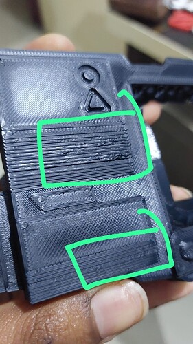

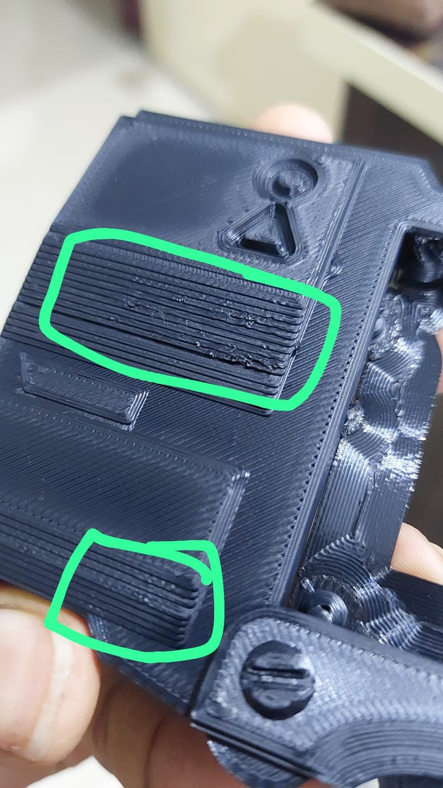

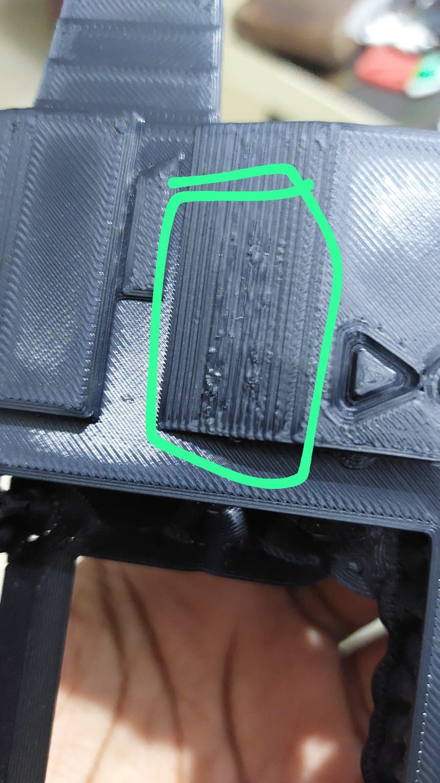

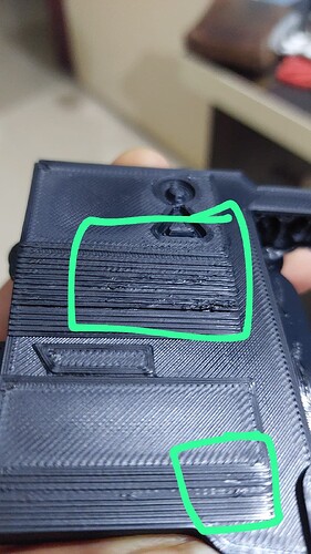

Defect on step like walls on A1
I am getting this weird issue when printer prints in steps upwards. similar thing happens when im printing a helmet. The nozzle also scrapes the weird extrusion at the marked parts . i can hear it while printing.

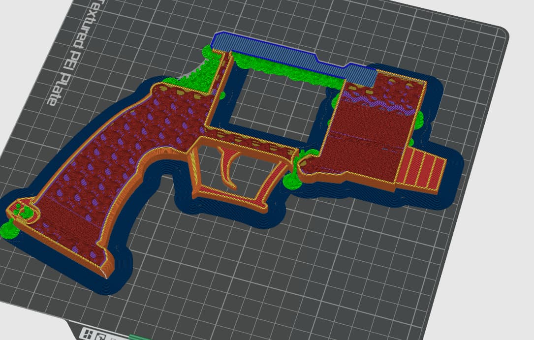

settings :
Filament : PLA ( wol3d pla )
temp : 220/65 c
speed : 200/300 inner/outer, ( slow on overhangs 50, 30, 10, 5 )
I have dynamic flow calibration on
nozzle : 0.4
layer height 0.2
top layers : 6
bottom layers : 3
infill: gyroid 10%
wall loops : 3 , inner/outer
Please do help me find the mistake in my settings

Looks like edge curling. Try out the adaptive layer height and of course make sure the filament is dry.
10% infill with that much of an interior overhang will probably struggle and you will have artifacts as you have shown.
Up the infill percentage to the whole model or use a modifier in that area.
hello, correct me if i am wrong, The modifier should increase the infill in that certain area correct?
Correct.
Here is the link to the wiki regarding using modifiers. There is a section about using them for different infills.

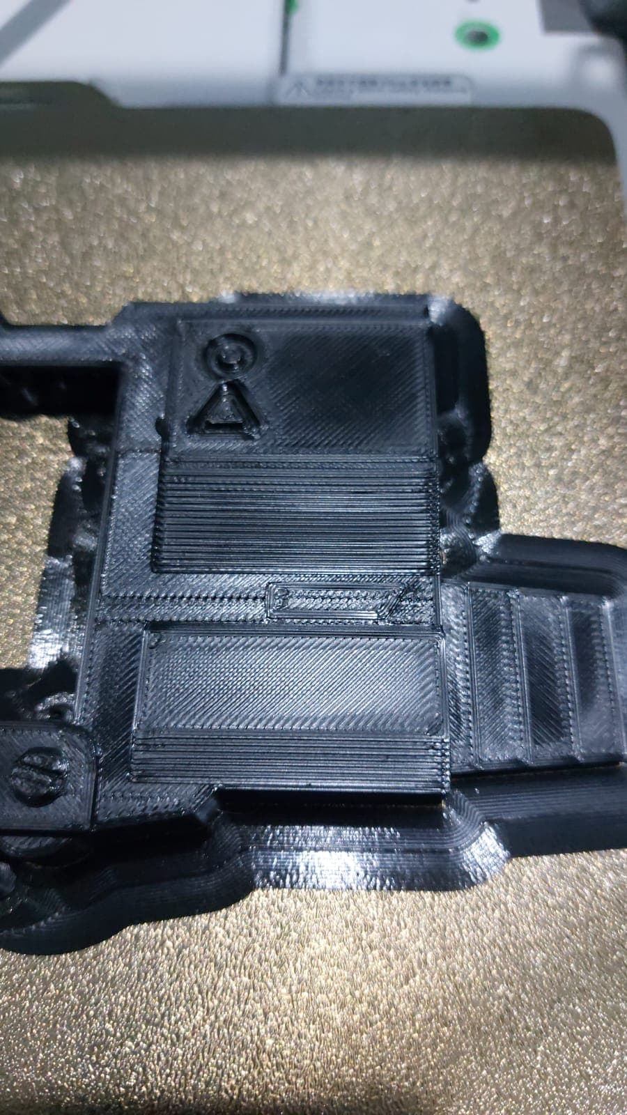

thank you, i have set the print again with outer/inner instead of inner/outer thinking it might help. if not i will put this modifier and report in a few hours
outer/inner helped but only slightly. after adding modifier below it for 40% infill it is solved completely !
