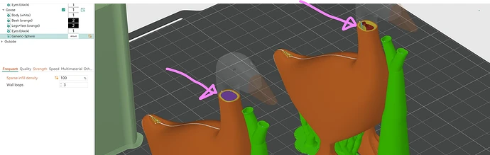

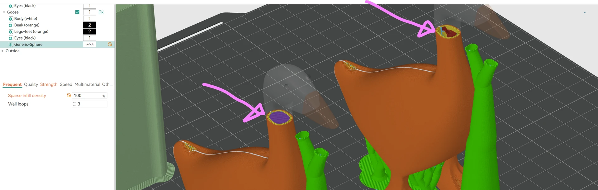

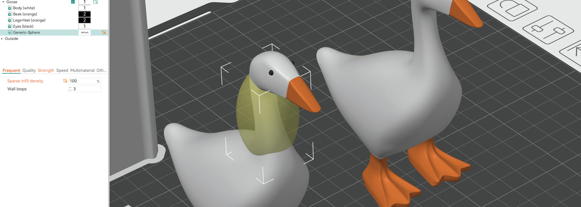

Here’s a goose with a solidified neck, as a silly example.
edit 2/ protip: this can be used for adding/subtracting mass to locations of infill to correct center of gravity.

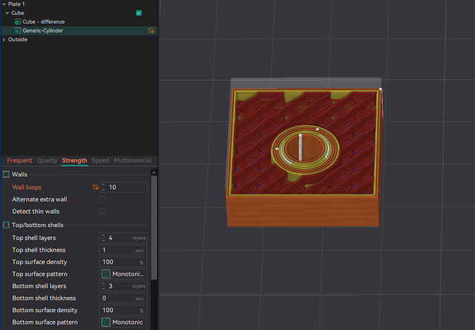

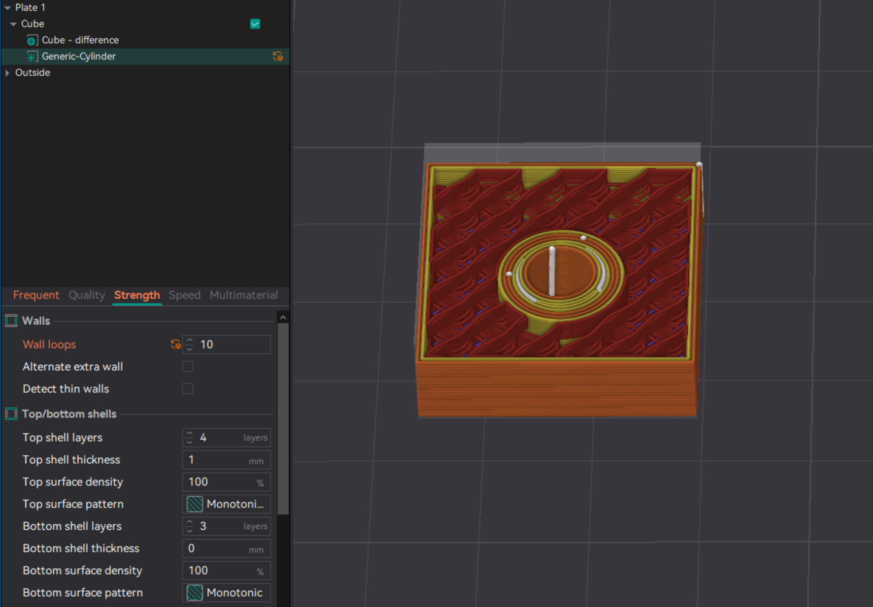

I do this all the time when creating holes for use with nut and bolt fasteners and I want the surrounding area to be more robust. As @bullocks stated above, you can use modifiers. Of course the limitation with repeating walls is that this will only work in the z Axis. Here’s how I do it.

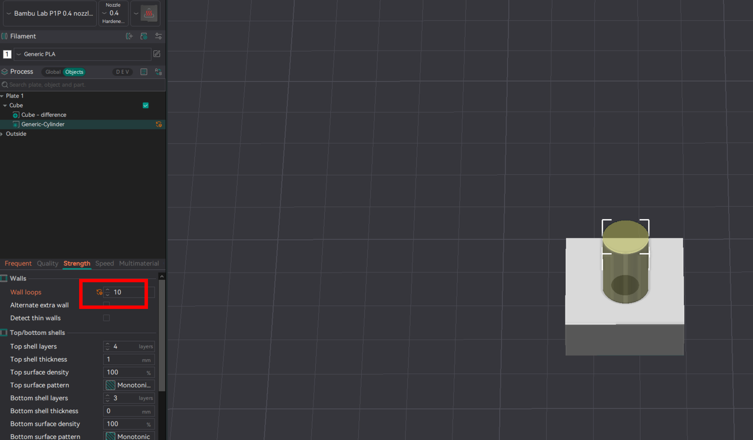

Let’s take this example of a simple cube with a hole. I use a cylinder modifier and select the object and increase the wall count.

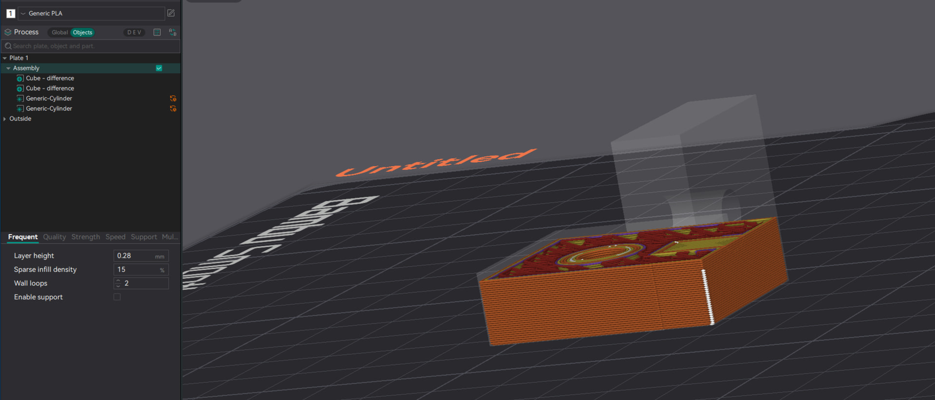

Now let’s say I want to do it in the Y or X axis, as if I had to reinforce an angle bracket.
In that case, All I do there is make the modifier in the Z-axis on one object, then rotate it on it’s side and make the next modified in the Z-Axis. Then if need be, once the entire assembly has reinforced walls, I can then rotate it any way I like.
