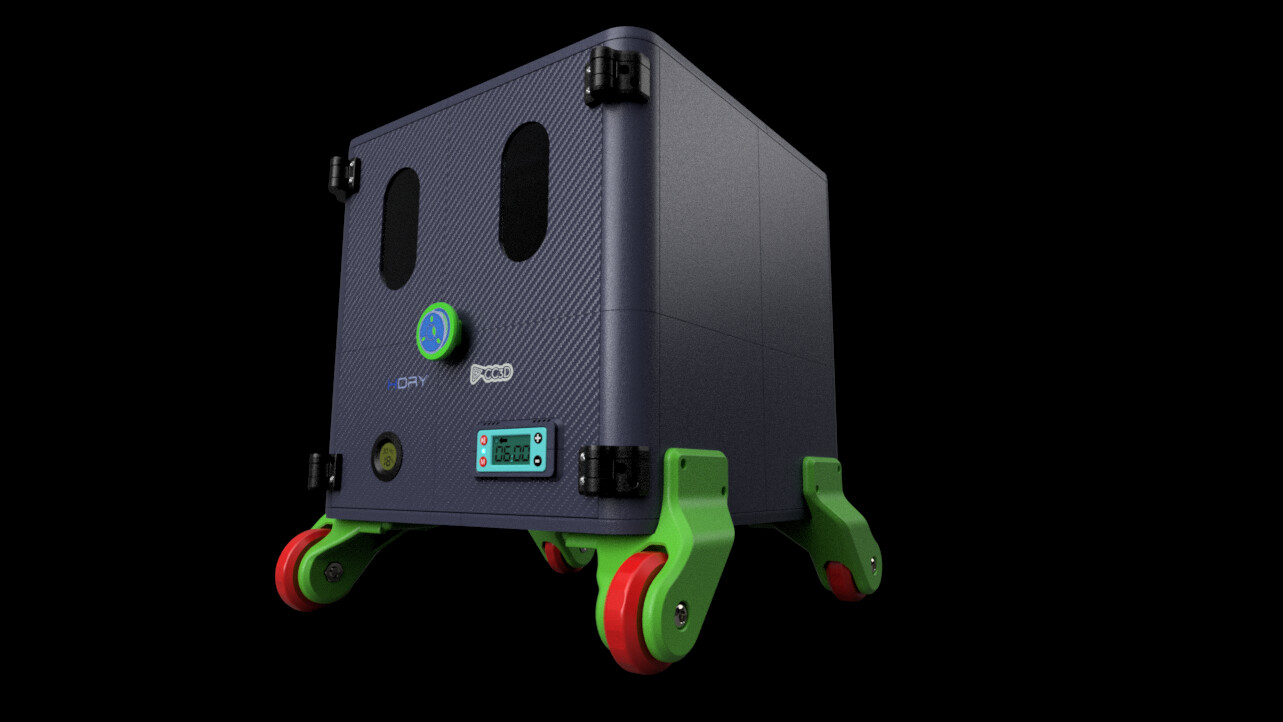

3d printable filament cabinet, with dehumifidier.
That is an interesting model. The full PolyDryers are a bit of a question though. I wasn’t able to find how far the PolyDryer itself alone can lower humidity. They have you pour silica gel beads into the box that holds the hygrometer used to tell humidity in the box and show photos with the hygrometer pegged at 10%. Dry silica gel will do that with or without the PolyDryer.
CC3D’s dry boxes might not use silica gel because the humidity graph they show never gets that low - 16% is as low as documented in that graph with 20% or slightly more looking like an average. It’s interesting that the dry box humidity follows the room humidity which implies leaks or that the PolyDryer performance might be marginal for that size of box/chamber and doesn’t perform that well when ambient humidity is high. The humidity in the dry box can apparently hit 30% though (from his graph), and might be a trouble spot, but it does seem to reduce humidity about 30% RH below ambient
But filament only needs to be dry enough to print well. Both could be benefits depending on the local environment.
