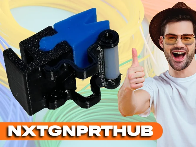

4. X1 Carbon nozzle wiper: missed upgrade opportunity
On the X1 Carbon (which at least seems harder to get new now), the original nozzle wiper / purge area is another case where a small engineering effort could have made a big difference.
Without changing the existing purge block design, Bambu Lab could have released a simple add-on or upgrade kit that drastically improves how the nozzle is wiped and how purge waste is handled. That was the very first modification I did to my X1C, and since then it has not dumped purge junk onto the build plate at all.
This could have been:
  • A low-cost printed or injection-moulded upgrade,
  • Sold as an official “improvement kit” for existing owners,
  • And used as a positive example of Bambu Lab listening to real-world feedback.
Instead, users have been left to solve it themselves.

Could you share your solution to item 4 x1c wiper. I’ve been trying different versions but I still get poop everywhere
I use this, and it has completely eliminated any residue on the build plate.
Apparently, someone has even improved Sven’s original design as well:
